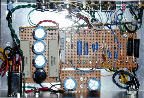

Here is the inside.
One the left is the main PS section. It is a CLCRCRC filter. The choke is mounted on top. That feeds both the large power resistor on the main board (which drops the 350VDC to 250VDC for the output section) and the decoupling filter at the bottom which supplies the preamp section.
I used perfboard and some insulated turret style terminals to create the main circuit board. I thought that with the long wires running from the terminals then under the board to the tube sockets and from the terminals to the tone controls would invite noise but the amp is really amazingly quiet.

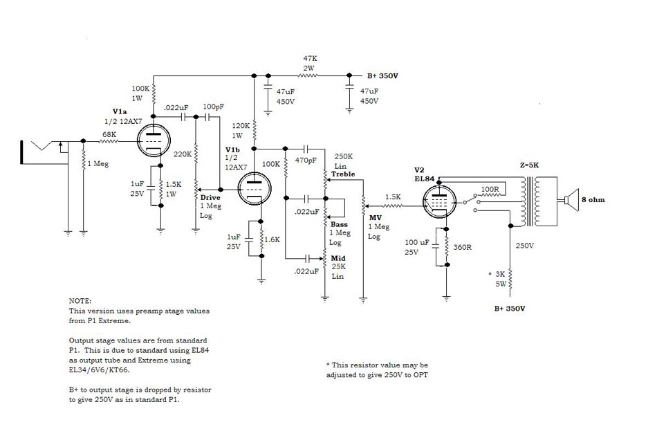

I'm attaching the schematic I used.
The original 2 circuits can be found on http://www.ax84.com. The output section is pure P1, while the preamp is pure P1 Extreme.
The cost should be under $115, including the caps and resistors if you shop carefully or use the stuff you have around.

A neat job, well done. BTW, where is the clean/dirty switch in your schematic? I can only see the triode/UL/pentode sw.

Good question about the switch! I saw a schematic with a clean/dirty switch and added it to the amp but didn't add it to my schematic. I also noticed another small error. Both cathode resistors on the 12AX7 are 1K5, not one 1K5 and one 1K6 (not that there is any practical difference).
The clean/dirty switch goes in like this-
Tie in one end of a 1K resistor between the cathode of V2 and the 1K5 cathode resistor. Tie the other end to a SPST switch so it can be switched to ground. When the switch is in 'dirty' postion it parallels the two resistors to ground.
I think there is a diagram on the AX84 site somewhere that shows it in pictoral form.

One other thing isn't shown correctly on the schematic because I didn't have a 3 position rotary switch that would fit. That is the pentode/ultralinear/triode switch. I just went with a pentode/ultralinear switch using a submini SPDT. And if I were to build this again I don't think I would bother putting it in, I'd just wire it pentode.
