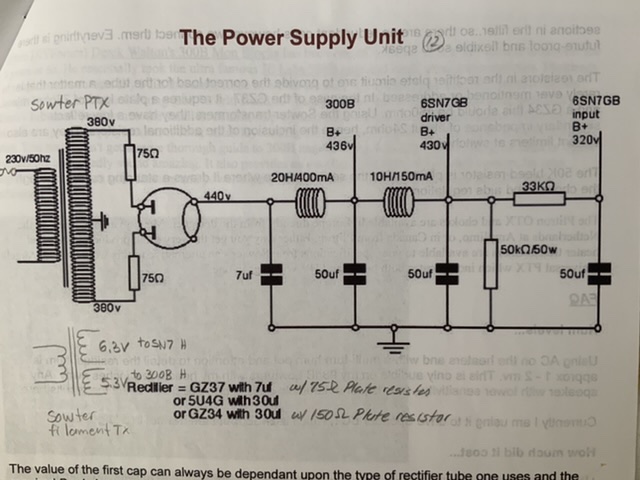

I don’t know who makes a 20H, 200mA choke. My question is what does the circuit warrant. I’ll post a photo of the schematic soon...
Here’s the schematic and power supply for the 300B MkII.

Thank you for posting the schematic. Sorry about some of the responders sounding harsh. I can provide some information, hopefully helpful.
1. Menno van der Veen, the designer of the PAT 3035 SE transformer, still sells them from his Bureau in the Netherlands. See:
Single-Ended : VDV-3035-SE (PAT-3035-SE)
2. Electra-Print does very good work. The aforementioned amorphous core transformers (Lundahl, ISO/Tango, Tribute and others) will probably exceed the performance of the PAT3035, if money is no object. Silver coils?
3. A 250 ma choke will be close, and I would look for a 300ma, or separate the supply for each channel. Each 300B will be limited by the current it could safely pass (<100 ma, at your supply voltage), plus some for the front-end (allow 40 ma). So, 240 ma is likely to be the minimum I will want to use.
4. A previous post stated that the Walton 300B design might not justify the use of very best in transformers. I do not have an opinion, but it is something to contemplate. You have the “inexpensive parts” for the Walton design, but you real investment would be in the magnetics, so why not look around for a top design.

You can get the output transformers fra Menn VDV as Francois says, and the power transformer you have at Edcor or have one made.
You should calculate how much power the entire amp draws, and get the 20H choke you need. 400mA is overkill. The rectifier can not deliver more than 250mA anyway, so probably 200mA would be enough, but best you make the math.
The 10H for the 6sn7 tubes could also be lower than 150 mA.
Another thing is that it seems that the output tubes is AC heated. You will probably have some hum, so you should make room in the cabinet for future conversion to DC heating.

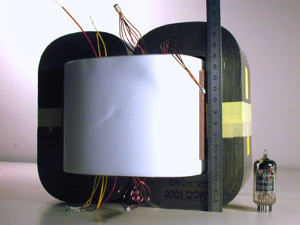

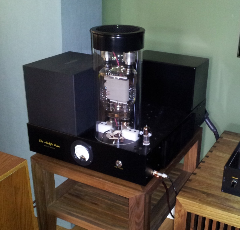

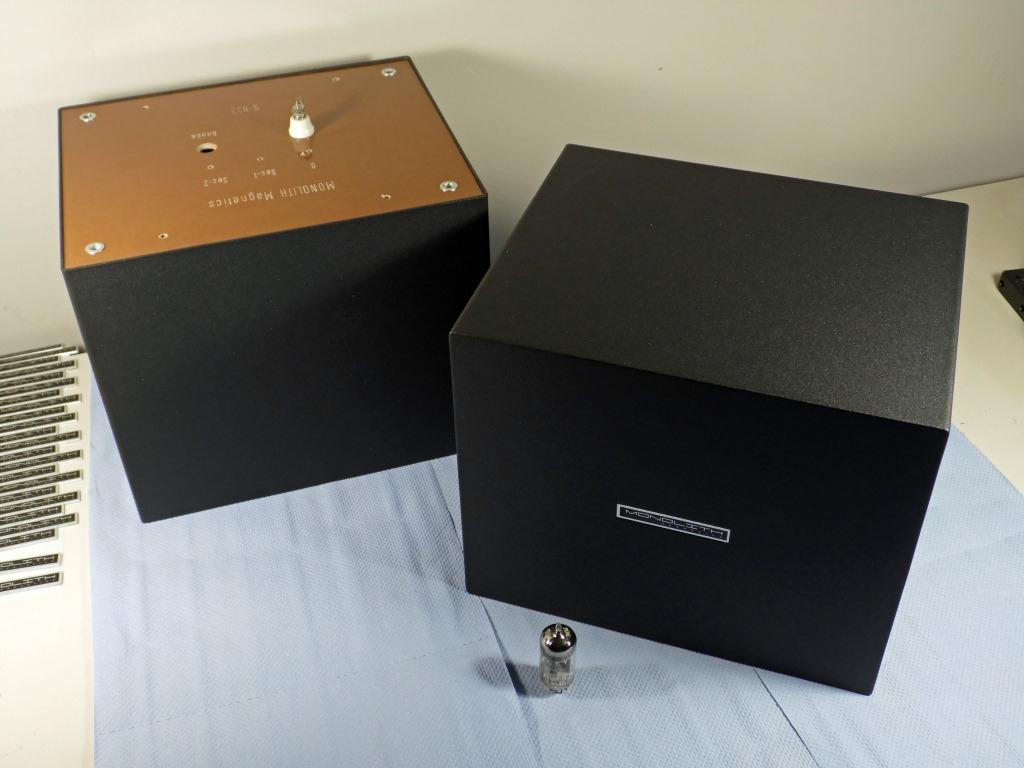

Monolith makes very fine iron, indeed. My 833C amps have 60lb outputs and high-voltage chokes from Monolith and sound very good indeed.
Attached are a couple shots sent from Monolith as they were building the OPTs, and a shot of one completed mono amp.
The first stage eats 3.5 mA. The second stage eats 5 mA. A 300B should not be run much harder than 100 mA. so 110 mA per channel should do fine. A TRUE 250 mA choke should be good. As would the bigger 3,000 ohm Toroidy OPT's. I am currently stuffing 30+ watts through the big 1.5 K ohm Toroidys and they sound pretty nice. There is some saturation in the low bass, but you aren't going to get 30 watts from a 300B.
Total draw is under 20 mA. a 50 to 100 mA choke would be fine.
