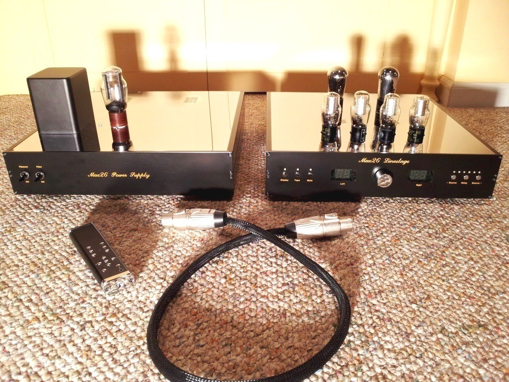

My favorite preamp tube is the UX-201A. They are in my DIY preamp, which I built with 26s but switched to 01As. IMO, the ideal way to power the filaments is with Rod Coleman regulators, they sound fantastic and provide a soft start for the filaments as well. Lots of threads about them here on DIYAudio.
In terms of sound, my favorites are the RCA UX-201A which IMO have a slightly more euphonic sound than the Cunningham CX-301A. I know they are supposed to be the same tube but I do consistently hear differences (not blinded, though).
