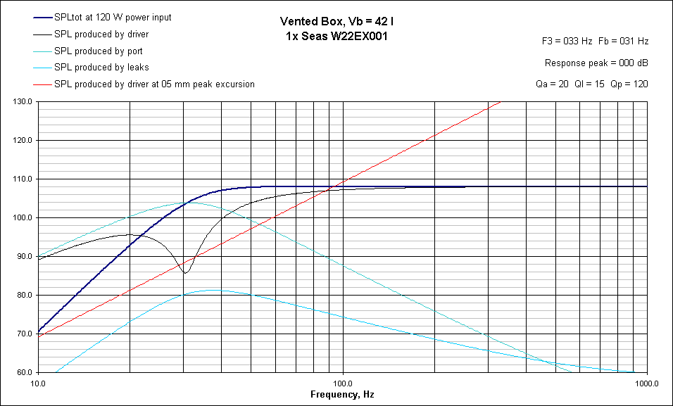

I got the specs for your woofer from seas web site and modeled it in unibox. It's not too far off the mark, graph attached.
In the next post I will show what will happen if you shorten the port to 180mm :)
Tony.

here is what happens when you reduce the port length to 180mm
note that the response peak goes up by another db.
Two things I can think of that may be giving you problems.
1. The close proximity to the rear of the driver of one of your braces. you may be getting reflections off it messing up the sound.
2. This is a rear ported design, if you have it too close to the wall you may be getting a bass boost. This may not be just because of the rear port, the speaker may have baffle step compensation in the crossover, and if so and you place it too close to the wall the compensation may be too much.
Tony.

Well I'm only going off the modelling program but I think it is the other way around, shortening the port increases the box resonant frequency.....
I did a simulation in speaker workshop (quasi butterworth) to see what it thought was the best cabinet volume, it came in at about 50L (one of the things I don't like about unibox, is it won't necessarily recommend a good starting point).
Anyway I modeled it in unibox with at 50L and it looks a little better than 42L so if anything your box is a little smaller than optimal, reducing it further will not help IMO.... if you change the volume you will need to further change the port tuning as well, and will probably end up with a slightly higher F3.
here is the graph.
Tony.

This one is a 42L box with 247mm port.
One other thing... are you only covering the sides and back of the enclosure?? Bass reflex normally aren't stuffed.
Also the modelled response using your volume of 42L and port diameter and length only has a response peak of about 1db, so I don't think that tuning of the box is the culprit as a 1db hump at the bottom end I don't think would be particularly noticable, and if anything should be making the lower bass stronger not weaker.
I'd try moving the speakers around the room a bit and see how they sound, try putting them at least 4 feet out from any wall. If you have them in a corner then you could be getting a big boost of certain bass frequencies (Others know much more about this than me)....
the only other thing I can think of is that maybe you have leaks in your cabinet, but I think they would have to be pretty severe to cause your problem..... can you run an impedance curve of the driver in the cabinet, that will allow you to work out what freq the box is actually tuned at.
Tony.
