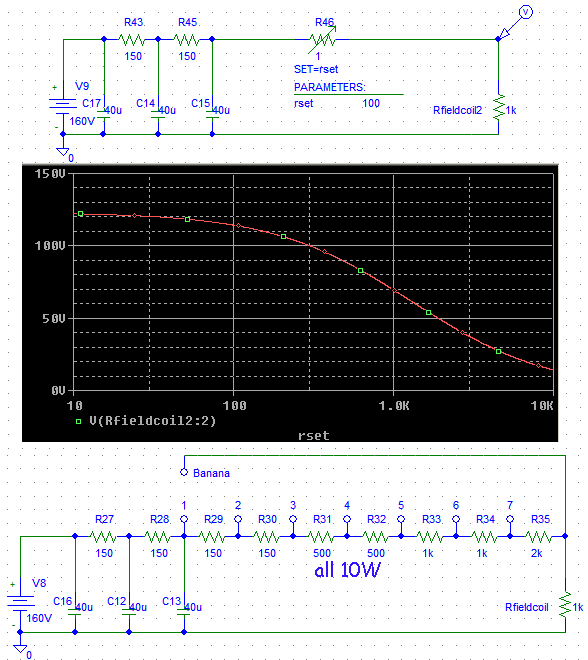

It is an old-school technology and I like old-school solutions. NOT Selenium!! wall:120VAC 25VA transformer (for each speaker). 400V 1A bridge rectifier. C-R-C-R-C filter appears to be plenty clean (cleaner than anything in the 1930s). Then series resistance to adjust the coil excitation. While pass-transistors and switchers are "more modern", there's nothing wrong with a box of hot resistors.
120VAC winding to 40u-150r-40u-150r-40u filter, then series resistor to FC. We won't need a "to zero" range, and probably not even down to 33% voltage, because sound falls off as fast as the field does. Because of filter un-sag we may want 3k series; ah, let's go past 5k to be sure.
A knob-pot would be best. But this wants a reverse-taper 10+W-rated pot which is not a common thing.
Rotary switch is obvious but most available parts are 50V 50mA and we need more than twice that rating. And the inductance of the coil will burn-up small switch contacts if switched "live". Dunno what the best plan is. I might mock-up a banana plug on a lead and a bunch of banana jacks in a child-resistant box.
