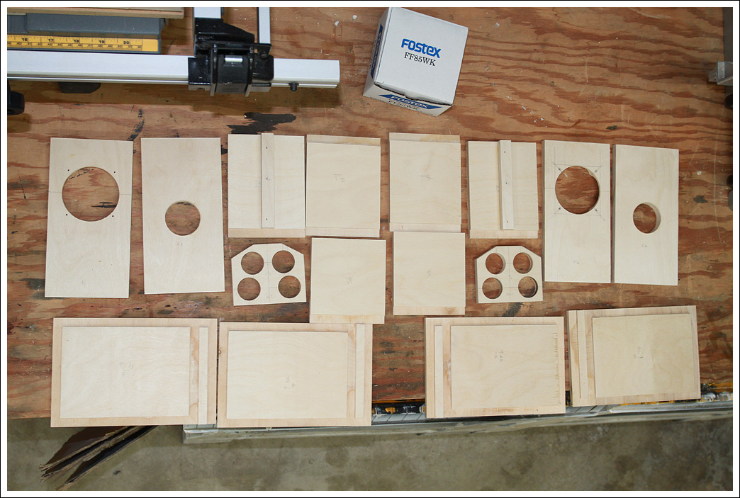

Here are some more pictures.

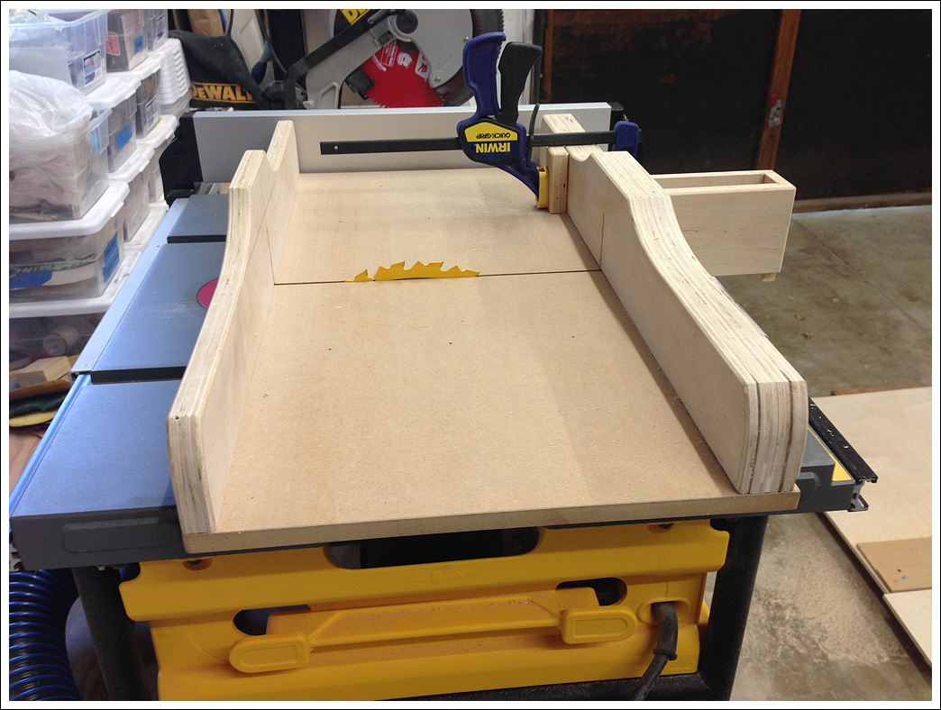

Using a stop block on the table saw sled to cut the sides to length.
This blade is a bit dull so I got a bit of tearout and some saw kerf marks, but I'm going to be veneering the speakers so it doesn't matter.

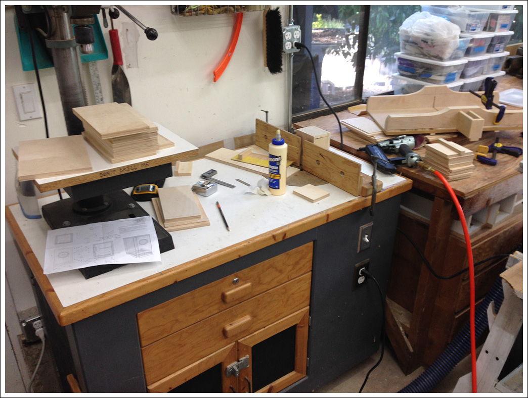

Jig used to position the rib in the center of the vents

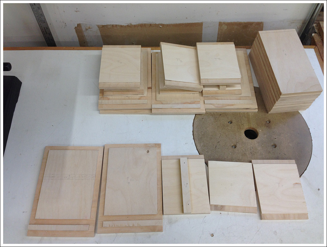

Making a mess.

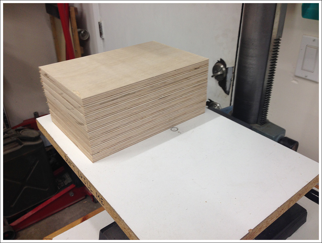

Building 4 enclosures results in a lot of small parts.

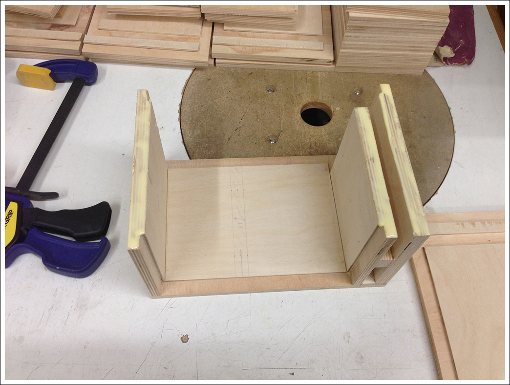

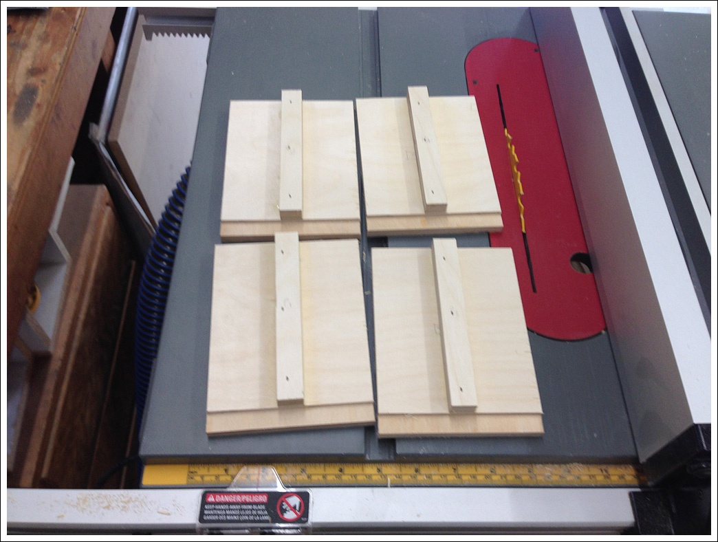

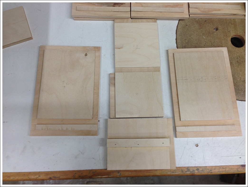

I cut of dados and rabbits on the side panels to ease assembly and to make sure things are airtight. The arbor on my table saw is too short to support a 1/2" dado stack, so these were all cut on the router table.

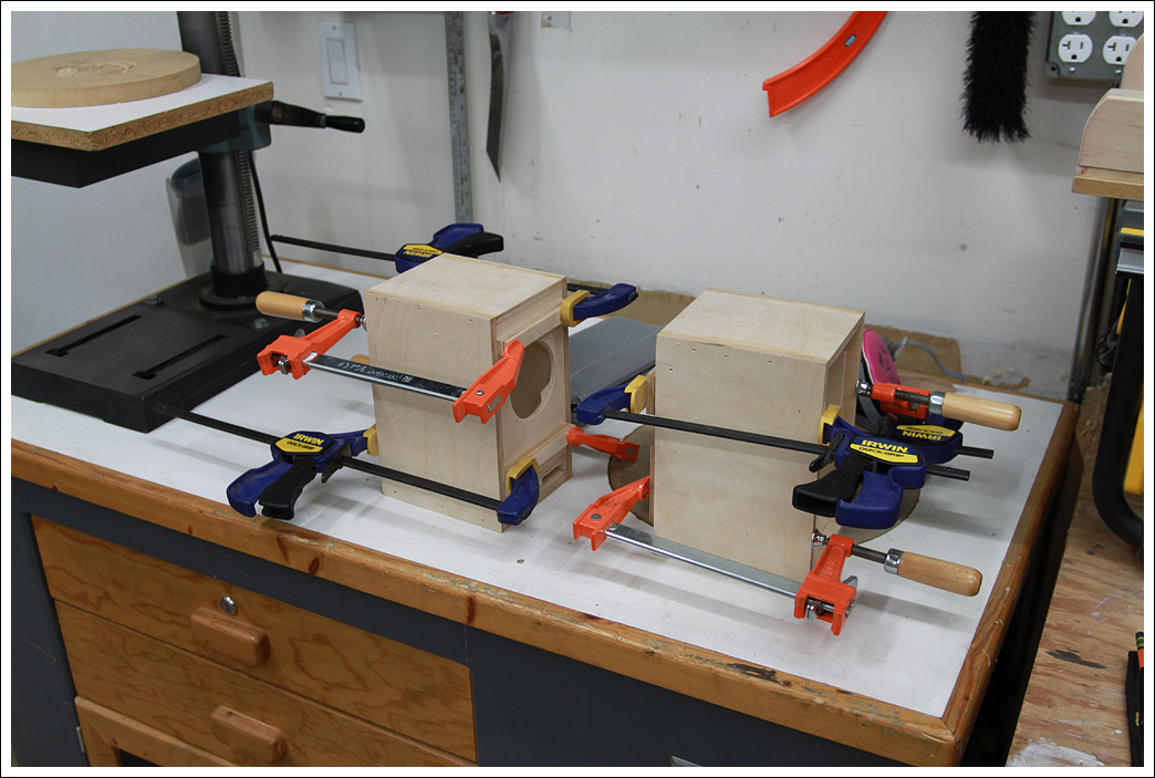

Starting the glue up. I ran the dados for the vent shelf all the way through the piece so that I could use the same setup for all 8 panels. This leaves a small (1/2x1/2x1/8) void on each side which I guess could theoretically effect the vent size on a speaker this small. I might fill them in at some point.

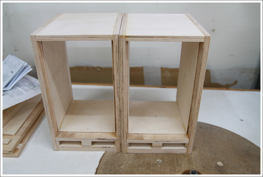

On pair glued together. I used some 18g brads to hold things together while the glue dried, and the front panels are in place to help hold things square.

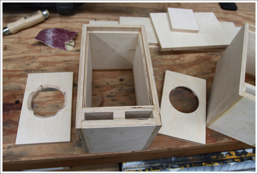

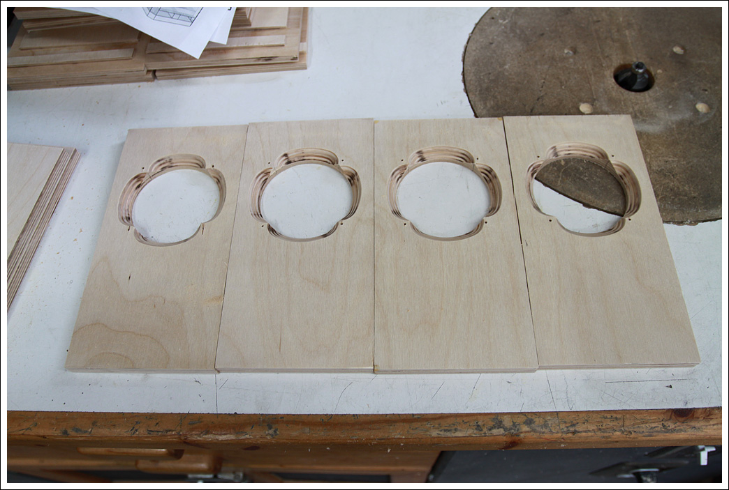

Scallops on the backside of the driver holes.
I went back and forth about the order in which to do the glue up, and ultimately decided to leave the front and back panels for last.
… This leaves a small (1/2x1/2x1/8) void on each side which I guess could theoretically effect the vent size on a speaker this small. I might fill them in at some point.
I wouldn't worry about it.

I had used a 73mm hole saw to cut out the driver openings. Fostex's paperwork says a 73mm hole, the uFonken plans say 71mm. I went with 73mm because I could get a hole saw in that size. This turns out to be a little loose, so 71mm would probably be a more exact fit.

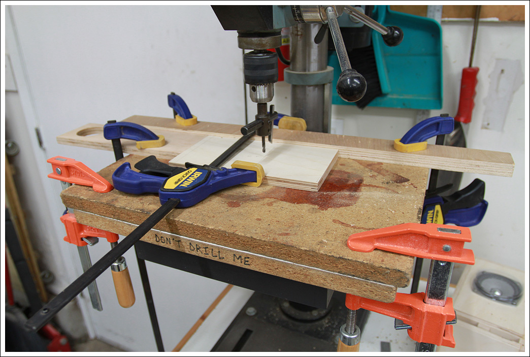

I didn't have a hole saw the right size for the speaker terminals I purchased, so I had to use a fly cutter. I have injured myself with this seemingly innocuous tool several times, so as you can see in the picture I don't joke around with clamping down the work piece. The problem with the fly cutter is that you can't see the outside arm when it is spinning, and it is really easy to have it hit your finger, or for it to seize the work piece and whack you with it. Use with caution.

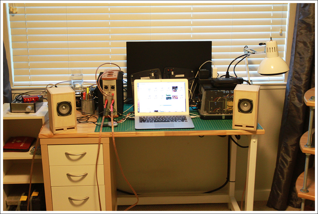

And the temporarily assembled speakers hooked up so I could see what they sound like. The clutter on the desk consists of a Mac playing lossless audio files over USB into a Behringer UA222, which outputs over optical into a MiniDIGI/MiniDSP combination (silver box on the far left). This then feeds into a Pass Mini-Aleph that puts out a massive ~10w of class A power. The MiniDSP is only being used for D/A conversion for now, in the future I'll use it to try out some BSC options.

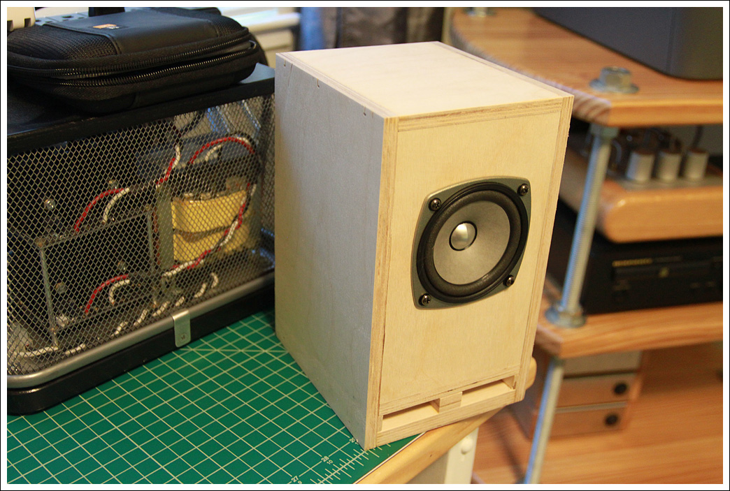

Here is a closeup of a uFonken. They are a great size for desktop speakers, and I'm really glad I went with these over something larger using my EL70s. I haven't yet decided if I want to bevel the edges or not. The bevel would only be about 5/8" wide so I'm not sure how much it would help with edge diffraction, and it would make veneering more difficult. If anybody has an opinion on this let me know. In the background you can see part of the power supply for the Mini-A.
That's it for now. These were a lot of fun to build, even with the extra effort required to cut all the dados. I'd like to give a big thanks to the gentlemen at Planet 10 for making the uFonken plans available.
