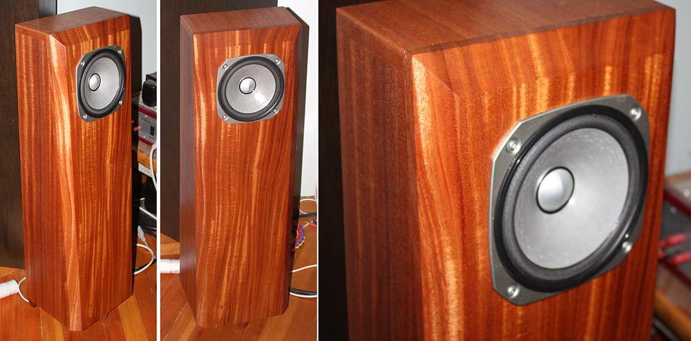

If you find the Frugel-Horn XL is too large, we have done a Compact FloorStander (CFS) for the FF165wk. Performance is not as good as the FHXL but it is considerably smaller than the FHXL.
These done with 1.5" solid (mahogany?) front baffle and vent out the bottom.
dave
dave
yup, looks like Mahogany / Sapele to me - that 1.5" front baffle will have some pretty serious chamfering on the inside of driver hole
gorgeous work as always by Bernie

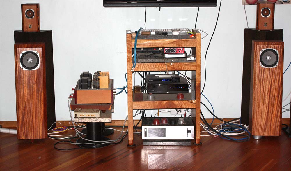

for an idea of relative sizes, these happen to be with Alpair drivers, but the enclosure dimensions are essentially the same as would be with Fostex.
From front to back - CFS for A10P, FH3 with Alpair MAOP7, and FHXL with A10.3

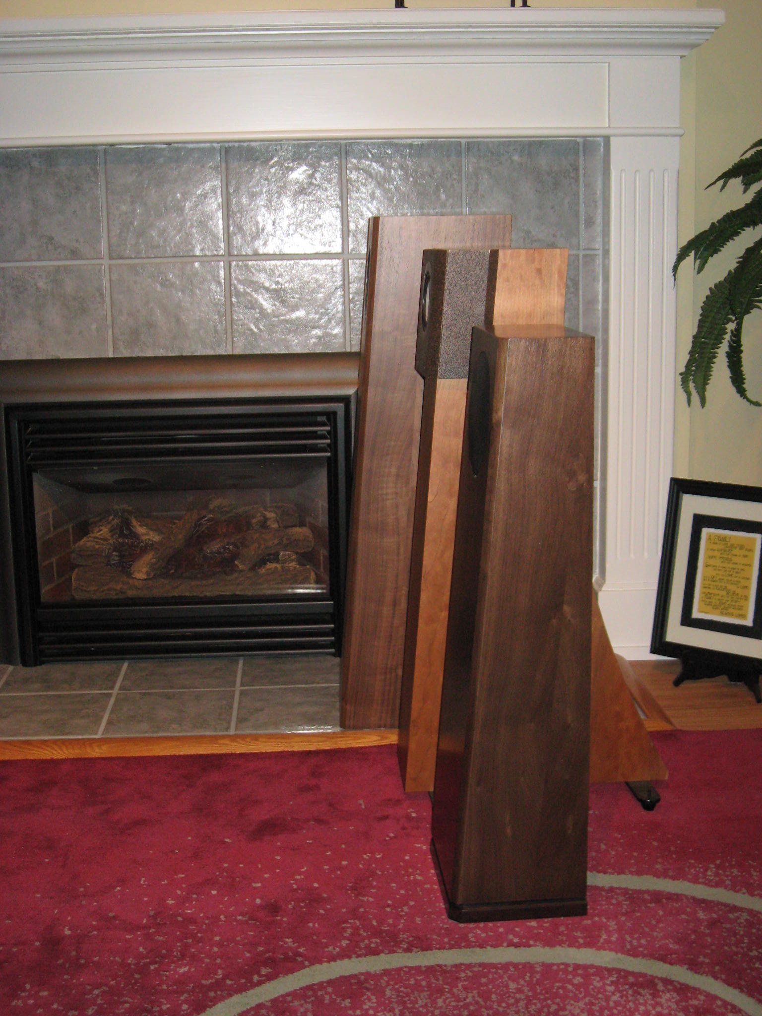

OK, here's my entry:
Bob
Bob
Elliptical baffle and radiused front edges are optional, I think?
All true. Only the insides are sacrosanct.
Bob
