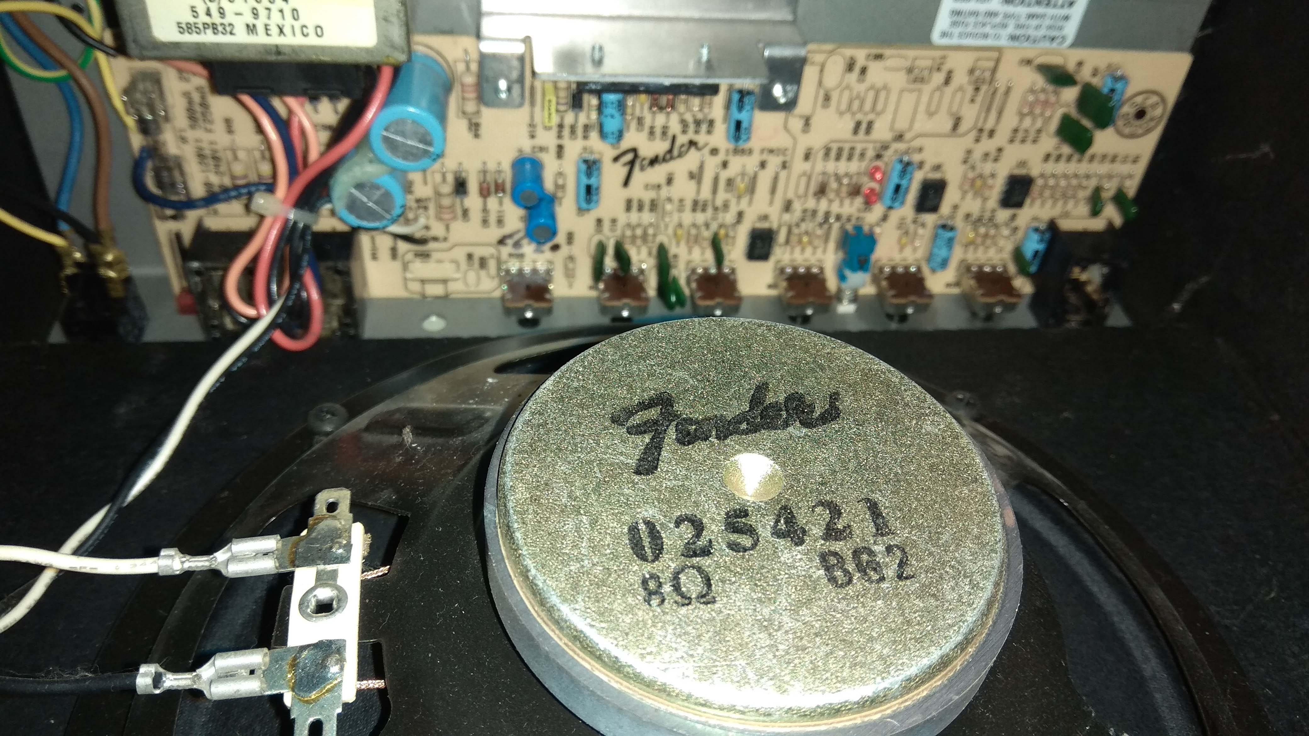

The above mentioned guitar amp was given to me for free. It is an old practice amp made by Fender in Mexico. Says type PR 241 on the sticker on the back and Frontman Amp on the front panel. It consumes 38 Watt and has an 8Ohm loudspeaker, so i suppose it outputs about 15 Watt RMS @8Ohm.
I am trying to repair it (see below), so i can plug an 1x12" cabinet with a speaker like Jensen C12Q or Celestion Vintage 30. If it works OK, i am planning to throw away the factory 8" speaker and cut the amp in half so after modifying it, it will look like an amp head
The problem: amp turns on OK, it switches normally between clean and overdrive channel (i can hear the hum noise in OD) but it "screams" (see below) and outputs no audio from the guitar.
When i plug a jack cable in the input, regardless of the guitar being connected or not, when volume is on zero it is quiet, but after trying to set volume at 1 or more then it starts sounding a high-pitched, constant, clear and very loud sound/noise (like a squeal or whine). It is so loud that my head buzzes and my my ears hurt even after i turn it of. My dog gets very stressed from this noise/sound. The sound changes pitch with treble equalizer knob, but other than that it is always stable on max db not dependent on the volume setting, and stops when i set volume to zero (volume/gain in OD mode) or unplug the input jack. With the guitar connected or not, it does the same thing whenever i have a jack plugged in the input of the amp. It does not change if i ground or short circuit the contacts on the other end of the cable, or if i connect and play the guitar. Already tested different good cables and guitars.
Any ideas?
Where should i start from for troubleshooting?
I have a (good) multimeter and some basic skills on desoldering and soldering. I know Physics well too, but i have little practical electronic repair skills.
Also, if anyone could send me any schematics of the board, i would be grateful.
If you need more photos of the amp or the circuit board, just ask for them and i will upload.

All kinds of things can make all kinds of symptoms. I suggest following advice in order given as it is more likely than something esoteric.
The schematic I attached is REALLY close to your unit.
Extra pins on jacks? SOme may be unused, others are cutout contacts that do jobs like ground the tip when jack is empty. Others may be involved with muting circuits. All depends upon the amp.
SOLVED PROB! Schematics still needed to add FX loop send-receive and reverb circuit.
I was very lucky, easiest fix ever!
I now need info and ideas for modding the PCB to add FX loop and/or a reverb circuit (read after the fixing procedure).
How it was fixed: After your ideas i started disassembling the actual amp board from the cab.
From the bottom of the PCB all solder joints seemed OK, no visible cracks and/or cold solder joints (Mexicans did a great job while assembling it). From the top i noticed that the transparent cover of the input jack socket was missing. After checking the others i realized that this cover is just for the dust, i think it has no other functionality.
I also used my Ohm meter to check both jack sockets and i learned this way why it has 4 pins for mono signal: the 2 extra pins are for connecting signal to ground when jack is removed from socket, like an auto switch. 🙂 Also by this test i realized that the input jack socket works electrically as intended. While doing all the previous tinkering, i noticed that the pin inside the input jack socket that contacts to the tip of the jack (signal) is broken and has no contact with the jack. It had a little more of the pin left, so i just bent it upwards and it makes good contact with the tip when the jack is inserted. I double checked that it has continuity as intended and no short circuit when jack is plugged and unplugged, i temporarily connected the speaker and power cord, i wore my earplugs, sent my dog to the bottom floor and fired up the "beast". Everything is fixed! The amp works again like a charm!
Reassembled it and i am amazed by the sound and db this small amp produces. Both with closed back (factory) and open back, it produces great clean and OD tones for practicing in my room.
I am sure it will be able push a fair amount of air, when i add an adequate 1X12" 8Ohm speaker cabinet. (i plan to create a new thread when i finish building the cab and converting the combo amp to an amp head 😱)

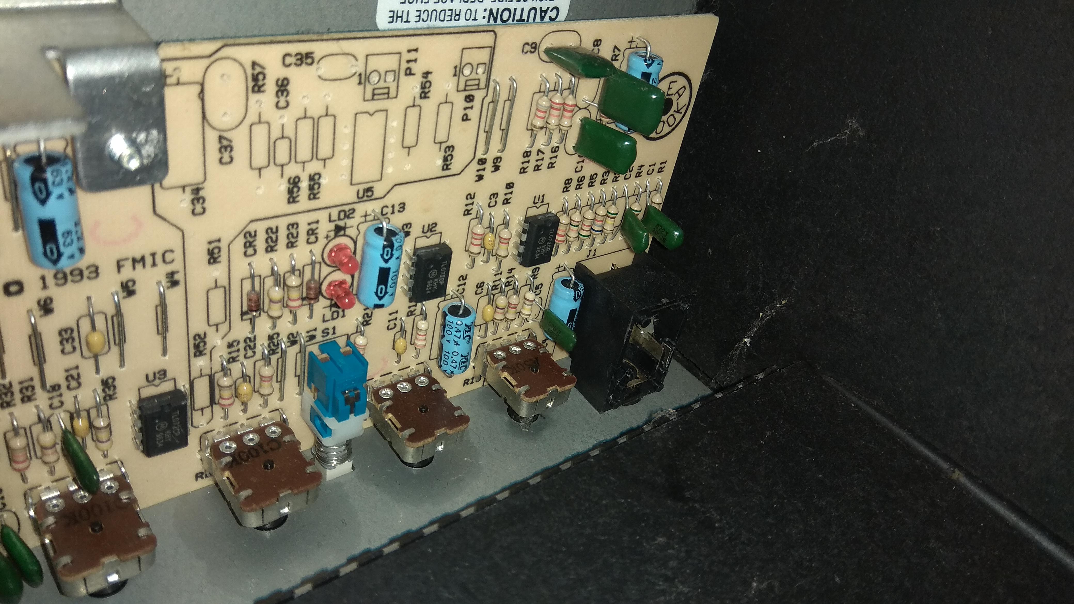

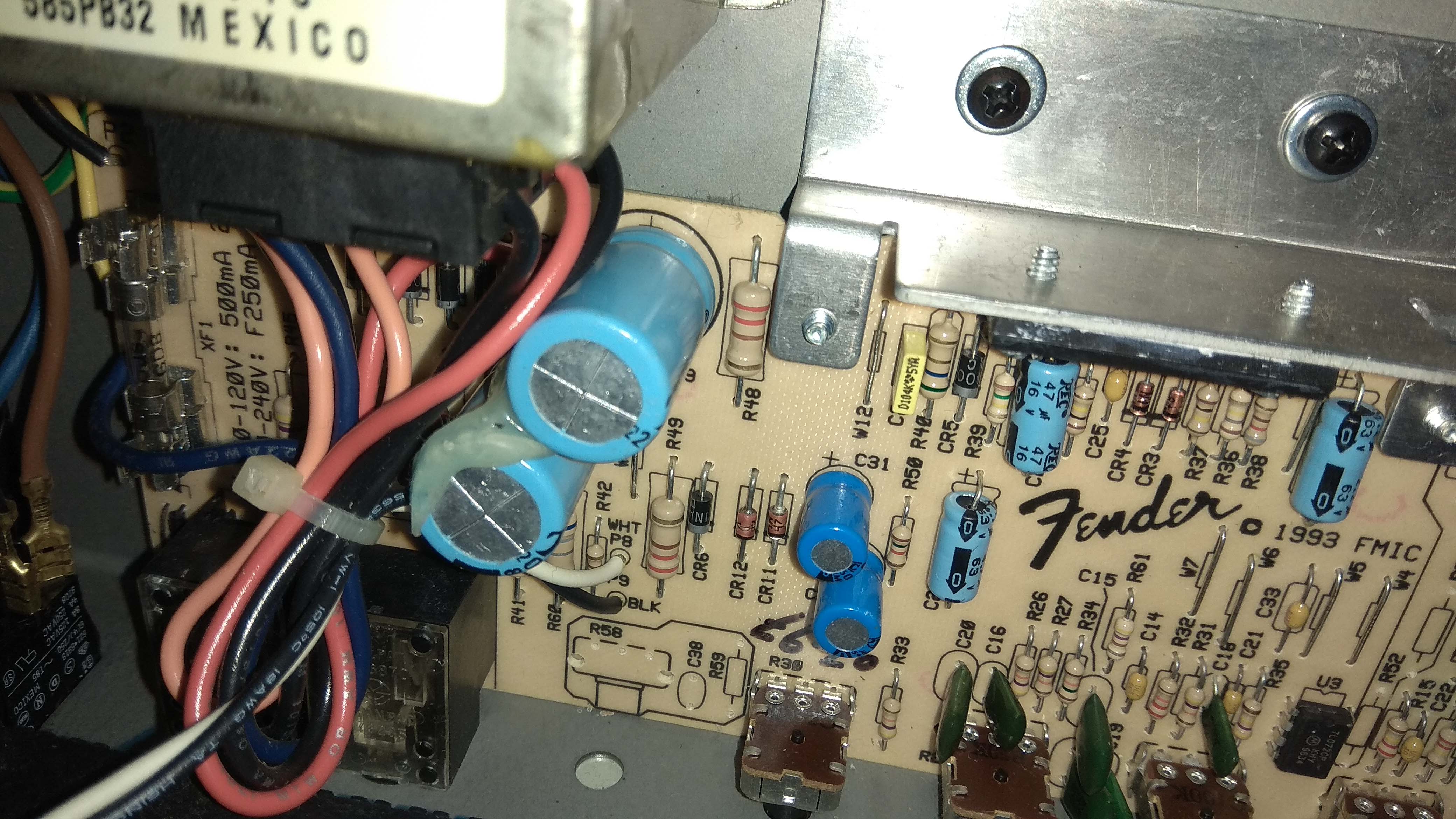

Next step, modding the PCB:
If you examine closely the last three photos, you can see clearly that there is a reverb circuit printed on the PCB but has no components on.
Is it possible to find or calculate the characteristics of the components of the reverb circuit? Is there any other similar reverb circuit available online?

Thanks to Enzo providing that manual, adding reverb looks straightforward. All you need is one double op-amp, a few passive components, and the actual spring reverb unit (the only slightly tricky part!)
