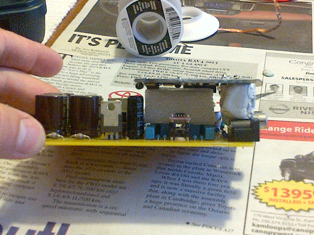

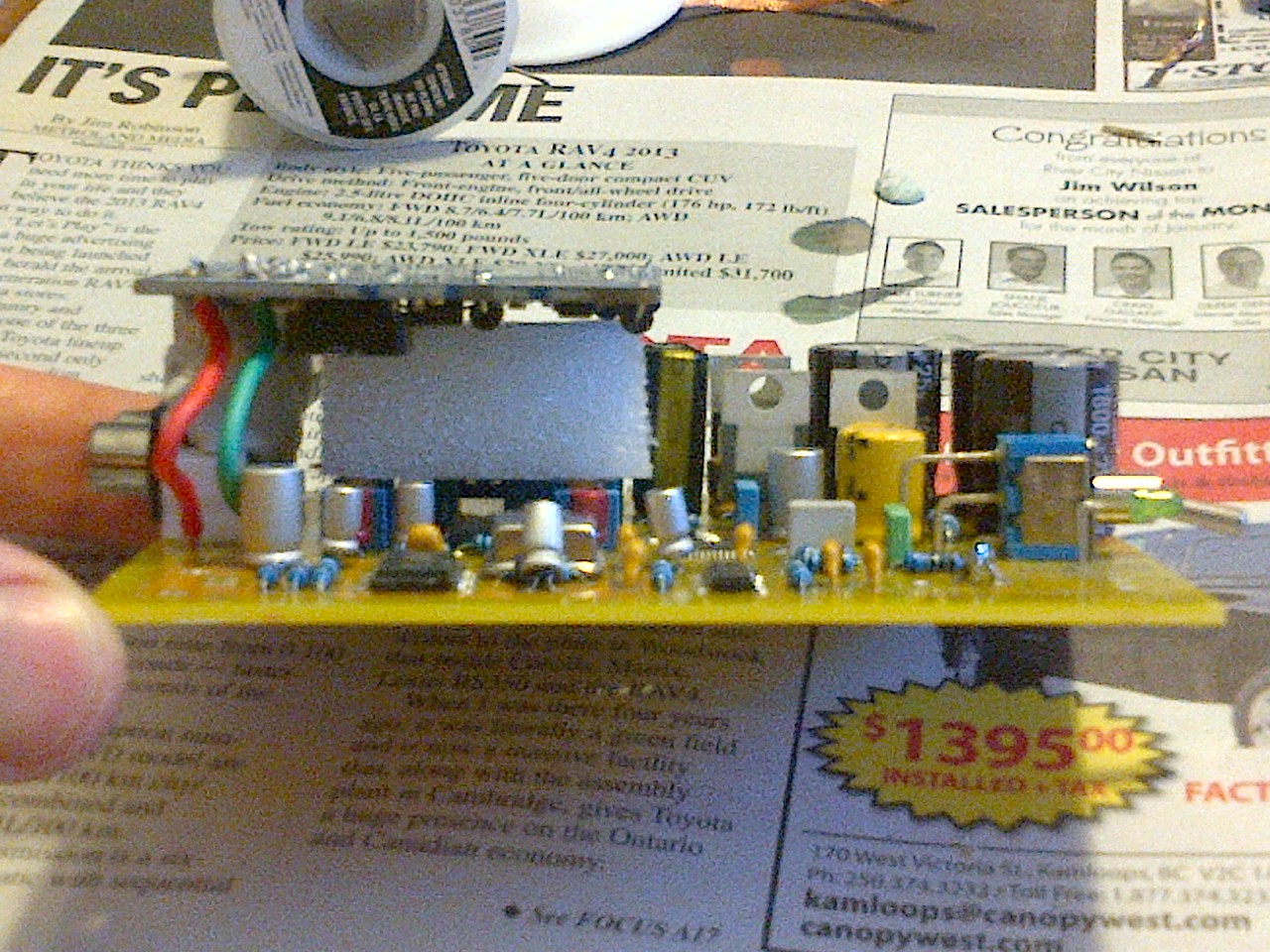

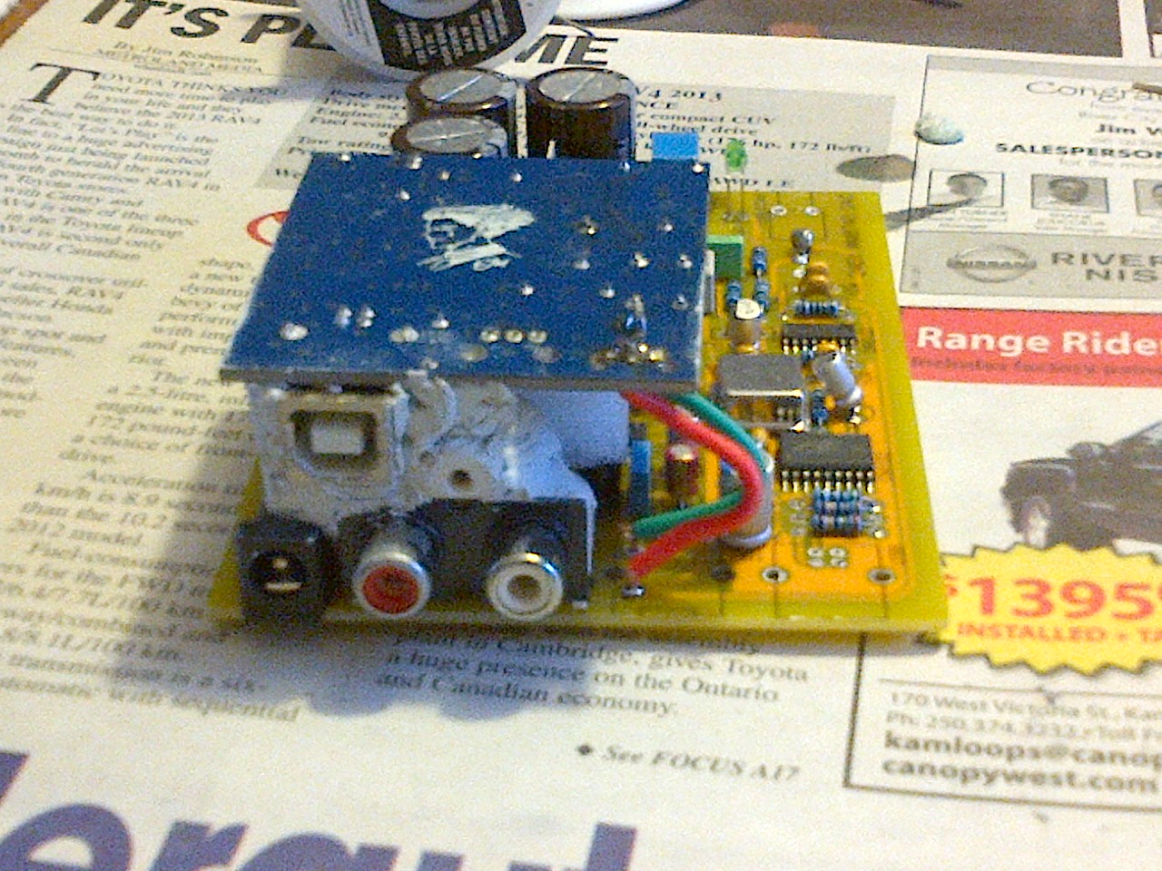

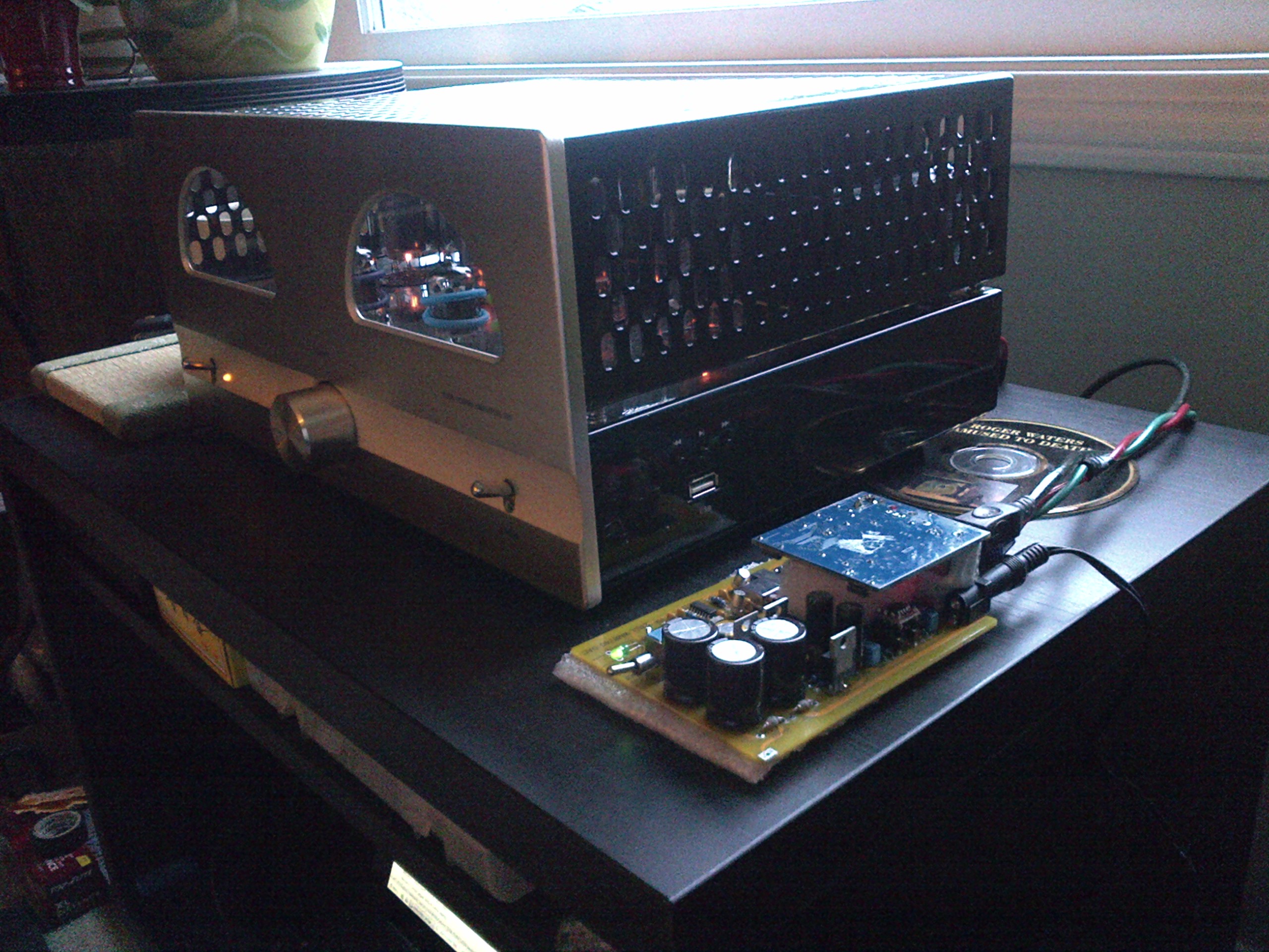

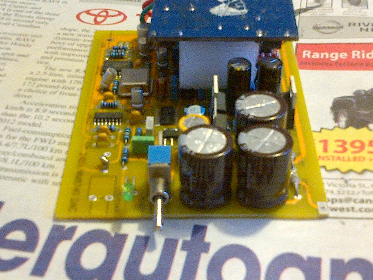

After work today I decided to integrate this WM8740 DAC board with my new CM6631A USB/SPDIF board.
I began by removing the superfluous components from both boards:
- Removed SPDIF-out RCA interface from USB/SPDIF board
- Removed SPDIF-in RCA interface from DAC board
- Removed USB interface from DAC board
- Removed USB/SPDIF selector switch from DAC board
Then I integrated the two boards:
- Bridged the appropriate pads to permanently select "SPDIF" input on the DAC board (in leu of the removed selector switch)
- Installed leads (green and red) in the DAC board coax SPDIF-in pads
- Connected other end of leads (green and red) to USB/SPDIF board coax SPDIF-out pads
- Used "Mighty Putty" to install/secure the USB/SPDIF board so the USB interface is aligned with the interfaces of the DAC board, ensuring that access to the opamp is maintained
I have ordered a project box that the whole works should fit into. If that fails then I will build a box.
Sorry about the photos, but all I had handy was my BB.
