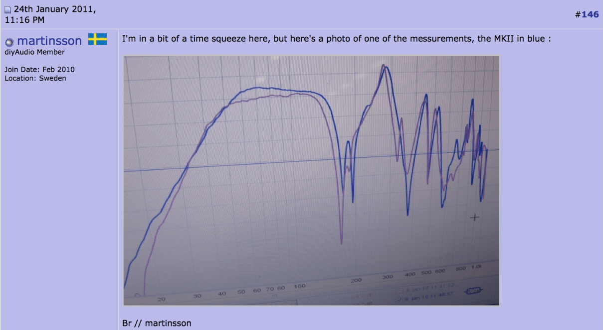

The Fane 15XS TS parameters are close enough to the B&C TBX100 that the Tham 15 tapped horn was designed around that it should work OK in that enclosure.I’d like to put these drivers in THAM15 enclosure’s and would like some real world input, I like the thams due to their size as we are limited for space and as I understand would be good for output, any input is greatly appreciated.
The Fane 15XS has less Bl (magnetic strength) than the TBX100, so the bottom may start to roll off a bit higher than 50Hz.
The Tham will give you lots of thump, but not much below it's Fb of around 45Hz.
If you want to trade more bottom end for upper output, a bass reflex tuned around 36Hz of similar size would be a good choice.

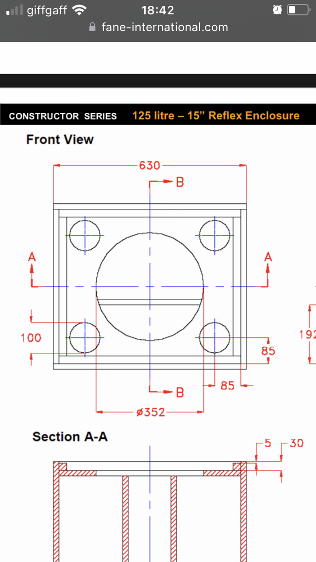

Thank you both for your excellent reply’s, Indianajo as much as I appreciate your answer it just made my head explode , Walters’s exactly what I was after, yes I understand about port size I do get a lot of port noise 4x2” ports, fane suggests 4x4” port for the 15XB so I guess that will be my first port of call, would a port length of 12” get me to 37hz I know there’s probably other variables that would effect port size for hz tuning.

This is the design from Fane it doesn’t actually say a port length only the diameter, this enclosure is for the 15XB not the 15XS they don’t list anything for the 15XS I did email them but still awaiting a response from their technical team. The idea of me building THAM15 came from speakerplans.com as the compact design fitted our needs of storage but like many things the more investigation I did the more unsure I became, my plan for now is to play with the port sizes in the Devine enclosures and hopefully I can find the sweet spot and if not then I’ll build some THAM15
https://www.yumpu.com/en/document/read/27695830/compact-125-litre-cabinet-for-1-x-15a-driver-fane
The four 100mm (4" drainpipe") cutout ports in the cabinet posted in #6 are 162mm long.
