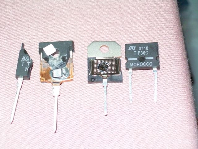

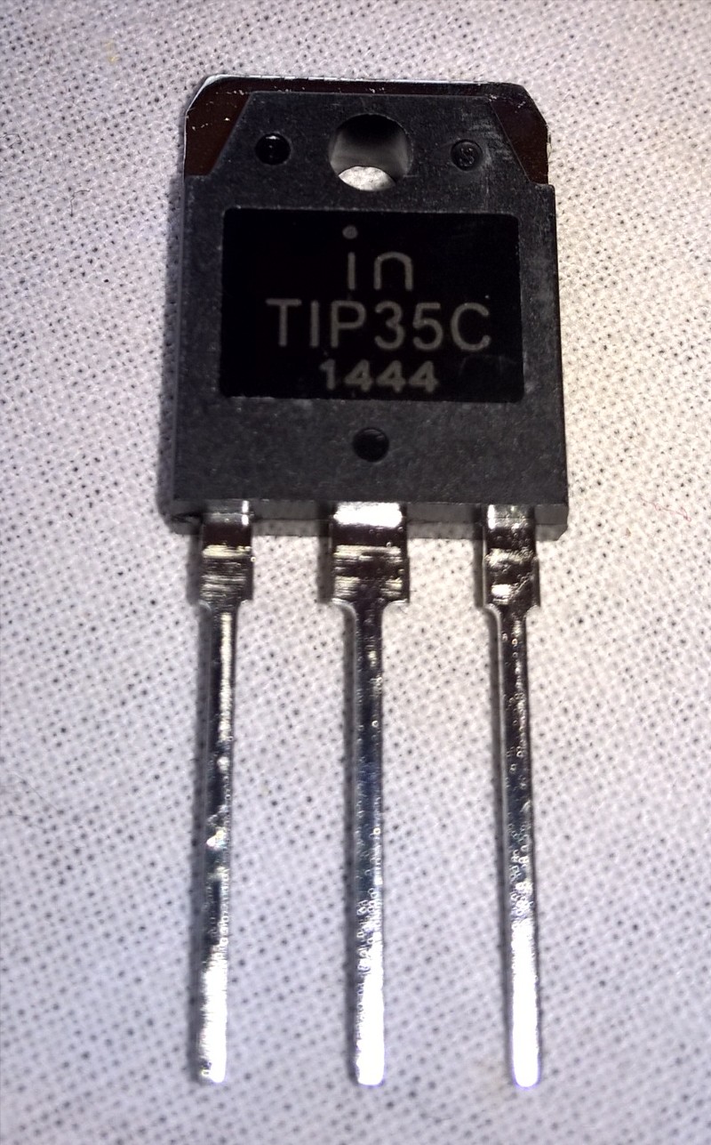

Hi can anyone tell me if in the attached picture the TIP35C and TIP36C shown are genuine or fake. Left in picture is TIP35C and right is TIP36C. The white suqre pad on the TIP35C was stuck on the die.
Both have resisted acetone test without any marking getting off

I busted open a Texas Instruments TIP36C made in Morocco and it looks identical to your ST. Sorry, I don't have any TIP35C to beat up for you.

The TIP36C is genuine. The TIP35C is not fake, it's a clone of respectable quality. I have used a few TIP35C and TIP36C from MOSPEC without problem.
Fake transistors use tiny dies and are by far never intended to perform as good as the original part. Clones are intended to exhibit the same performance.

Well yes TIP35C was branded MOSPEC. Sorry cracked it open too quickly. Would you recommend that it might still be used

36C: real
35C: fake
