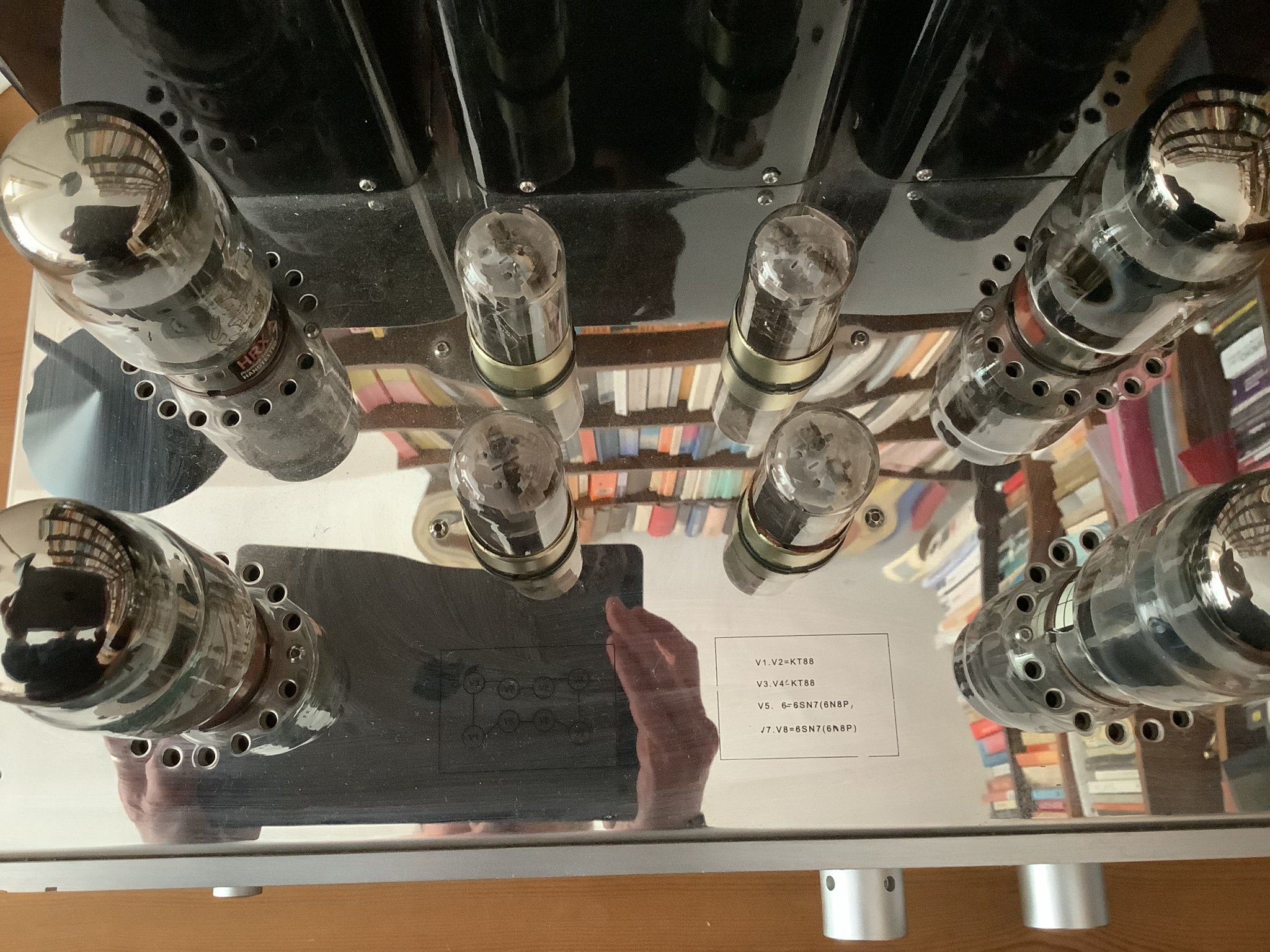

Hello, was listening to some streamed music this afternoon. The amp is a Separo amp that has 4xKT88 ouut valves. I was doing my ironing when my wife came in and said, “what’s that smell?”. At first Ithought it was the iron but I looked across at the valve amp and on of the KT88s was glowing much brighter than the others. The sides of the tube were going black too.
The volume was inly at 10 o’ clock bit I switched the power off immediately. So what do I do now? Is it likely to be one valve failing or is it likely to be something else? If it is just the valve, can I just replace it with another KT88 of the same make (Genelux) ordo I need to replace all the KT 88s?
How do I proceed from here to see whether it is just the valve failing or possibly the transformer or something else? I’m reluctant to even turn it on again before I receive advice. Thanks all.

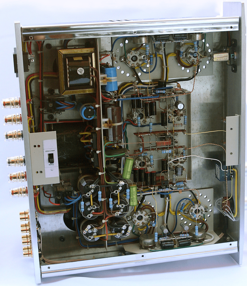

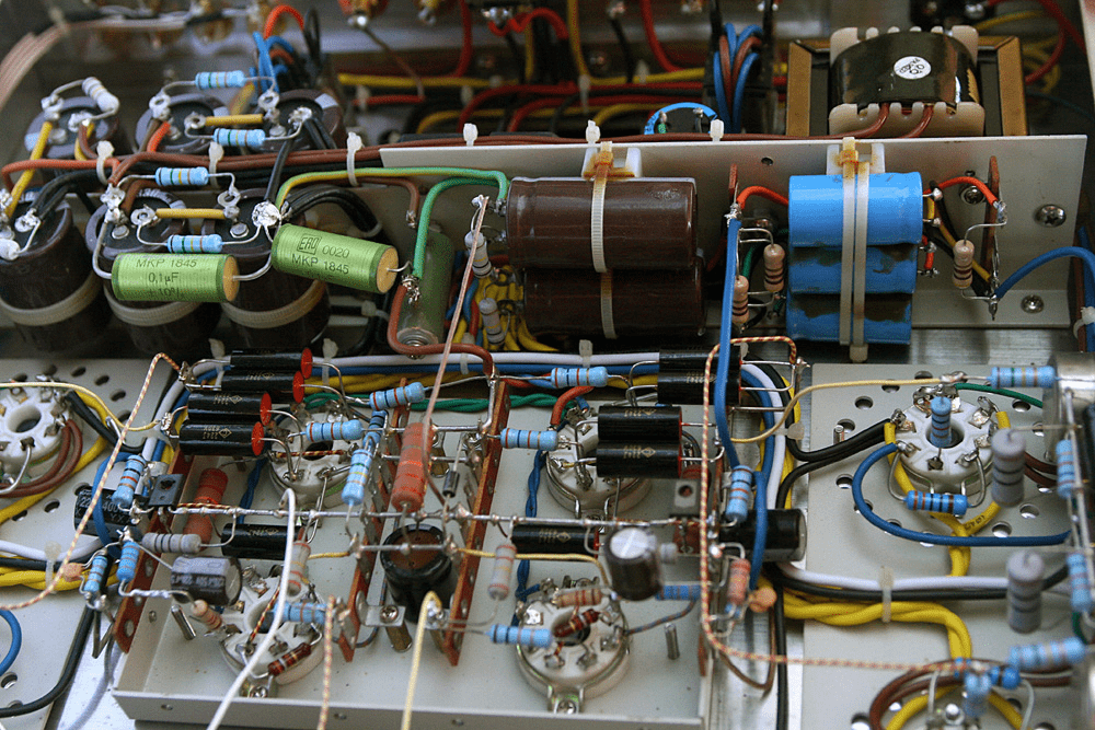

Chinese amp from the early 2000s, in my opinion ,no schematic found, it must be close to a Cayin / MingDa el34 6L6 kt88.
A picture of the top and bottom would help...

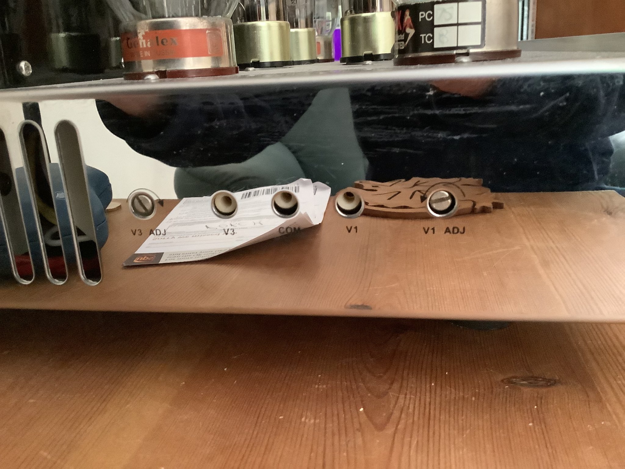

Thank you all for your input. I have no schematic but attach photos of the bias points, the bias adjustment instructions and the specification page. Setting the bias instructions I think, may be incorrect hence the pencil annotations. Setting my digital meter to 200mv range gives me a reading of 1. So, I set the meter in either the 2000mv range and bias at approx 500mv or at 20v where the bias is .50.
I’ve turned the amp on this morning for 30 mins then tested the valves and reset the bias to 500mv. They’re all at or anout this now and there has been no repeat of the red plating valve. Touch wood.

it's clearly the Meixing electronics factory.

Separo seems to be an Italian company.
it looks like the French company "Pier audio" which buys amps in China, gives them an "update" and sells them at exorbitant prices.
I don't know if Separo still exists.
