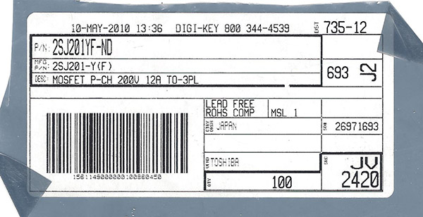

assuming the toshibas in question are the ones in the 2sk1529/2sj200 family:
1. they are indeed not laterals, so no handy ~100mA zero tempco for simple biasing - they will need a temperature tracking bias circuit,
2. they have higher transconductance than the laterals,
3. they have closer N to P matching than laterals.
somebody on here is selling a bunch of them. i can't say those being sold are real or fake.
if you find real ones, they are nice devices. it's a shame toshiba quit making them.
