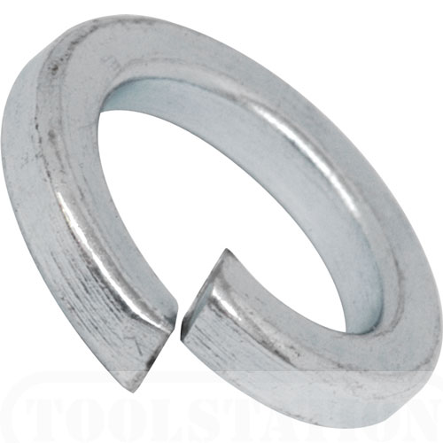

Use spring washers to keep bolts tight.
PS. And do not use hand held cordless drill for drilling heat sinks. The holes need to be ideally vertical.
I'm not familiar with "spring washers" Frags, do you have a link or pic?
As to drilling the sinks, I found the 10-32 holes for the angle aluminum were the most difficult to keep square, but mattered the least. The 4-40 holes with careful eyeballing were square as can be....I did the first as a trial and it was true as I could measure, of course there are only 4 of those for my F-5 build. The larger 10-32 were more difficult to keep straight and true....but since they just went through holes in the angle material (whose hole can be hogged out to allow fitting and trueing) so it really wasnt as important as clamping a fet square to the sink surface with the 4-40.

Spring washer:I'm not familiar with "spring washers" Frags, do you have a link or pic?
russellc
You can find them in any home hardware store.
To mount FETS I'm using regular washer (10mm outside diameter) plus a spring washer.
This is the correct option! Belleville Washer
the above option is just for shake proof
...the above option is just for shake proof
So....if you often shake your amp to get more out of it...like shakin' a printer cartridge, then those would be a good option???
Sorry....couldn't resiste!!
That's the best. You can buy them at various spring values.
Spring washer:
Oh, I see now, I've just never heard "spring" in reference to them. I'll get some, thanks for the tip!
Russellc
Is there a prefered spring rate for this application? I've never seen this kind, very interesting.
Russellc
Now you will have sleepless nights thinking if your washers provide proper pressure on FETs.Is there a prefered spring rate for this application?
PS. I always use spring (split) washers. No problem so far.

Just to confirm the earlier comments on the difference between "shakeproof" and "constant load" washers.
The split washer, the serrated washer and similar are to prevent an improperly tightened nut/bolt/set screw from vibrating off. Similar to self locking nuts.
The "Belleville" washer is one type of constant load type fixing. It is designed as an elastic "spring" between the underside of the nut/head and the device to be clamped.
A stack of Bellevilles can be used to arrive at different spring ratings.
Two Bellevilles one inside the other has roughly double the spring rate (force change as distance changes, eg. due to temperature exapansion) and double the holding power (twice the force).
Two Bellevilles facing in opposite directions have half the spring rate and the same holding power. Combinations of opposite and same direction series Bellevilles can achieve many different loads and stiffnesses.
the split washer needs very little force to squeeze to flat.
As the fixing slackens off the two cut edges expand out and dig into the surfaces to prevent further unscrewing. By this stage the fixing is "loose" with very little clamping load. The split washer has done it's job. It stops the joint falling apart and the nut/bolt falling out.
