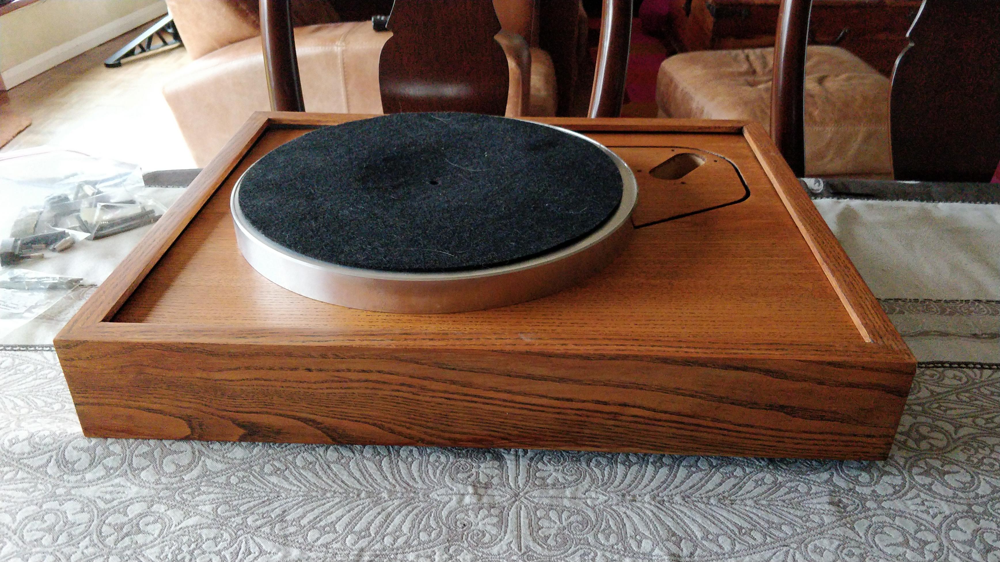

When I bought my Roksan turntable in the late 1980s, everything was finished in black. Black 44cm amps/cassette decks/CD players, black stands, black ash speakers and turntables. In a moment of boredom I wondered what it would be like to change my record deck to a proper wood finish, rather than just black. Fortunately it is a real wood veneer, with a black paint job - not a plastic vinyl wrapping. I've used a chemical stripper and some scraping to get rid of the blackness, and it looks pretty good. But there is still a small amount of residual black paint in the fine parts of the veneer grain.

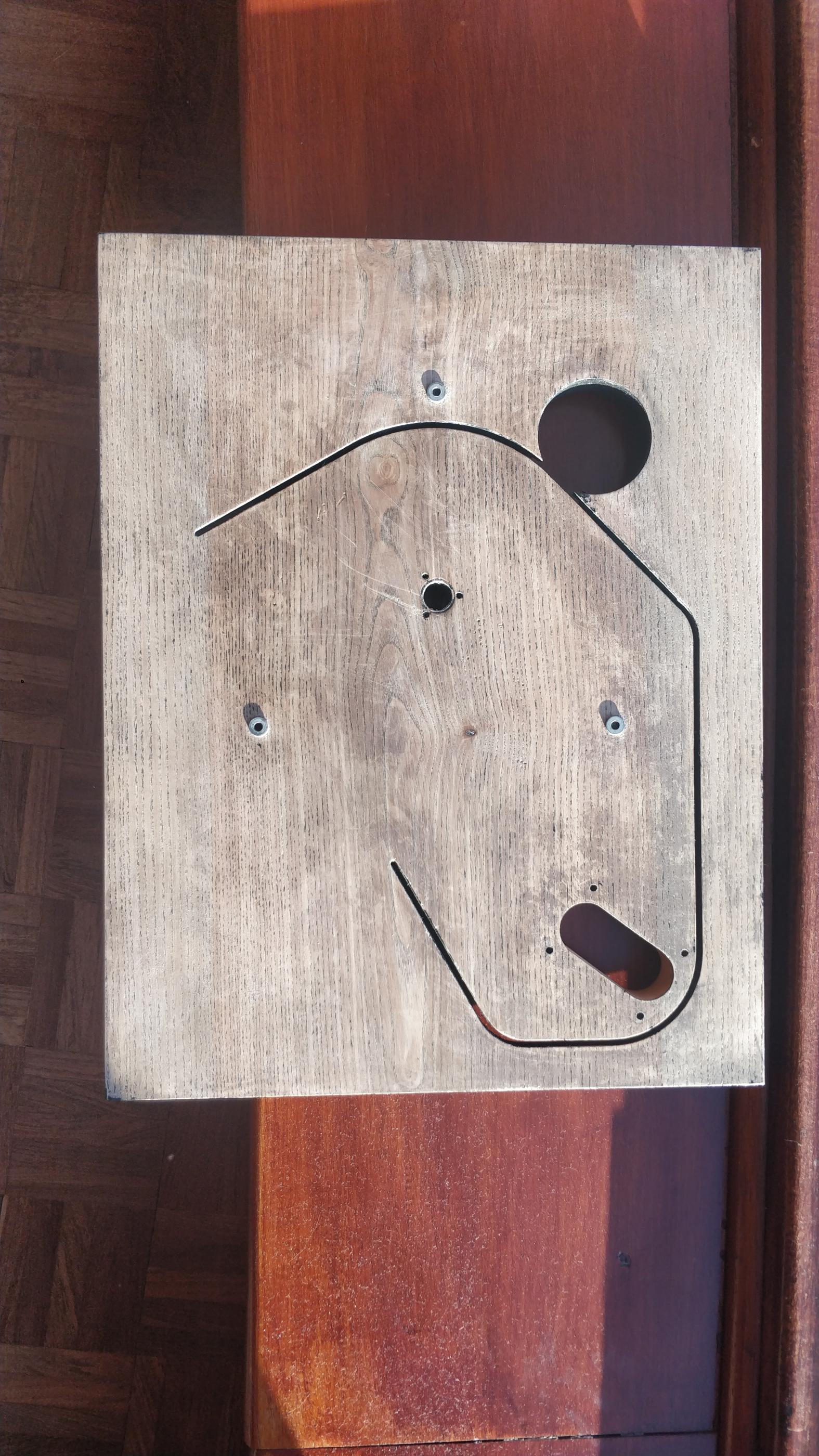

I've attached a picture of the bare veneer, it looks kinda grey. I'd like to apply a darker stain but want to get rid of the blackness in the deeper parts of the grain first. Should I try a chemical based approach or maybe very fine sanding/wire wool?

Leaving the blackness in the deeper parts of the grain may actually help to emphasise the grain after applying a brown stain.
This is a well known technique called 'pre-shading' which is used to emphasise the panel lines on model aircraft.
Try it out first on a section which will be hidden from final view.
There is a pretty large area (if you can imagine a 12" diameter circle in the middle of a record deck
) which I can play with. I had thought about the contrast of black in the depth of the grain, which would probably work well with a brown stain. I was wanting to try something more at the red end of the spectrum - autumnal colours, as I look out if the window. Off to the paint store tomorrow.

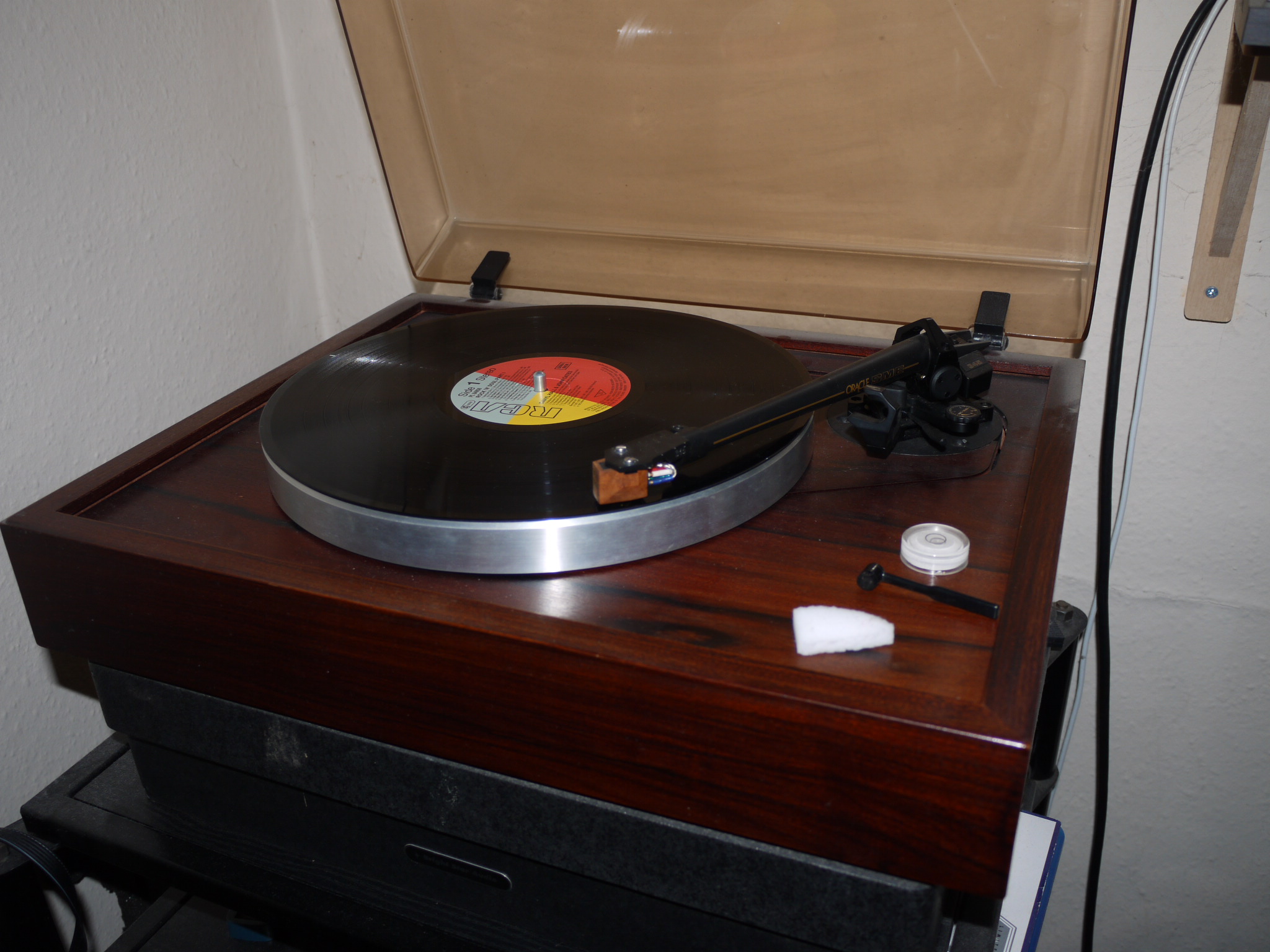

With ash being as open pore as it is, I doubt you'll be able to get that color out before damaging the veneer. Maybe try using a light colored grain filler to cover it?
Bill -- brave! Clean it thoroughly and see how much it lightens up. Rosewood is going to be pretty dark (and *is* pretty, dark)

Oddly enough 30 years ago (exactly) when I was chosing this I also got down to gyro vs Xerxes. I was lucky and the shop had the rosewood demo model going cheap as it had an SME cutout. I also am on 3rd PSU as it seems in the 80s that british turntables were expected to have power supplies that would burn out every other year. The saggy top plate was adjusted out by the factory and have left that.

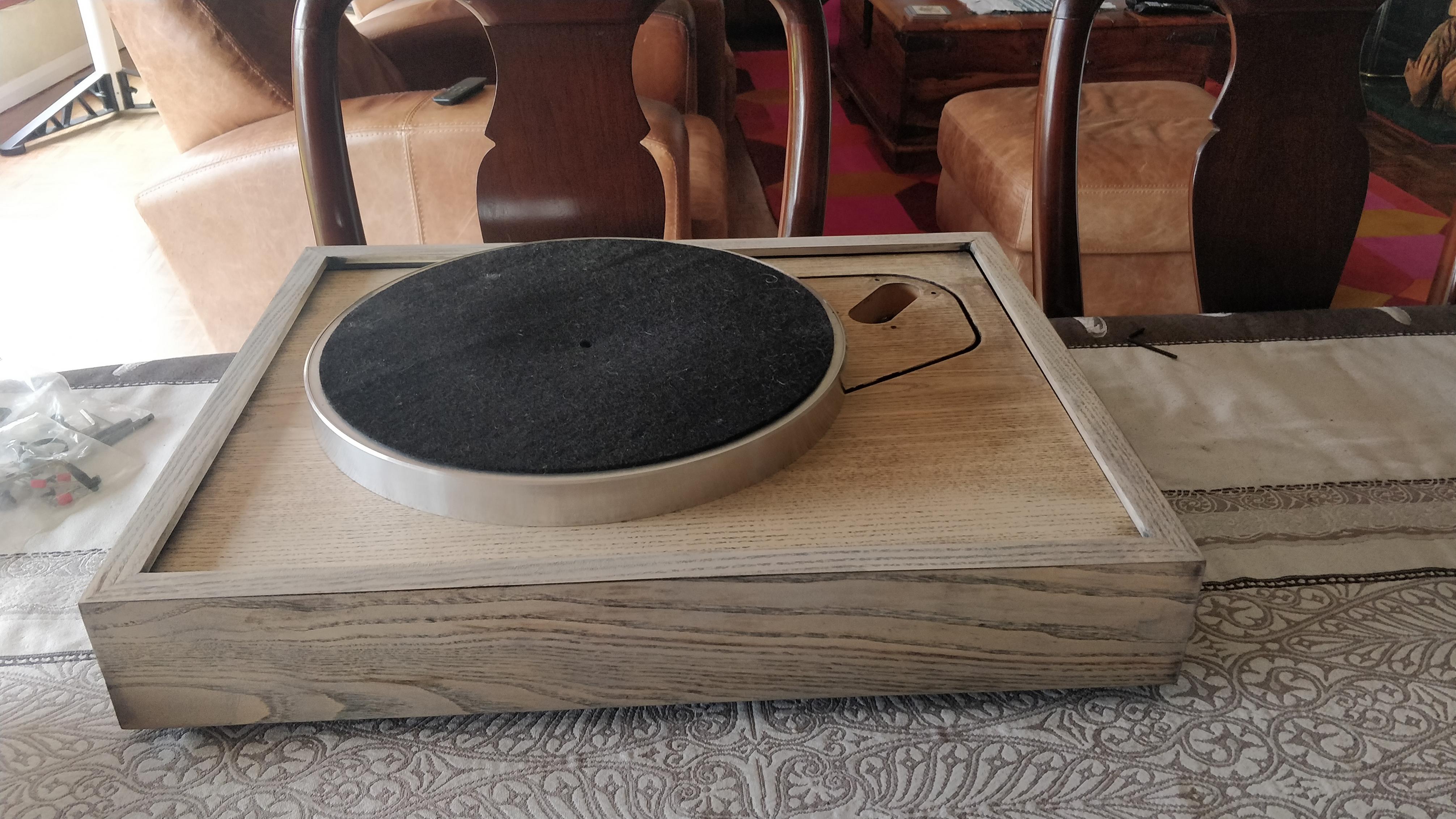

Have you tried using some 320 grit sandpaper on a hard foam sanding block?
I'm somewhat impatient, and went for 240 grit in a multitool. But I was careful to keep it flat and not roll around any corners. I also didn't go in very hard so the original black paint is still in the deeper grain lines. Looking at it now, as a white ash finish, it is quite growing on me - the attached picture doesn't do it justice. A little bit more work, and a plain satin varnish? Hmmm....
If it were me, I'd be putting 1 lb cut blonde shellac on it and call it a day. A few coats, sand smooth through 1000 and then 0000 steel wool with paste wax to get that nice sheen. Shellac dries quickly so you can get it done pretty quick.
Bill -- I wouldn't touch it beyond keeping that wood clean and waxed.
I too think that looks rather good. Quite like the light oak finish they used to offer.
