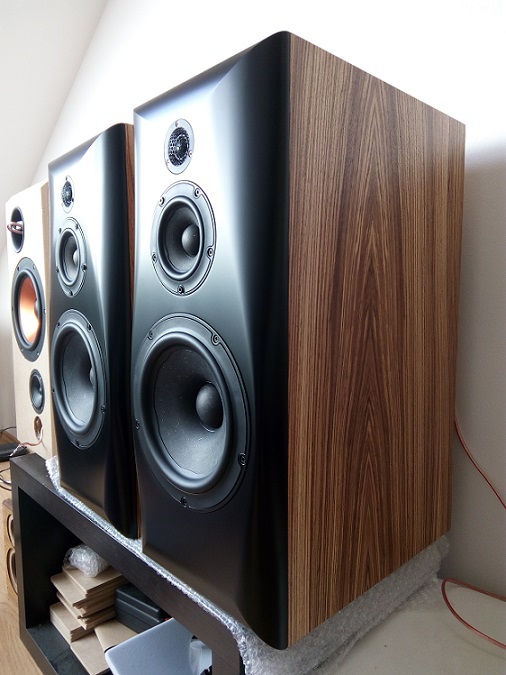

Excellent driver
This is a great 4". I use it in my Manzanita CV as a mid-tweeter. You have to correct for the rising response if you use it too high. My only knock is I wished it were a couple of db more efficient. Highly recommended!

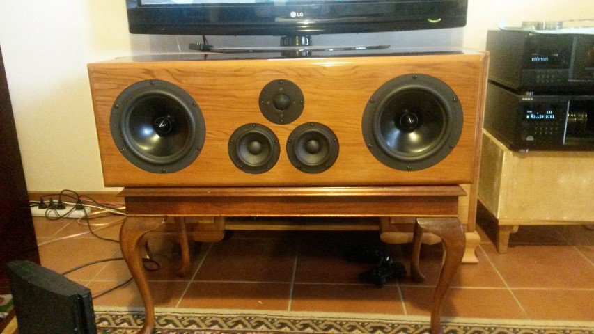

Used 2 of them in a Jim Holtz/ Curt Campbell Finalist centre.
Like the sound very much. Turned the mains off and impressed by the centre alone. The designers seem to really like them.

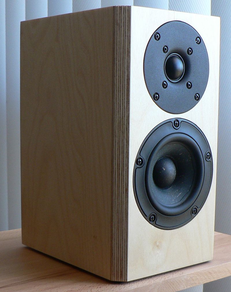

I used 2 in an MTM config with dayton RS28A. The 4 samples I got measured slightly different in 9k range and made a small difference in the modelled crossover response. I didn't get around to measuring the final result though. I think I may have gotten early production units but in any case they sounded very good. I'm not as big a fan of the larger units in the series but the 123 sound very detailed and natural.
