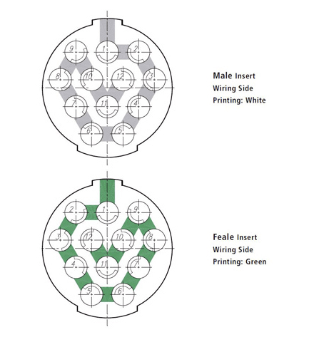

I have a Neutrik 12-pin DC cable but it's too short, so I will need to make one (or pay someone to make one). 12 pins of 22awg, times two.
I am not terrible at soldering but it's sort of a twice a year thing for me, and these pins are little. I couldn't hold a candle to someone like my father, who was godlike at my age.
My questions are threefold:
1. Can someone who is barely skilled do this or is it simply a bad idea?
2. What's the best way to strip 22awg wire?
3. Any other tips or tricks?
(details here: https://www.neutrik.com/en/product/mscm12)

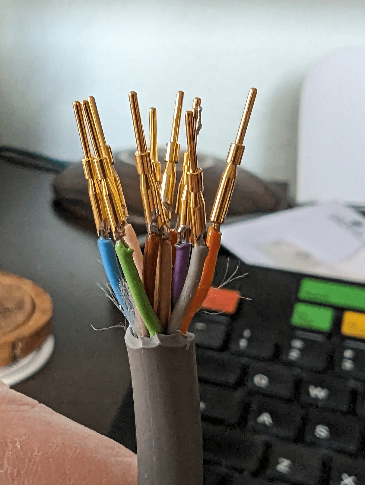

Well, following the datasheet, the contacts are soldered individually while out of the plug body then inserted into the plug body.
This makes it easier.
Hold everything securely so your hands are free to hold the iron & solder.
A pair of pliers with an elastic band over the handles, resting on the bench works well to hold the contact securely.
Something heavy resting on the cable stops that moving.
Twist a piece of wire over the other cores to keep them out of the way as you solder one contact at a time.
A smear of flux always helps.
The tricky bit is not melting the insulation, though some thin heatshrink could rectify that.

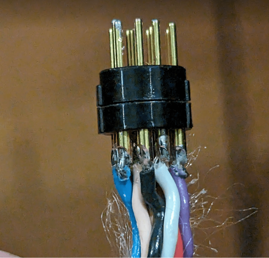

It isn't pretty but the easy half is done (because I could put the wires where they wanted to go rather than where they had to go, I figure the second half is going to be a lot harder), no unwanted continuity.
This is going to hard to test after I get the second half done, isn't it?
Frankly, I guess it will be a nightmare to test 12+12 pins connected haphazardly in a such confined space.This is going to hard to test after I get the second half done, isn't it?
+1 For heat-shrinkable sleeves (like @Netlist already suggested), since I would never leave those wires so close without them.

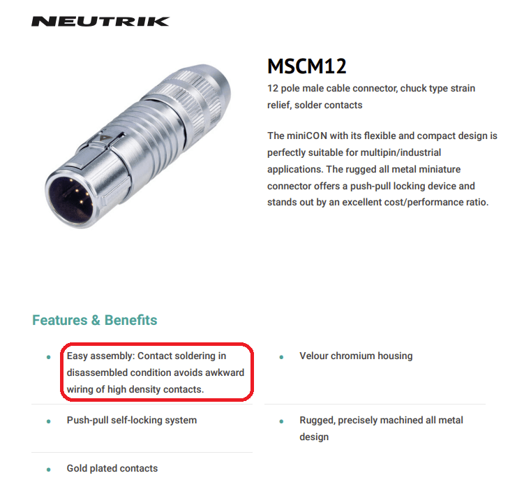

Just out of curiosity, did you regularly disassemble those pins before soldering them?
Ulogon the pins and the connector are new from Neutrik so if I understand you correctly they came disassembled.
Heat shrink would be great but I have only 15mm of wire to play with and 4mm of those 15mm are bare wire (the soldering surface) so while it's theoretically possible, I'm definitely not talented enough to cut it to ~6mm lengths and keep it out of the way while I solder.
Not exactly.if I understand you correctly they came disassembled.
Even if I've never used the 12 pin connector, the pins have to be disassembled before soldering so that you can solder the wires easily and then you must reassemble the pins following the colored line of their path which replaces the numbers assigned to each pin.
Furthermore, the above will make it extremely easier to test the cable when you have finished soldering all the pins and have them positioned neatly instead of haphazardly. 😉
https://www.neutrik.com/en/product/mscm12.pdf

Ah, now I understand you ulogon. Yes, you are correct that my existing able is too short (thus I am building one from scratch) and yes, as you note the pins get soldered to the wire before they are put into place within the harness.
By "only 15mm of wire" I meant that the instructions call for stripping the outher jacket only down to 15mm.
I guess my contention (wrongly perhaps) was that even if I were to cut the heatshrink down to size I would run into two problems:
1. There would be too much bulk in the way of the "distance sleeve"
2. It would be very difficult to get the wires into the "contact insert"
I know you're trying to help-- and I am grateful!-- but are you sure that heatshrinking everything is a feasible approach?
Note in the photo that I had to heatshrink the violet wire and even that made the "distance sleeve" hard to close up

I guessed, I was not at all sure, but in my view it's the best possible approach, when/if it's possible and from what you describe here it seems not to be.
Although the sleeves you are using seems too thick, perhaps a thinner type in thickness and diameter would help more.
Anyway, I think that to cut the corner you have to solder the wires more precisely.
The bare 4 mm of wires well twisted and pre-tinned (with little tin), the pins recess pre-tinned (with little tin), a lower temperature of the soldering iron, overlap the pre-tinned wire over the pre-tinned recess, touch the pin just long enough for the tin to melt and when it cools clean off the excess of flux.
The bare exposed wire and the soldering tin must be straight and must not protrude (as much as possible) from the recess of the pin and you can go without heatshrink.
Wanting to add a couple of hints.
The tip of the soldering iron must be clean, but it must also have a small drop of tin on it in order to transfer the heat better and therefore more quickly in order to obtain the "right speed" regarding the objects you are soldering.
The "right temperature" of the soldering iron has to represent a compromise and it must be "high enough" for a good melting speed of the solder in order to be not to heat the pieces too much and "low enough" so as not to melt the insulation of the wires.
However, looking again at your last pic I noticed that (just as expected from having the pins disassembled) it seems like you did better than the first time and I want to encourage you because you did well, bravo!
