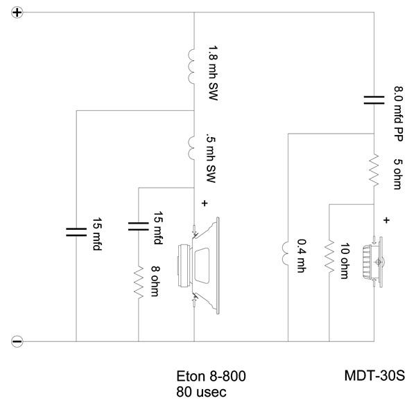

This xo i don't have any weirdness. it's the original xo.
i don't know what you are surprise.

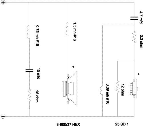

i see this xo curcuit. it does not any mistake. i think that you set the xo point too low.it may be 1.8-2.2 khz. in this case the tweeter work hard. i don't guess that the sound will be better or not. but you can adjust this xo a little when you listen it. this xo i think you can make it with no any problem.
regards😉
