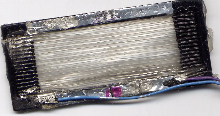

I have an older pair of ess air motion tranformers.
While trying to put them into a case, I pulled the wire a bit too hard, so that the foil is now broken near the connectors at 2 points.
Does anybody know how I could possibly mend this? Soldering is not possible. Is there anything you can use to connect aluminum foil (or whatever it is)?
If it is not possible, maybe somebody knows if there are replacement foils for these (old) speakers available? they are from the "Performance Series 5". The foil itself is about 33x75mm.

WIRING?
anybody knows how they're wired?
I found means to reconnect the strips, but end with either zero ohms or no connection.
I once had a little bit of sound, but very weak
and don't remember how I did it

where are there connections between strips?
wire1 and wire2 can't possibly be connected to the same strip! but the other (working) one looks like this. is there an isolation between 2 strips?
I can't see anything else I can connect the lower
wire to
are all visible strips really 2 layers isolated from each other?
I thought the current should have the same direction on all strips?
please somebody explain this to me

alfsch said:if the foil is ok, you can solder alu
I use a silver-containing fluid from conrad. this works, but I can't work out the proper connections!
THE FOIL
yeah theres only two, but whats in between?
which way is the current going?
I couldnt find out with a multimeter.
resistance violet cable to opposite (top) side is 2.5ohms (half resistance). very good.
blue cable to violet is zero or infinite depending on whether I connect the blue to the next strip (lower left end) or not.
the connections come up at the edge but seem to be connected to the SAME strip (can't be true)
at the red dot I made the cut, because this strip SEEMED to go through, but didn't (two layers!).

every foil fold has two aluminum strips inside.
here is a scan of the foil after HOURS of maltreating:
