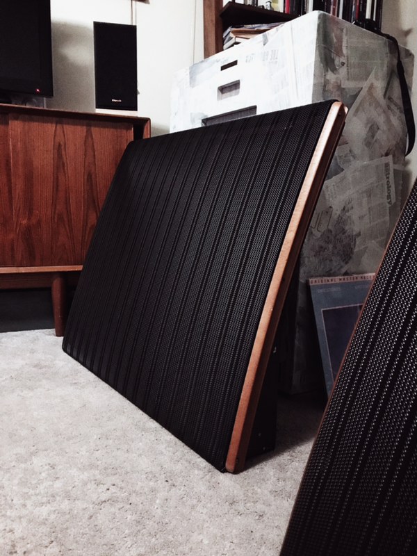

Just picked up some ESL 57's, and I know the impedance curves are "challenging" for amps.
I have a stock Marantz 1030 I wanted to try with them, but am concerned about it being able to manage the low impedance dips.

Very current limited amplifier (same power at 4 and 8 ohms), so don't push it very hard.
Remember the Quads are refined, not loud. Let them charge up overnight first.

Depending on their condition, they may take that long to charge to a proper operating state.
Until then they could have a very low acoustical output, but that does not mean that you just
turn up the amplifier. That would do damage.
Bear in mind that the Marantz could fail or oscillate, and damage the speakers due to the loading.
A tube amp is going to be much more suitable. Remember the Quads will not play loudly regardless
of the amplifier used, and can be easily damaged by trying to do so. If used within their limits though,
they are extremely good speakers.

Not at all, but the amp should be turned off before connection to the speakers.
Make sure the volume control is at minimum before turning the amp on.
Play them at low volumes only, esp if you are used to Klipsch. Good luck.
The speakers stay plugged in and turned on at all times, like a clock.
Plug each speaker's power cord directly into the wall socket.
You don't turn them on and off along with the amplifier.

They're alive!!!
Brief moment of drama as power light did not come on on one speaker. Low muffled sound.
Bad power cord.
Listening at low volume for the next few hours until they come up to full charge.

The power lights have no bearing on the power supply operation. They are purely indicator lights and are typically burned out by now. They are neon bulbs with a limited lifespan.

Best to not use them at all, until both speakers seem to be at full level. You could be clipping the amplifier,
while generating very little volume due to incomplete charging. These speakers are extremely delicate,
and must be used with great care, repeat great care, at all times. This cannot be emphasized too strongly.
Ignore the flickering neon lights. Talk to Sheldon (above) if you have any difficulties, or need repairs.
An output capacitor coupled amplifier could cause LF abberations, due to the speaker's impedance curve.
Thank you both! Lamp is back on. Power cord is iffy... Looks like the plug has some connection issues - plug isn't grabbing on properly to the pins in the speaker. Same problem on both speakers.
Put a new cord to the plug and triple checked continuity and its as it should be.Been listening at low volume intermittently while I've been working on a desktop amp I'm making/experimenting with.

Personally, I would leave them as-is, if they seem to work well enough.
Adding proper stands would be a major improvement in sound.

Was planning on starting with the legs!
They did not come with feet/legs so they are sitting on milk crates at them moment...
Plan is to make the taller style legs that are integrated with the side panels. Will give me some design options for colour schemes🙂 Grills are black, think these were made in 73' based on serial numbers???

Please be very careful not to let them fall over. Here is a good design for those who want
a baffle below them. Height is best 14" to 18" off floor, so you may want to experiment.
