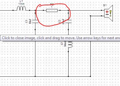

Due to the shape of my room, I need to equalize one speaker channel. I need to drop 5db at 70hz. I came to this conclusion by experimenting with EQ. But I don't want to use EQ so looking for a better way to equalize the speaker line it's self, since it's only one narrow frequency drop.
In preamps this can be done with capacitor values but what about directly on speaker wire handling 50W? Is there some other option? I don't want to run my signal through another preamp like EQ as this degrades the signal so that's why I'm asking.

Two things are likely ... First the filter in the crossover would have a lower Q than one at line level or in the digital domain so the range of affected frequencies would be much broader. Second, these filters are almost always a series resonant shunt filter which will increase amplifier current significantly at the center band of the filter.

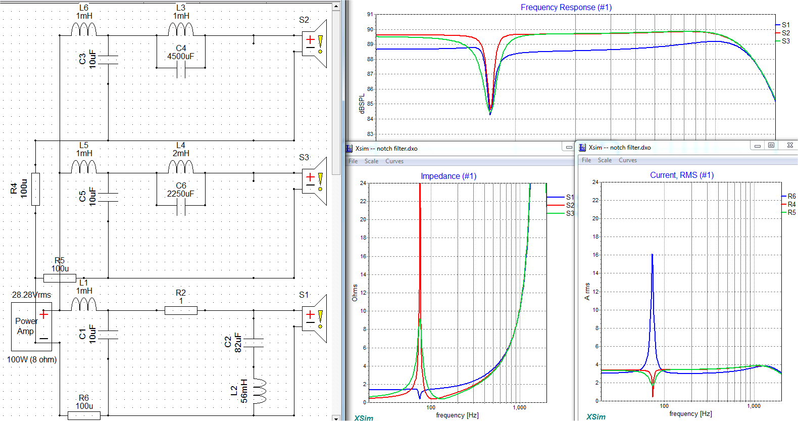

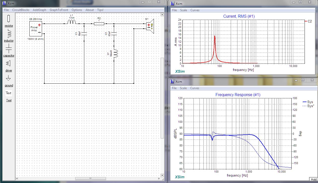

See the attached thumbnail... The OP was asking for a 5db 70hz notch in his crossover. The lash up shows a second order crossover with a 70hz series resonant shunt filter... notice the current going through it... yep, that's 16 amps at 100 watts. It's an amp killer.
Doing it with EQ or DSP has the opposite effect, you get a narrower band of affected frequencies and turning things down actually reduces the load on your amplifier.

Look at the first Sim I posted. Okay, do you see that big red spike in current at 70hz? That is going to still happen no matter the Q of your filter.
Now a little math tells us that a 100 watt amplifier, which is what that sim is tuned to, expects to produce about 28v across 8 ohms ... about 3.5 amps.
Now what do think happens if you ask it for 15 or 16 amps?
That shunt filter is going to look for all the world like a short circuit.
That is to say that a filter constructed like the one in the Sim is likely to damage the amplifier it's connected to, at the very least it's going to drive it into protection.
Or more succinctly ... it's an amp killer

I'm guessing you didn't see the second sim I posted using a parallel resonant "stop" filter, and the effect the shunt resistor had across almost the entire first 500 or so hertz. Shunting it with a resistor only reduces it's Q and distributes its effects more widely.
As I told the OP... this is going to mess up his system more than any EQ or DSP ever could.

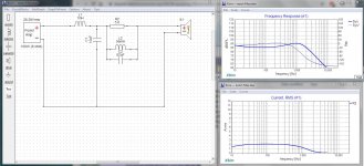

Higher Q filters can be sensitive to parasitics. I like to swamp a resonance with a sufficient resistor but here there's barely the luxury (as has already been shown).
Using Douglas' filter shape (blue), I wanted to set a baseline (red). This has no resistance in the loop between the capacitor and the inductor, so it is unrealistic. It shows the minimum inductance that will work in this configuration.
I put 0.1 ohms in the loop (green) and changed the values to get the peak back to 5dB. The Q has changed. The inductor resistance (and the capacitor's) will be critical in this configuration.
I also changed the current sense conditions so as to accomodate the different configurations fairly.
At this point this sim has too low impedance in general so isn't ready for use, just perusal.AllenB said:damping can be reduced by using a high Q inductor (low resistance). A filter could then use a much lower value of inductance.

A stop filter does solve the high current problem... but the OP was only looking for a 5db dip. That would mean putting a resistor across the tank circuit to limit it's effect, which would totally destroy the Q of the filter as my second sim (Post #7) shows. Download it and set the resitor R2 to Open and watch what the frequency response does...
There is quite literally no way of doing this without a severe downside... either he looses all output from about 40 to 100 hz, the bass is carved out by a low Q filter or the overall bass level is dropped by several DB... or, heaven forbid, he cooks the outputs on his amp.

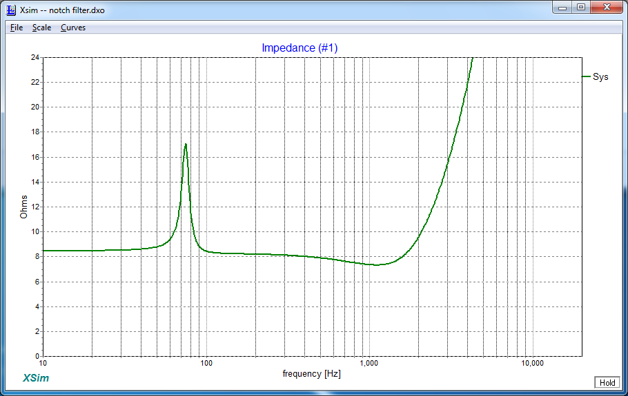

I made a mistake using Xsim as I'm not used to it (I used it so I could expand on your work). Here's the impedance.or, heaven forbid, he cooks the outputs on his amp.
