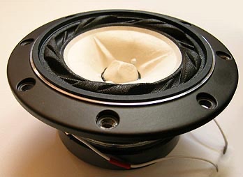

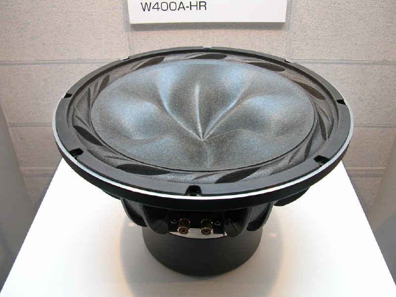

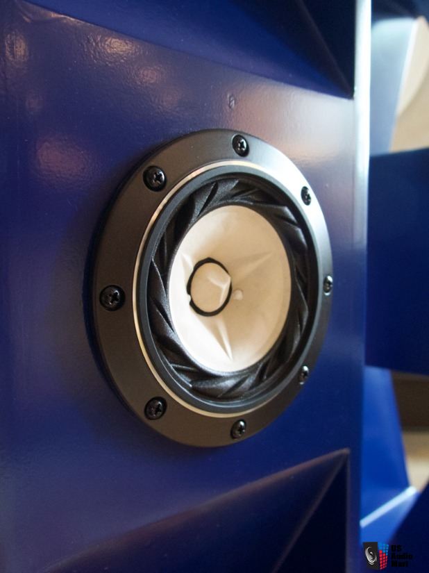

Purifi was not the first with “weird -o” patterns of alternating pleats, etc on driver surrounds: Fostex EZ series to name at least one. Of course, those also incorporates structural ribs on cones and dust caps, and IIRC, something special in the lower spiders as well?
Yes! I remember. There are several with wrinkly surrounds. Does anyone know if a variable thickness would help stop resonances?
Fostex has been playing with the concept of a surround that behaves in a linear manner no matter where it is in its movement. The shaps such that “ins" & "outs” cacel out the differences, I first saw it at AES 1999. Since then there have been other maker splaying with the concept.But poictures of Fostex are easy to pull out.
It woulkd be, i expect that one could change the behaviour of the surround to sorta imitate what they ar etryting to do. Very tricky to figure out exacly how. Someoine good with Cosmos maybe, or a ton of cut n try.
