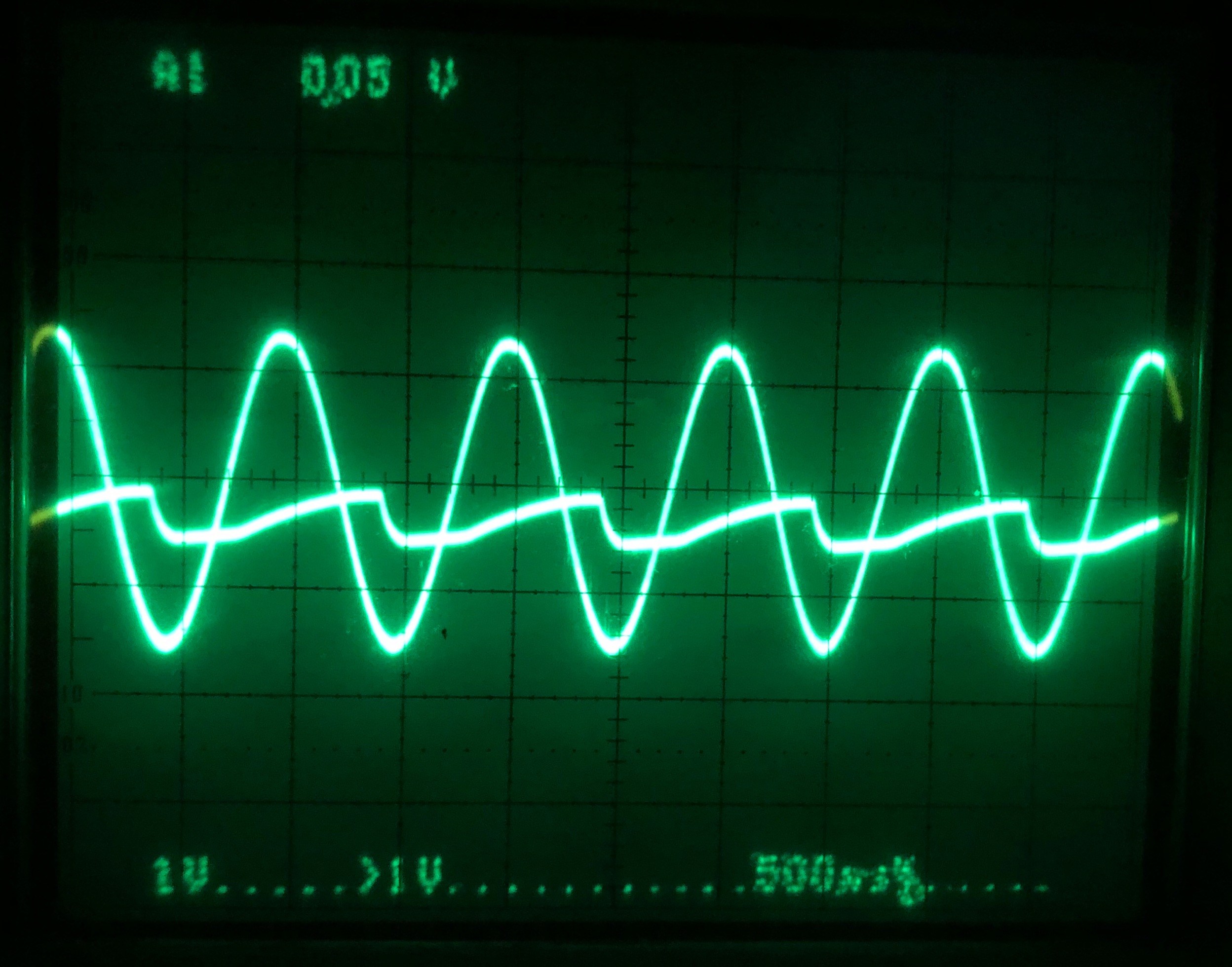

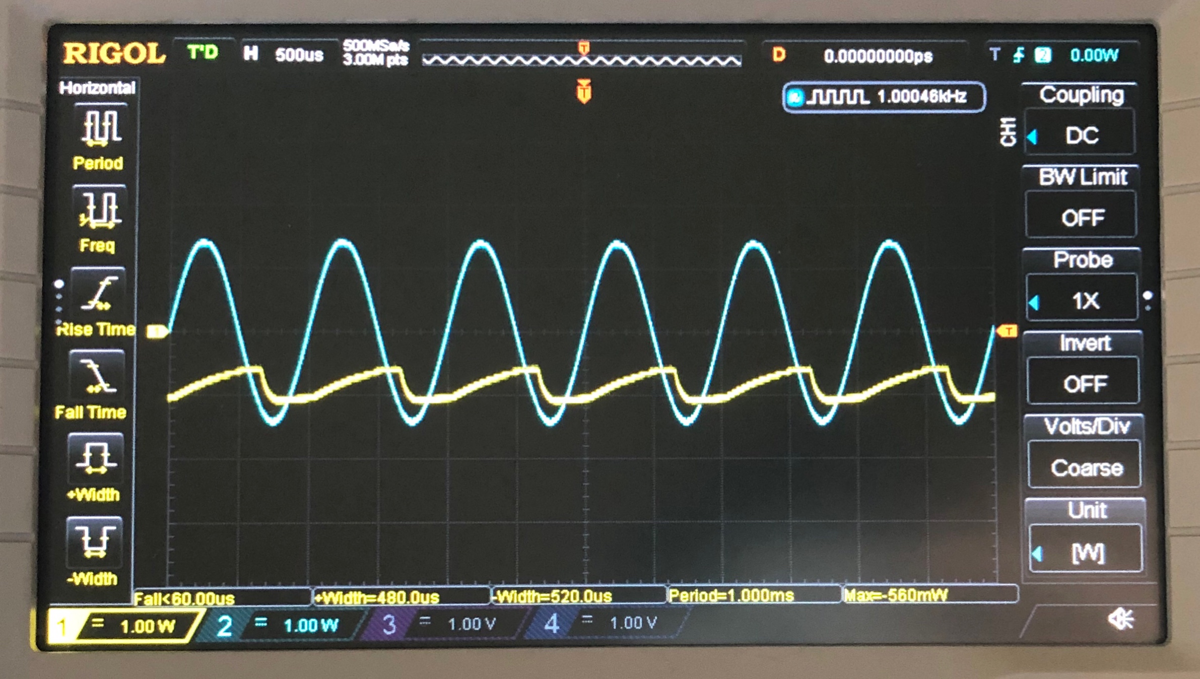

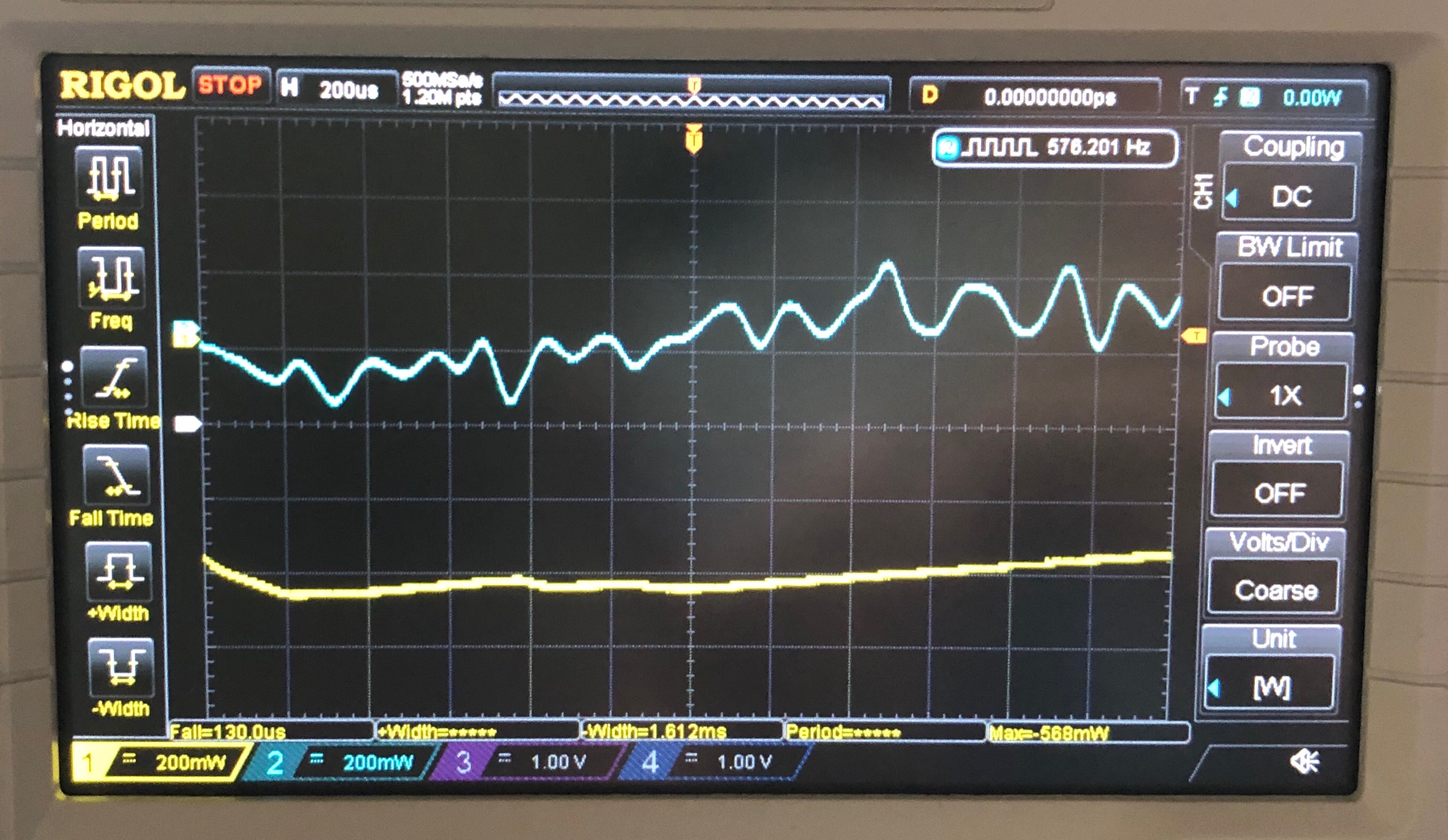

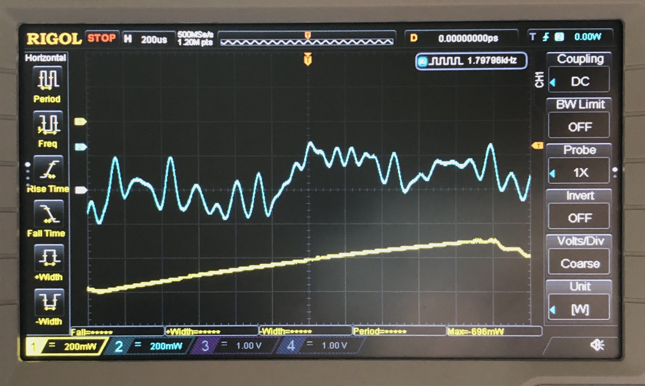

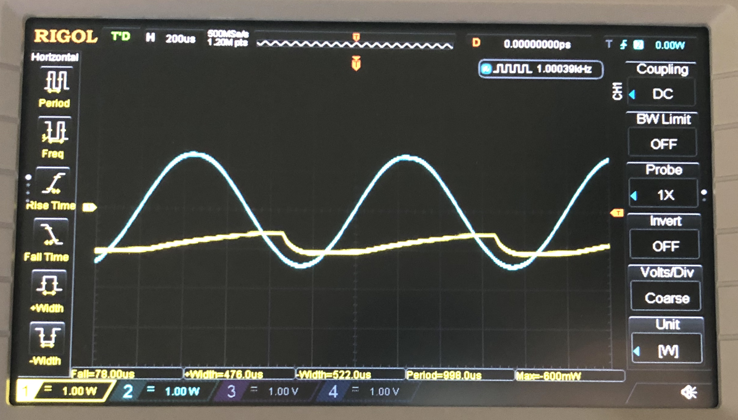

Folks,
So for a reason I don’t know, now only 2 out of the 5 channels are distorted, what I did so far is:
1. Desoldered the filtering caps on the Power Supply just to test them and then soldered them back.
2. Disassembled the Amplifier board and, you know, twisted it around a bit to look at the bottom, etc.
3. I noticed the board was dirty mostly with signs of excessive soldering flux so I sprayed some DeOxit and brushed it a bit cleaner.
4. Measured some resistors, continuity, etc. But haven’t changed any parts.
I’m surprised to see how many SMD components this amplifier has on the bottom part of the amplifier board, hundreds of them...
Then I decided to put a 1kHz sine wave and analyze it with the scope, that’s when I noticed that only 2 are bad now, then I played some music and connected the speakers and yes, confirmed, they sound good with music as well...
What could be causing this???
Attached are some pics from the scope, there you can see how a good channel (blue) compares with the bad channel (yellow) both playing music and with the 1kHz wave.
And because I have all the testing equipment it doesn’t mean I’m a Pro by any means, not even close, I’m just an Audio Enthusiast and this is my hobby.

Does the bad channel have that sawtooth pattern with no input signal? Sawtooth is usually raw power supply voltage. Are those signals with a load or without a load?
Craig
Thanks for your reply Craig!
No, w/o signal is completely flat.
And the signals are without a load.

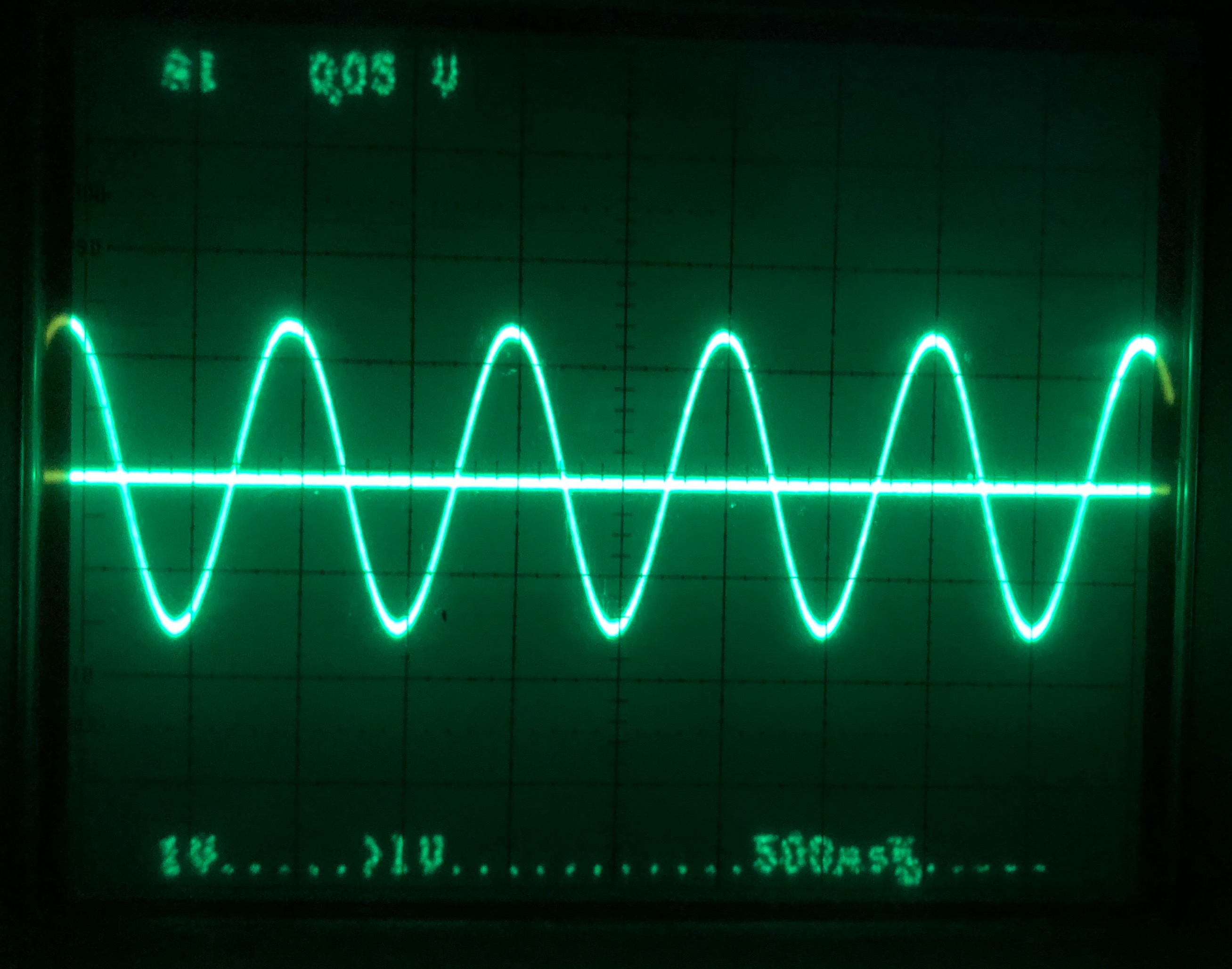

I’m attaching the same measurements but with an analog scope, the first with both signals in and the second with the bad channel without signal in.

Do the bad channels have any DC output voltage? Do you even need the bad channels anyway?
I’m glad you asked, I didn’t measure this before!!
Yes, the bad channels have DC output, one has 876mV and the other 650mV, all others have anywhere from 15 to 65 mV.
