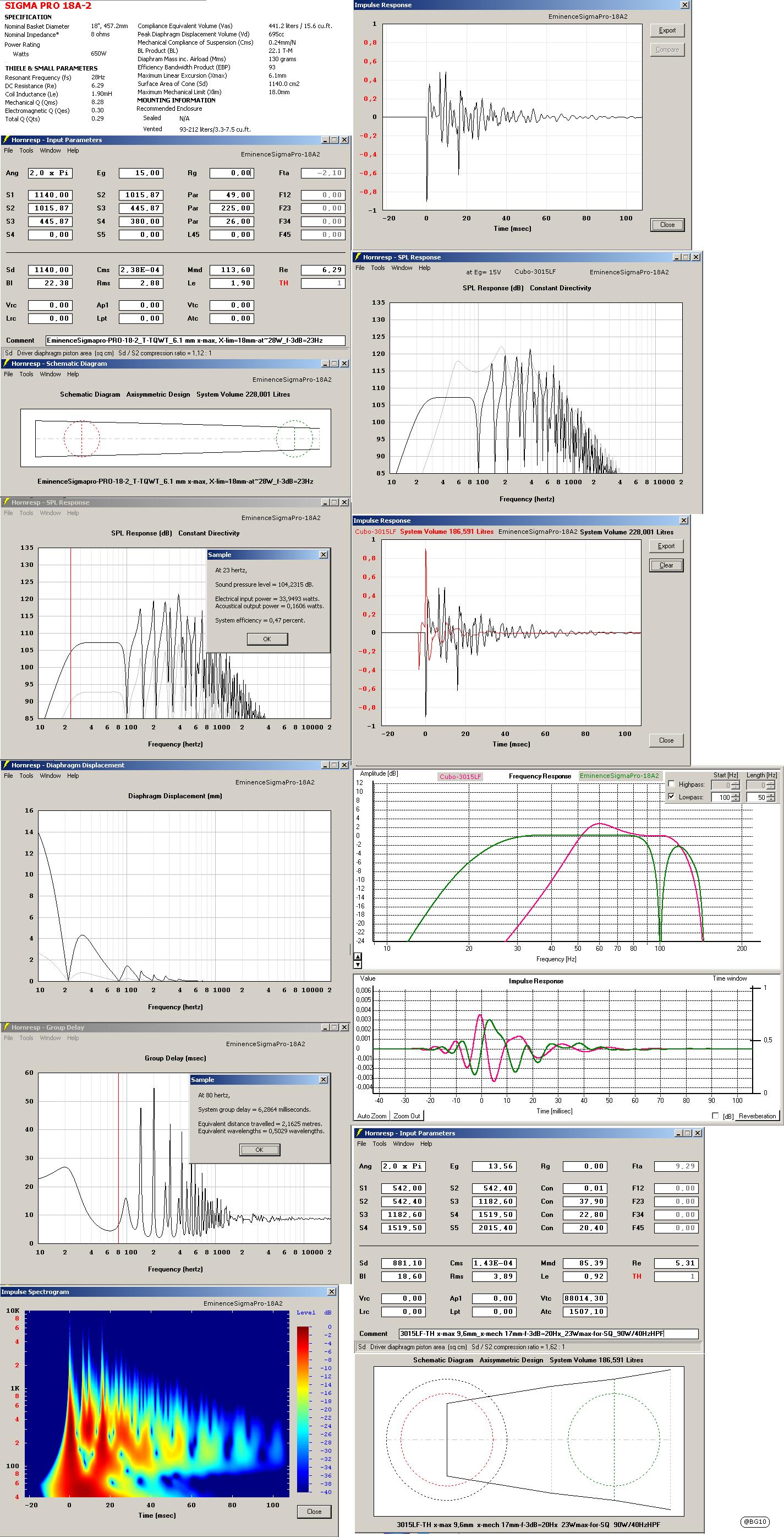

About 6 cu ft (net) with the port tuned to 28hz and a high-pass filter with a Q=2 at 28hz will give you a -3dB point of 28hz with the SIGMA PRO 18A-2.
Most common plate amplifiers have a hi-pass filter than can be changed as per the above requirements.
I don't know how you get 28htz in F3, I make a simulation with BBpro and it give me 62htz with your specs.. how you get that ?
"I don't know how you get 28htz in F3, I make a simulation with BBpro and it give me 62htz with your specs.. how you get that ? "
"and a high-pass filter with a Q=2 at 28hz "
ok, I'm sorry, I'm a newbie with high-pass filter. so it will not be causing a over-excursion even over 28 ?
"ok, I'm sorry, I'm a newbie with high-pass filter. so it will not be causing a over-excursion even over 28 ? "
You can model it in BassBoxPro, I use v6.0
I'll post the window for that design when I get home. Remember, musical program material doesn't eat cone excursion like sinewaves do.
Driver Properties
Name: Sigma Pro 18A-2
Type: Standard one-way driver
Company: Eminence Speaker LLC
No. of Drivers = 1
Fs = 28 Hz
Qms = 8.28
Vas = 441.2 liters
Cms = 0.239 mm/N
Mms = 135.2 g
Rms = 2.872 kg/s
Xmax = 6.1 mm
Xmech = 18 mm
P-Dia = 381 mm
Sd = 1140 sq.cm
P-Vd = 0.695 liters
Qes = 0.3
Re = 6.29 ohms
Le = 1.9 mH
Z = 8 ohms
BL = 22.1 Tm
Pe = 650 watts
Qts = 0.29
no = 3.113 %
1-W SPL = 97.08 dB
2.83-V SPL = 98.12 dB
Box Properties
Name:
Type: Vented Box w/ Active HP Filter
Shape: Prism, square (optimum)
Vb = 6.4 cu.ft
Fb = 28 Hz
QL = 6.245
F3 = 28.29 Hz
Fill = minimal
No. of Vents = 1
Vent shape = round
Vent ends = one flush
Dv = 6 in
Lv = 9.795 in
Active 12 dB/oct. HP Filter
Fx = 28 Hz
Qx = 2
No. of Drivers = 1
Fs = 28 Hz
Qms = 8.28
Vas = 441.2 liters
Cms = 0.239 mm/N
Mms = 135.2 g
Rms = 2.872 kg/s
Xmax = 6.1 mm
Xmech = 18 mm
P-Dia = 381 mm
Sd = 1140 sq.cm
P-Vd = 0.695 liters
Qes = 0.3
Re = 6.29 ohms
Le = 1.9 mH
Z = 8 ohms
BL = 22.1 Tm
Pe = 650 watts
Qts = 0.29
no = 3.113 %
1-W SPL = 97.08 dB
Box Properties
Name:
Vb = 6.4 cu.ft
Fb = 28 Hz
QL = 6.245
F3 = 28.29 Hz
Fill = minimal
No. of Vents = 1
Vent shape = round
Dv = 6 in
Lv = 9.795 in
Fx = 28 Hz
Qx = 2
