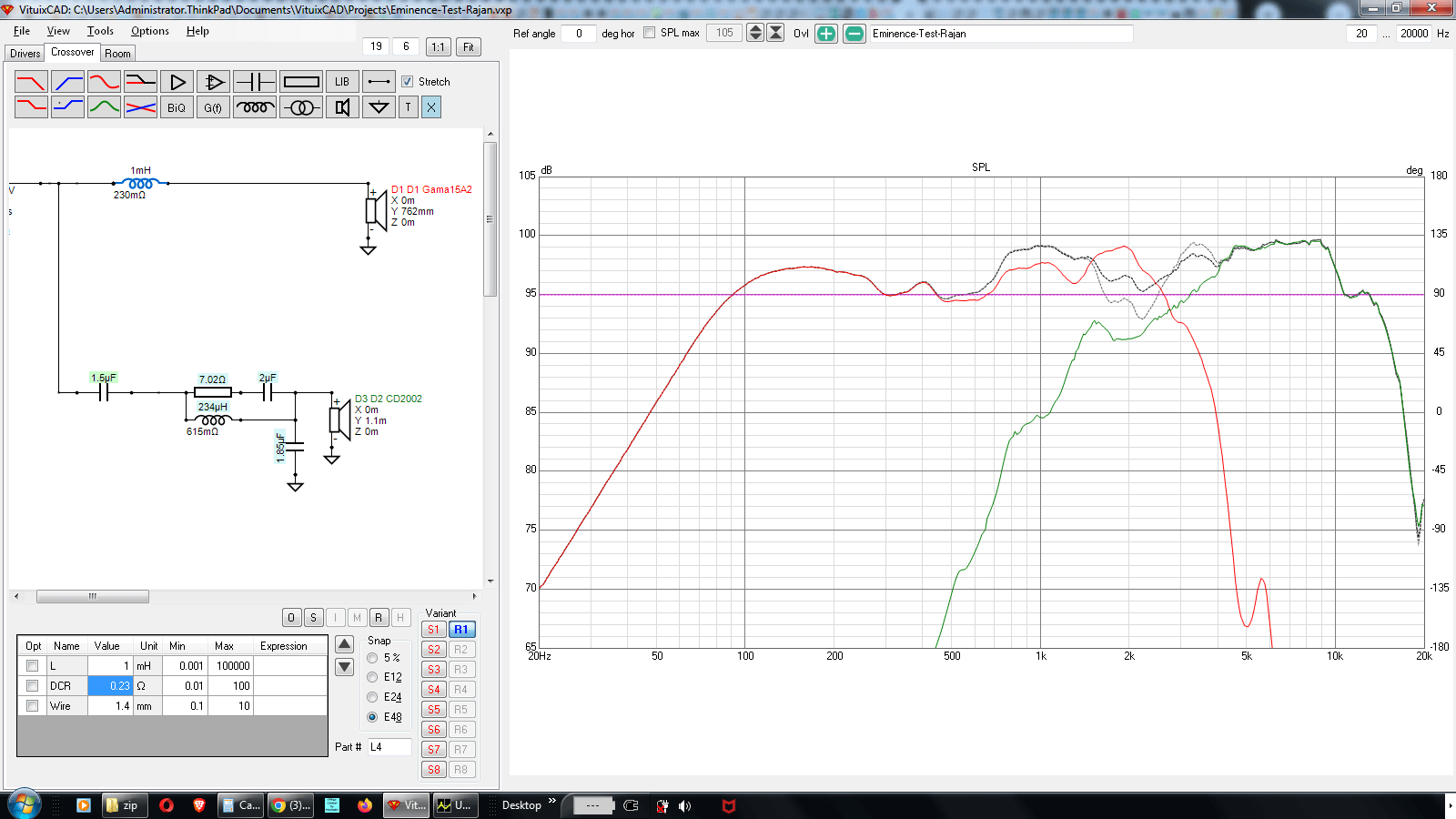

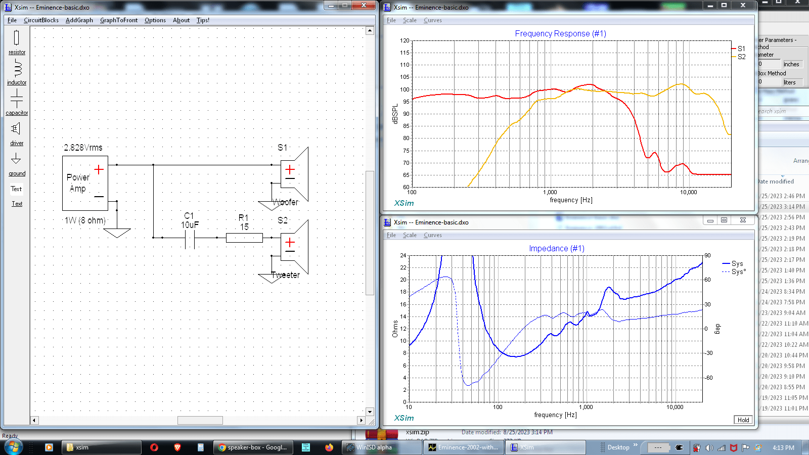

Have entered up a basic first order crossover in XSim.
But keen to create a VituixCad project file also.

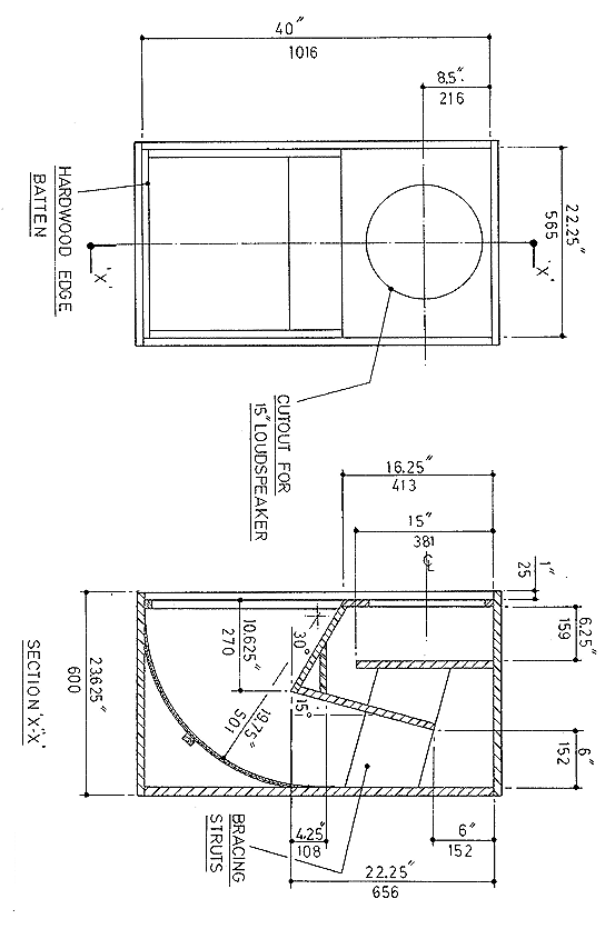

The box is built using online plans. Only thing pending is the cross over.

Ps: I will upload the ZMA and FRD files in a bit. As well as my first attempt in winisd and Vituixcad.

For the vented cab design, I suggest the David Weems book Designing Building and Testing your Own Speaker system, to calculate with a pen & paper or hand calculator, or if you have a windows computer, various speaker solftware packages. You want vented reflex box at the most primitive for a 0.3 QT speaker, although various people on here build more sophisticated designs for tuned columns. scoops or various other designs. I am no expert on these variants. Eminence has plans for various boxes for the somewhat similar product Kappa-15A on their website.

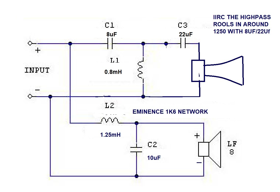

IIRC Eminence's stock 1k6 network highpass came in a bit low for a PSD2002 and its lowpass too high for some woofers -here's the values I remember.
Gamma 15 sure made good use of a 59 oz magnet slug and 2" coil to get its specs. Have you modeled it in that scoop?Is the scoop already built? - just wondering what this speaker has to do work-wise.
btw, Eminence's networks had one good thing on their highpass - a light bulb limiter consisting of two 211 incandescent lamps wired in parallel with each other and in series with the driver/ L-pad

Yes the drivers are installed in the scoop. And the scoop is built. I took the drivers out to measure them and to transport them safely to my penthouse. If you look at my Dats files the FS is not 33 its 36. The rest of the parameters are pretty close. Maybe the FS goes up with age. Maybe its the whole confusion between the A and the A-2 modell.

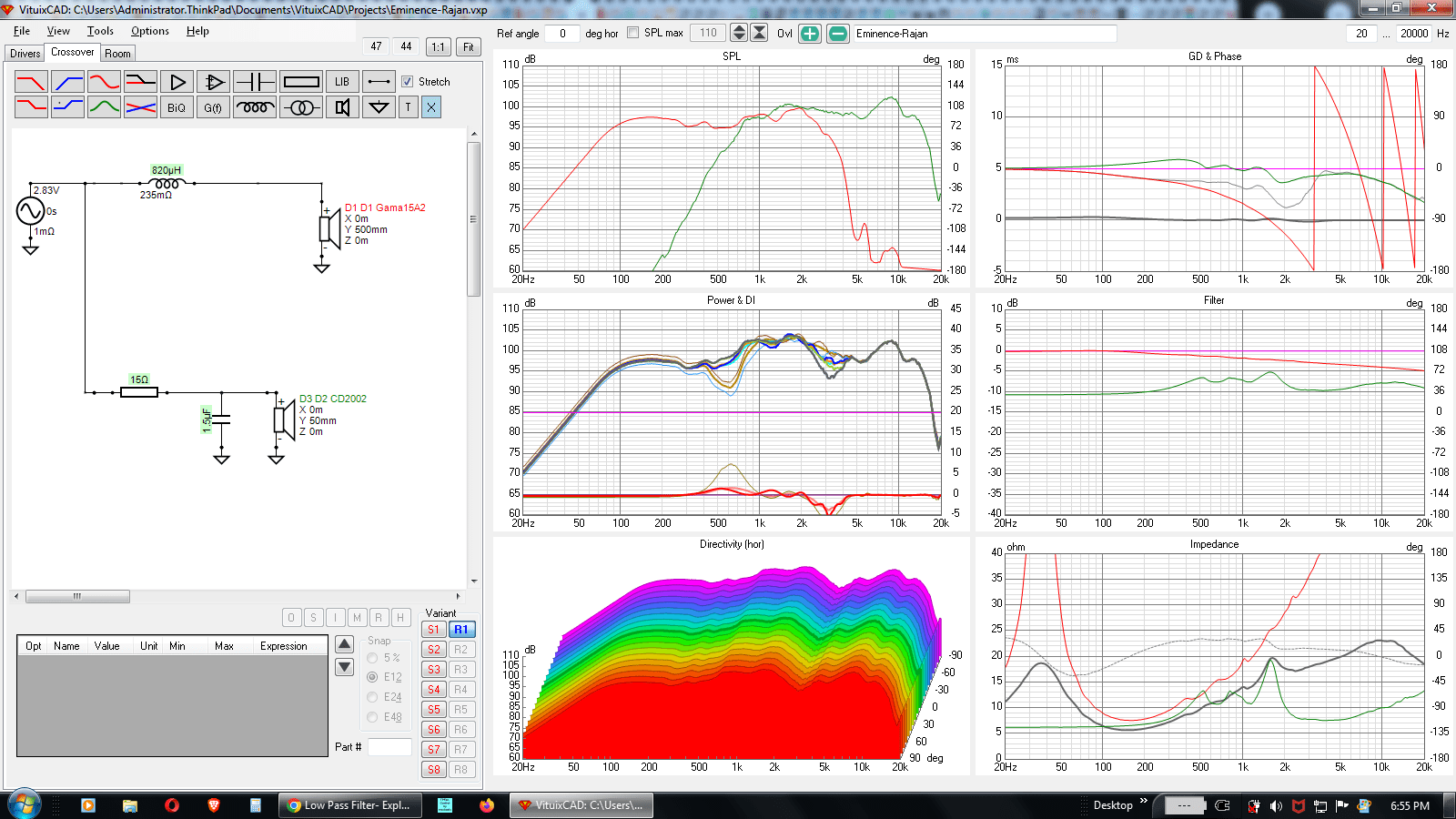

Spent hours trying all kinds of complex designs. From 6Db to 24 DB Nothing works as well as a simple 10Uf cap and one resistor. Tomorrow I hope to start to read up on phase and how that impacts sound.
Adding inductors to the woofer just mudies the sound have tried all inductor values. The woofer sounds fine without an inductor.
Only one issue remains the drop off that happens from 15K to 20K.
Then again at my age I can't hear those frequencies anyway. So should I really bother trying to pick up or flatten that area of the curve ?. Is there even a passive component solution. That is the only problem area left.
And adding 12v 20 watt bulbs to protect the CD. I have a feeling with the bulbs I wouldn't even need the 15 ohm resistor.
Will measure the res of the bulbs and add them as resistors to the modell.

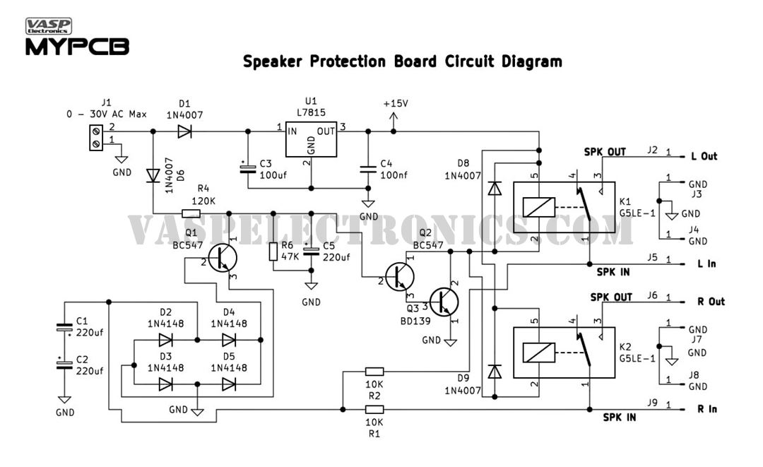

So based on more readings it would seem that I need to protect the woofers from low freq esp when the volume is high. I can use the s/w to see at what point this causes my Xmax to become a problem. By slowly ramping up the watts to the speaker. In the software.
Also looked into rumble filters. It would seem it should work. But rumble filters are a. Complex and One more PCB to add.
I have this speaker protection circuit already which I plan to use to protect the speakers.
Can this circuit be tweaked to act like a protection from my understanding it switches off the relays if it detects d/c on the line. Can it be tweaked to open the relay for say anything under 30 Hz.
I have no plans to drive this thing hard. Should somebody by mistake crank up the volume can this circuit protect it.

Well, 600 hz protection as the PE link really cuts off a lot of the sound we like to listen to. Useable for tweeters perhaps.
It is a real issue, I tore the leads to a 10" woofer in a KLH23 by walking across a wood floor with the turntable playing an LP. My PAS2 preamp bass filter affected all frequencies below 2000 hz so I left the knob at center. In tube amp days the power amp would not reproduce those low frequencies due to output transformer cost.
You could put a 12 db/octave high pass series the speaker, but C=159000/(Z*f) for 4 ohm speaker gives 1325 microfarad for 30 hz. That's $24.50 per speaker for parallel 3 400 uf and 1 125 uf 100 VNP capacitors from parts-express.
Paralllel inductor to driver of 12 db/octave filter would be 21 millihenries or $50 for two series 10 mh air coil inductors. $33 for two series 10 mh iron core inductors. Parts-express prices.
It is really much cheaper to do this filtering between the sound source (DAC?) and amplifier input. I picked up a used NADY CX-22SW sub crossover for $50 which has a knob adjustable frequency 18 db/octave low pass filter on both pass through channels and a summed channel for a subwoofer with both lower and upper filters knob adjustable. Similar products are available from Peavey and if you like use once & throw away products, behringer.
My analog graphic equalizers also have this function built in with a fixed frequency enabled by a switch. My PV8 mixer also has a fixed high pass frequency built in and switch selectable. Most bar stages are wooden and a microphone can pick up footsteps if it does not self filter low frequencies like the SM58.

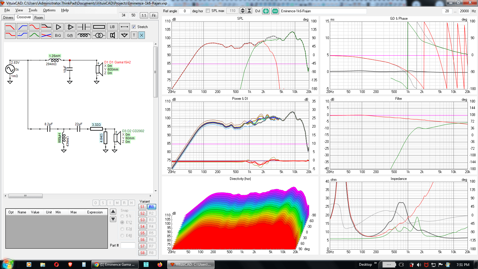

This is the simplest cross over I could come up with. Only one problem there is a bump at 8500 hz that I need to tame.
Any ideas. Maybe a notch filter at 8500 to drop the output.
Any other ideas ?. Or maybe this bump will just sound good.
Other simple solutions is just a simple L pad with a -6Db slope on the CD.
Vituixcad seems to be much better than Xsim.

It can be calculated mathmatically that a bump in a driver response curve causes frequencies in the result that are not there in the original signal. This is called "distortion".
If tuning for rooms, yes a response curve the opposite of what the room does to your signal can make for accurate sound. I have a 10 db room resonance bump at 200 hz. I tune for that with a $60 used graphic equalizer between mixer & amp. (I have LP, CD, FM radio, inputs to the mixer, no computer).
The 8500 hz bump is in the original PSD2002-8 response data. Personally I handle that by buying a Eminence N314T-8 myself. People with no Kentucky bias may prefer to buy something like a B&C DE111-8, although I haven't checked its suitability below 1000 hz.
Yes, individual bumps in the response curve can be filtered off in the speaker by a RLC trap parallel to the driver. It is a lot cheaper to buy a used graphic equalizer which can also be used to filter off room resonance modes. Other people that are addicted to cell phones prefer a DSP, although I find the constant update of software of digital equipment leads to obsolesence of digital accessories faster than I am willing to tolerate. I downloaded my REW software last year and it already is obsolete. My graphic equalizer is 15 years old and will be obsolete only when vendors quit using 1/4 phone plugs and twisted pair to hook up devices that produce and use 1 to 2 vac signals. .
