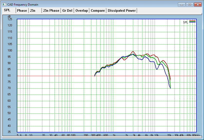

I have purchased the Elsinore waveguide, the most recent one for a centre speaker I am designing with a hypex amp. I would like to know a little more about the waveguide especially as it's not common in size, shape or width for that matter, not matching my 4 inch woofer diameter that it will crossover to. (They usually say the waveguide needs to match the diameter of the crossing woofer)

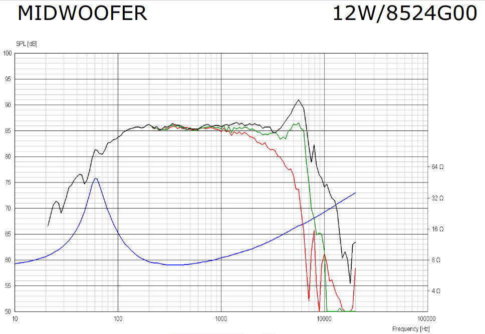

What is the lowest crossover point I can use which will still ensure controlled directivity to my matching Scaspeak 12W/8524G00?
And the waveguide is not like any other it's slightly deep but not wide. What are the tradeoffs of this kind of waveguide and what is the design principal behind it?
What is interesting is I know that the crossover recommendation for this waveguide is somewhat of a higher point of around 3000 hz but as the waveguide is larger in size I have a C-C distance issue so on paper at least I would like to go lower.
I've taken a look at the Scan-Speak woofer and in my opinion you'd want to try to work something out before 3kHz.
With the waveguide, taking a good set of polar measurements would help. As you have noticed it's difficult to guess whether this waveguide is intended to control directivity or other things. There is some data to go on.
Well, I was hoping for slightly lower around 2500 ish. I have seen the tweeter used around that point in other designs so it should technically work okay if we are talking about tweeters cut off point that is.I've taken a look at the Scan-Speak woofer and in my opinion you'd want to try to work something out before 3kHz.
Yes, I have noticed its not like a typical waveguide. Narrow width, doesn't match the woofer diameter I probably won't get a decent directivity match at the crossover region.With the waveguide, taking a good set of polar measurements would help. As you have noticed it's difficult to guess whether this waveguide is intended to control directivity or other things. There is some data to go on.
Never truly understood the trade offs and the goals of this design, obviously its intended for his DIY build more than anything. I just chose it for its simplicity for mounting it for D2608 tweeter but not sure if I made the right desicion.
Its for a centre speaker so perhaps the narrower directivity might end up being okay, but like you said I need polar plots.

The measurements suggest there's more to it..It gives a more consistent off axis response and less diffraction ripples then a recessed/felt covered option.
Can you show me what part of the measurements shows this?
