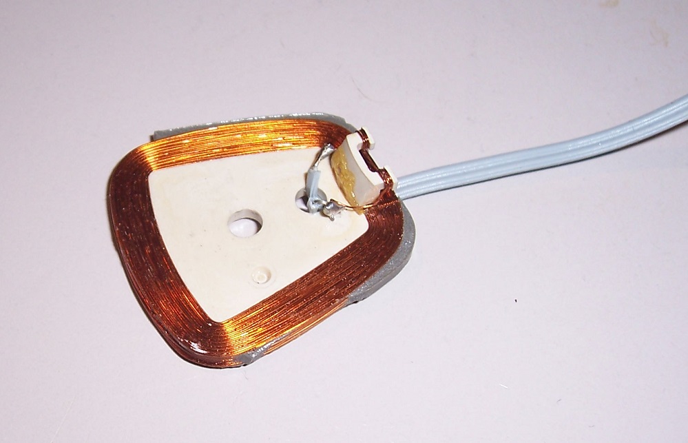

As I hate to wind my magnetic components myself, I reused ready-made coils: the sensor is from the actuator of a HDD, and the drive coil is a degaussing harness from an old CRT monitor:
I measured the electrical and magnetic parameters of both: the sensor has an inductance of 950µH, a DC resistance of 8.2 ohm and a // capacitance equivalent to 18.5pF.
The degaussing loop has an inductance of 770µH and a resistance of 2.5 ohm.
The coupling coefficient is ~0.0056.

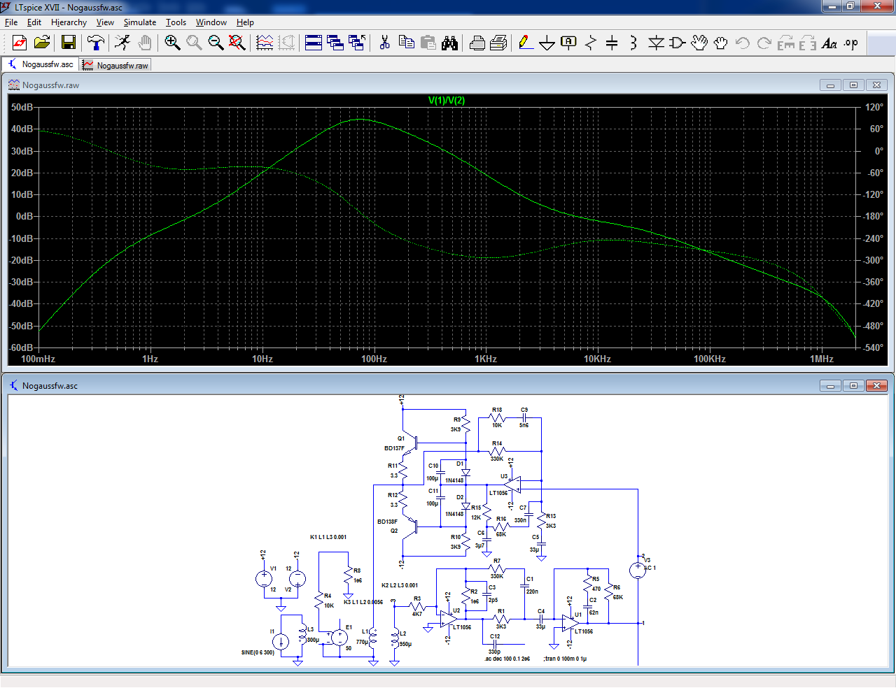

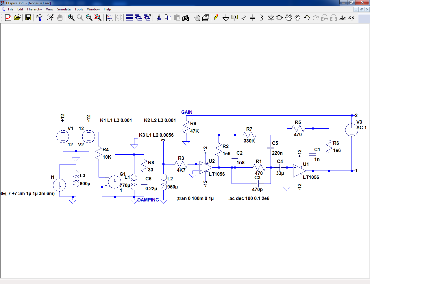

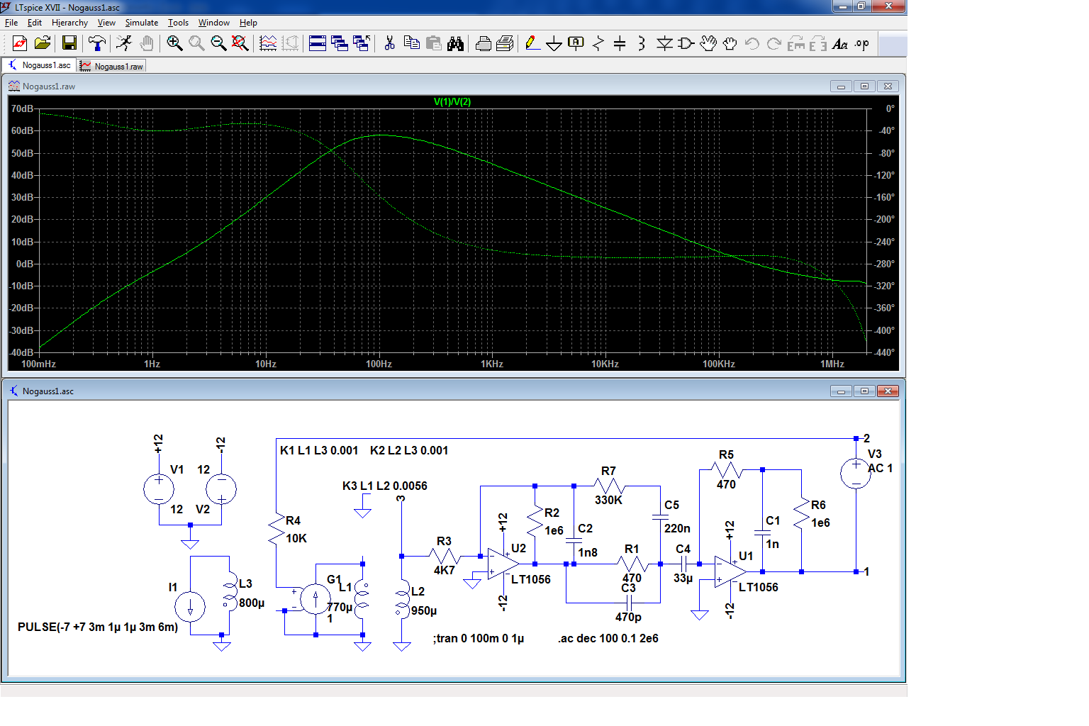

Here is the concept:
L1 is the drive coil, L2 is the sensor, and L3 generates the perturbating field.
The conditioning circuit is an integrating error amplifier, driving a transamp symbolized by G1.
Of course, this is only 1/3rd of a complete shielding system: you need two identical channels for the Y and Z axis, and if you want to do things really properly, a total of 6 drive coils in a Helmotz configuration is required
The loop gain reaches ~60dB @ 100Hz, which is very substantial.

I'm skeptic although the idea is good. My doubt is that your system will cancel the magnetic fields (Variable from certain frequency to some other maxima) only near the captor coil, but nothing guarantees the rest of the outer loop, still inside the degauss coil from CRT.
Yes, that's why 3 axis would be required, using 3 pairs of Helmotz coils to define a volume rather than a plane.I'm skeptic although the idea is good. My doubt is that your system will cancel the magnetic fields (Variable from certain frequency to some other maxima) only near the captor coil, but nothing guarantees the rest of the outer loop, still inside the degauss coil from CRT.

Now, let's have a look at practical problems.

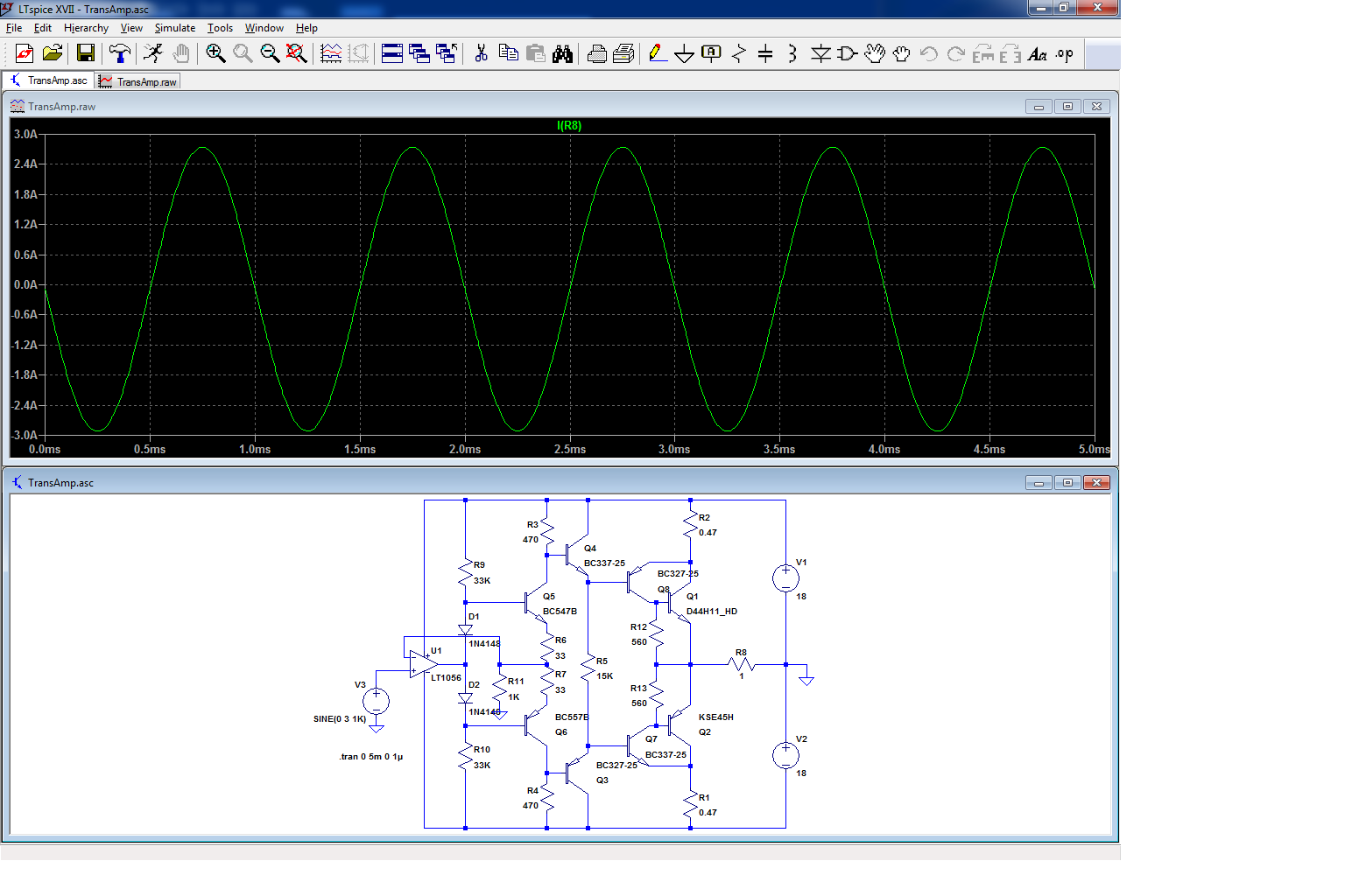

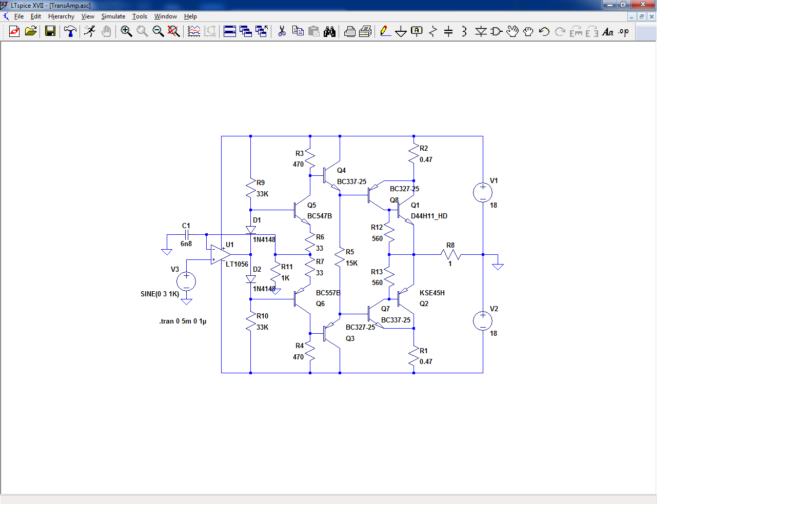

My modelling is far from perfect, and the transamp is not an idealized Spice component:
The OP transistors are 2N3055/2N3792 and the drivers BD131/132.
As I was aware that the servo loop was not going to work as easily, I included a number of mods:
I included a loop gain trimmer, and a damping network across the drive coil.
With these mods, the nogausser worked at very low gains: as soon as the wiper of the gain pot left its end stop, the amplitude of the error signal seen at the output was laminated, but pushing the gain higher lead to ~50 KHz oscillations.
I used a phase-advance cap (C1) to make the transamp more ideal, and I was able to push the gain to its maximum, without instability.
The results are impressive.

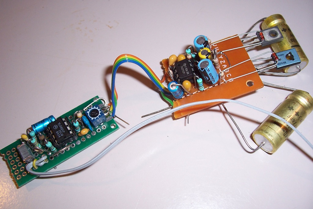

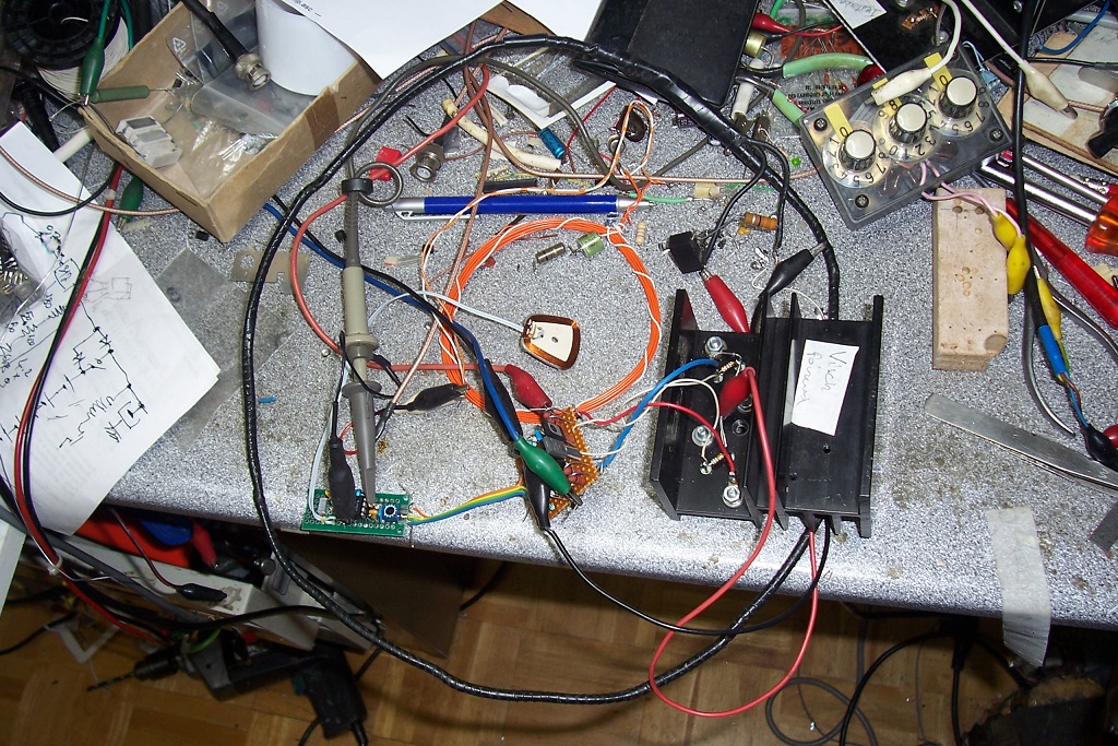

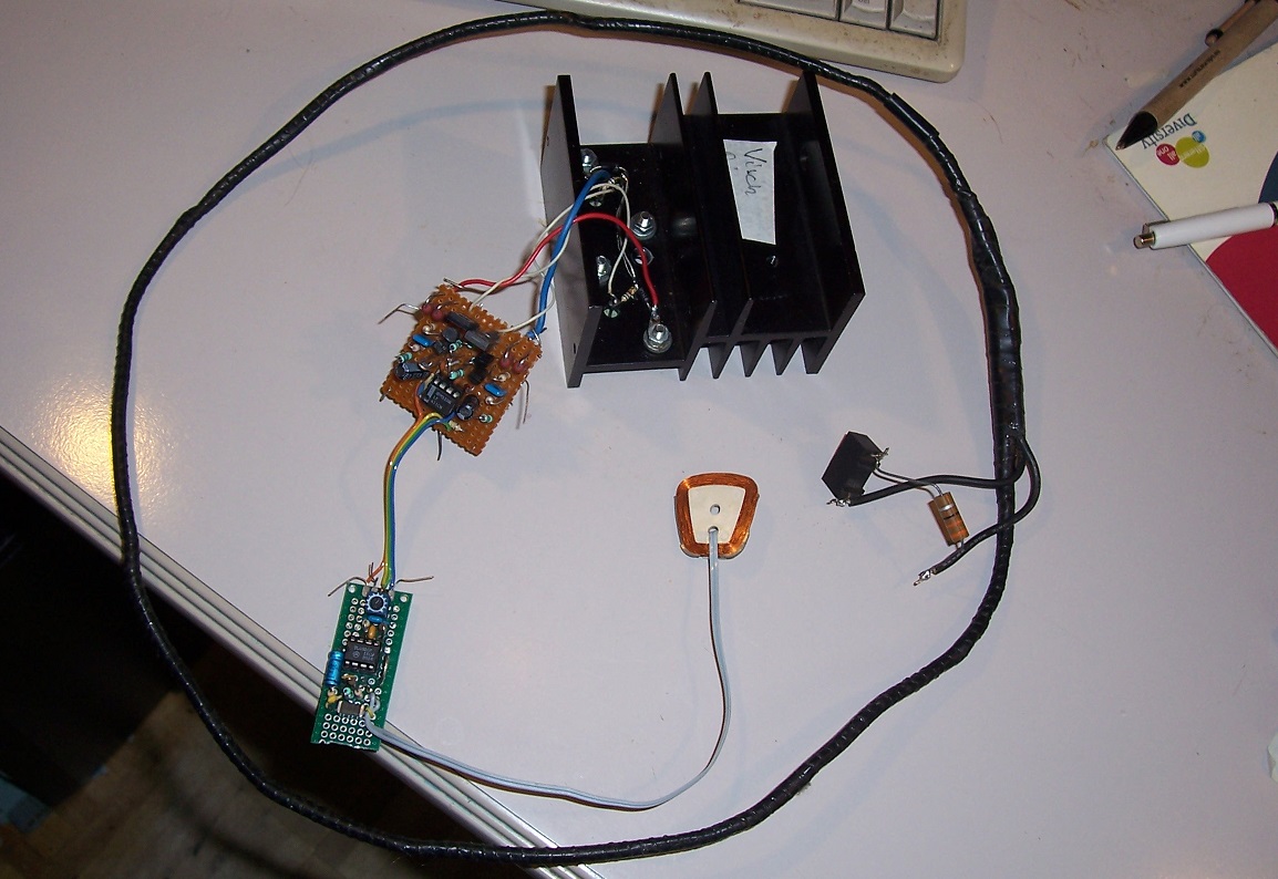

Here is the actual setup, on my test bench (messy):

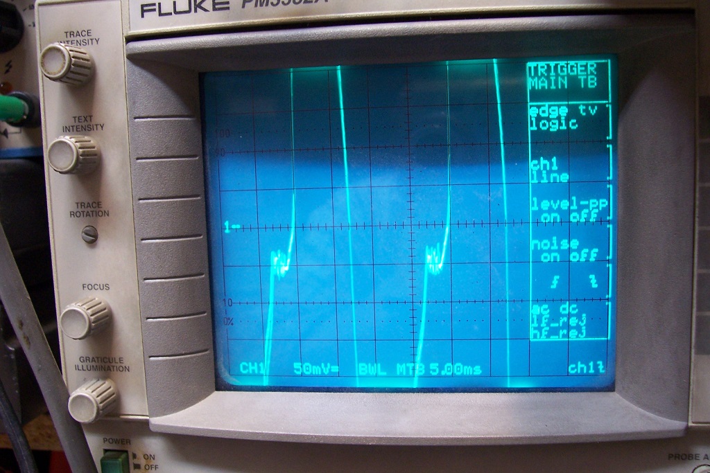

This is the signal at the output of the correction amplifier, with the transamp inactive (they are the stray field of my bench heavily amplified):

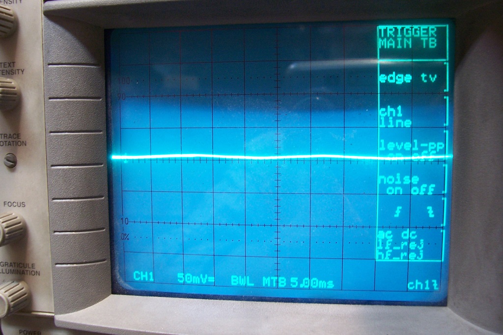

When the loop is closed, the signal looks like that (no cheat!):
So, the circuit does wonders

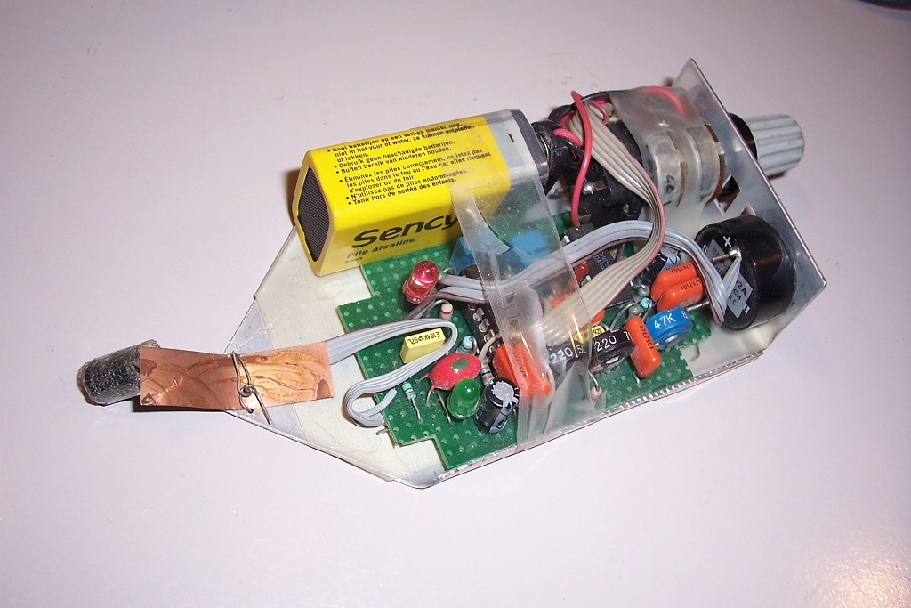

In addition, 50Hz fields are present almost everywhere: some years ago, I built a small, crude 50Hz mag field detector, and I had the surprise of being able to detect a HV power line more than half a mile away:

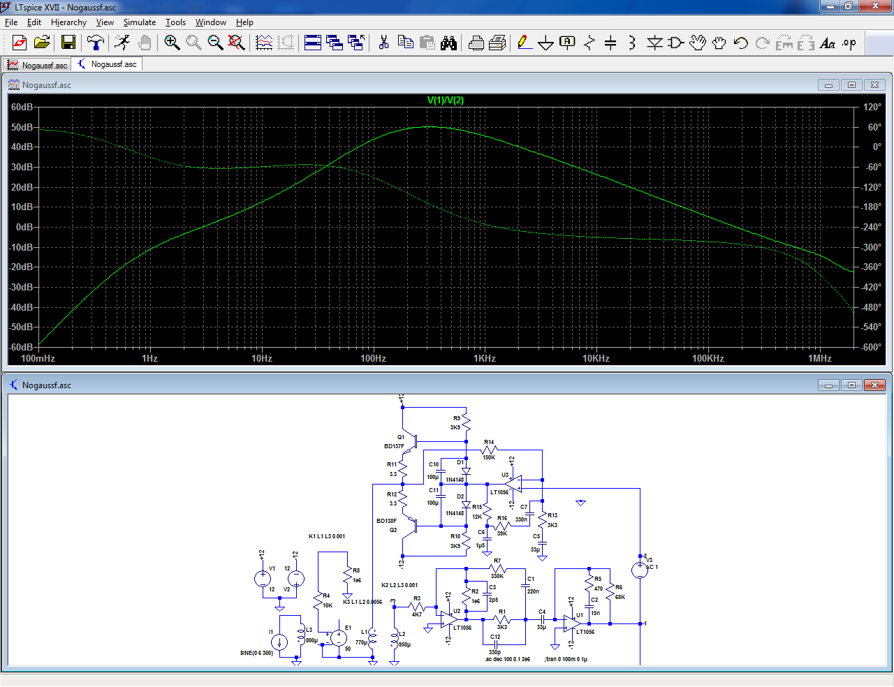

I have now streamlined the conditioning circuit, in particular the output amp which is now a simple, buffered voltage amplifier.
The power level is much more reasonable, but is still vast overkill for correction in a quiet lab environment.
In fact, just the unbuffered opamp would probably be sufficient.
The maximum loop gain has been reduced to 50dB, which is more than sufficient.
The voltage, rather than transamp amplifier inherently solves the requirement for integration.
As a result, the HF noise has been reduced, but not completely eliminated.
This was disconcerting, especially since the gain trimmer I inserted had practically no effect until it was turned down to zero.
In fact, the magnetic closed-loop system works to compensate the input noise of the front-end amplifier.
The sensor coil is so inefficient that its output with the stray fields to correct is not very much larger than the opamp's noise, leading to a poor S/N ratio.
The HF part of the gain is mostly useless in this application (correction of 50Hz and harmonics), but without elaborate compensation techniques, the gain slope needs to be 6dB/octave, starting from ~150 to 300Hz, and this allows a lot of HF noise to break in until the unity gain is reached at 180kHz.
I have tried low-noise opamps, and it improved the situation by 6~10dB, but the real solution is to opt for a more suitable sensor: more turns, and an increased area to improve the coupling and the gain.

The real remedy to the noise problem is to use a more suitable sensor coil, but I made a few simple mods to the conditioning circuit, to reduce the gain at frequencies where it is not needed.
Thanks to a second order shaping, the unity gain frequency is now ~6kHz (it was 180kHz in the previous version), and the maximum gain has barely decreased, to 45dB (and it is more accurately centered on the 50Hz~100Hz range).
If a low-noise opamp is used in U2, these mods make the circuit actually usable, but it would be simpler to use a 10mH sensor.
The drive coil could also be upgraded, as it has relatively a low time-constant creating a pole at 500Hz.
This makes the equalization to locate the gain maximum at ~50Hz difficult.
Using three times the quantity of copper would make life much easier.

It is of course difficult to make magnetic fields change quickly, but that's accounted for in the differential equations, and it is much less problematic than a pure delay.
In fact, the demonstrator I improvised works exactly as expected (like the sim). Of course, I took care to measure all the constants accurately, but once it was done, it worked perfectly (except for the noise, but this is just a dimensioning/practical problem that can be solved relatively easily).
As for the speed, the first version had a bandwidth of 200kHz, but that was vastly excessive for this application in mind and posed problems, but in case it would be needed, it would be perfectly usable, for example in the vicinity of a HF heating system, and the wideband noise would not be a problem.
The current version creates a smallish zone of perfect "magnetic silence" in the vicinity of the sensor coil, for a frequency range of 20Hz to 2KHz.
The size of the silenced zone could be increased with larger coils in a Helmhotz configuration, but the principle and the electronics would remain identical, and all this is based on sound, well-studied theories so there is no obstacle there.
What remains to be perfected are the practicalities: for example, the sensor. A coil is simple and cheap, but is not very efficient and creates unwelcome poles in the frequency response.
Commercial systems use DC-capable sensors.
Agreed, any closed-loop system will always have some residual error, and the magnitude of this error will depend on the gain available, which in turn depends on factors like delay in the loop, but all of that is well known, theorized, and works well in practice.
Acoustics is more difficult, precisely because delays are very large compared to electronic circuits (and other reasons too), but magnetic fields are part of EM waves and travel at the speed of light.

Here is how I see this (potential) project:
I have no intention of building a full, 3-axis 9-coil version, capable of eliminating any parasitic field in a significant volume: it wouldn't be that complicated, because the three electronic channels can be made simply and cheaply (an opamp could in fact drive the coils directly), and the nine coils represent a pound or two of copper at most. Nothing extravagant thus, but the whole assembly would be large and cumbersome: not really practical unless you have a real need for it (and enough room to accommodate it).
I will try a single channel, non-Helmhotz version with easily movable coils.
I would first open the servo loop, and look for the average magnetic vector direction by seeking a maximum of 50Hz signal at the output of the conditioning amplifier.
I would fix the sensor coil in that position, and approximately align the driver coil in the same direction; accuracy is not needed, because it is a closed loop system, and the loop can tolerate large parameter variations.
I would then restore the FB loop, and the 50Hz field would be cancelled completely in the vicinity of the sensor.
For the harmonics, the situation would be somewhat more complex, because the relative phase of the harmonics would not necessarily be the same for all the perturbation sources (in a real environment, there will be a number of them).
This means that the vectors of the 100Hz, 150Hz, etc. will not be aligned with the coils, unlike 50Hz, and some uncorrectable errors would remain, but having the fundamental cancelled and the harmonics attenuated in a limited space would be better than nothing and could gain a few precious dB for a very limited investment in time, material and effort.
