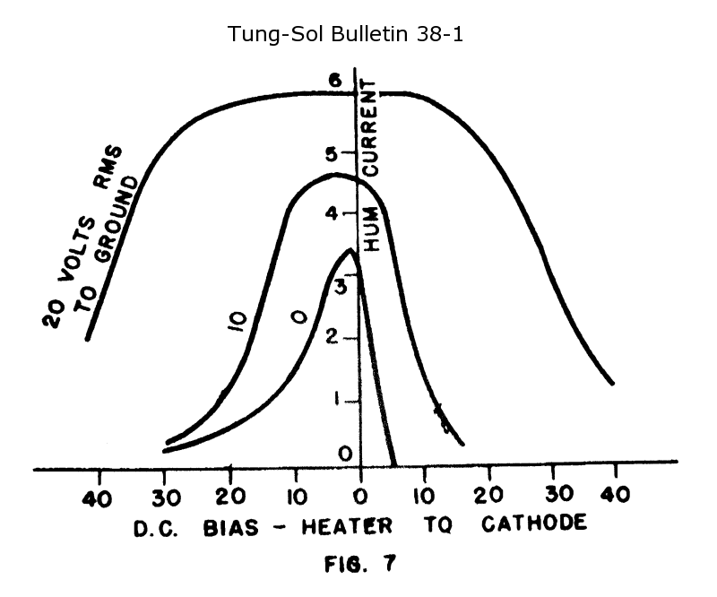

fascinating.
I was particularly interested to read that "Heaters should not be operated above rated voltage, as hum doubles with a 6% increase in heater voltage". Leaves me wondering if hum halves for a 6% reduction in heater voltage.
Anyhow, what we already knew "Hum can be reduced to a negligible value by use of sufficient bias between heater and cathode to prevent the net voltage reversing."
