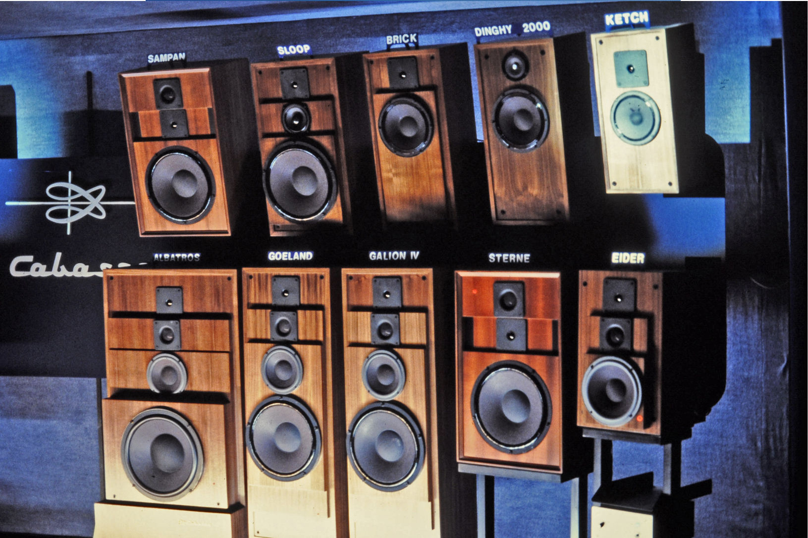

Cabasse was known to be "analytical", in other words too much brightness, at leat in the 90's with the SCS series (iroise 500 for example).
The Rotel is probably not the culprit.
My 2 cts
ThX for the input.
The models from the nineties do have that and that's why they pair well with tube amps.
The Cabasse Murano is totally different in that aspect.
The problem is that the speakers are too revealing and revealing the flaws of the preamp.
And the Rotel RC-971 (all RC-970-980 series) is known for harshness (especially whith higher volumes).
