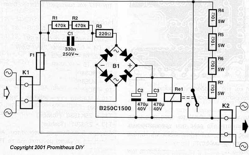

Soft start...
A soft start circuit as attached is very useful if you have high value caps in the
power supply.
See the below site for some more on this circuit.
http://mitglied.multimania.de/Promitheus/delay_circuit_for_toroids.htm
Roushon
