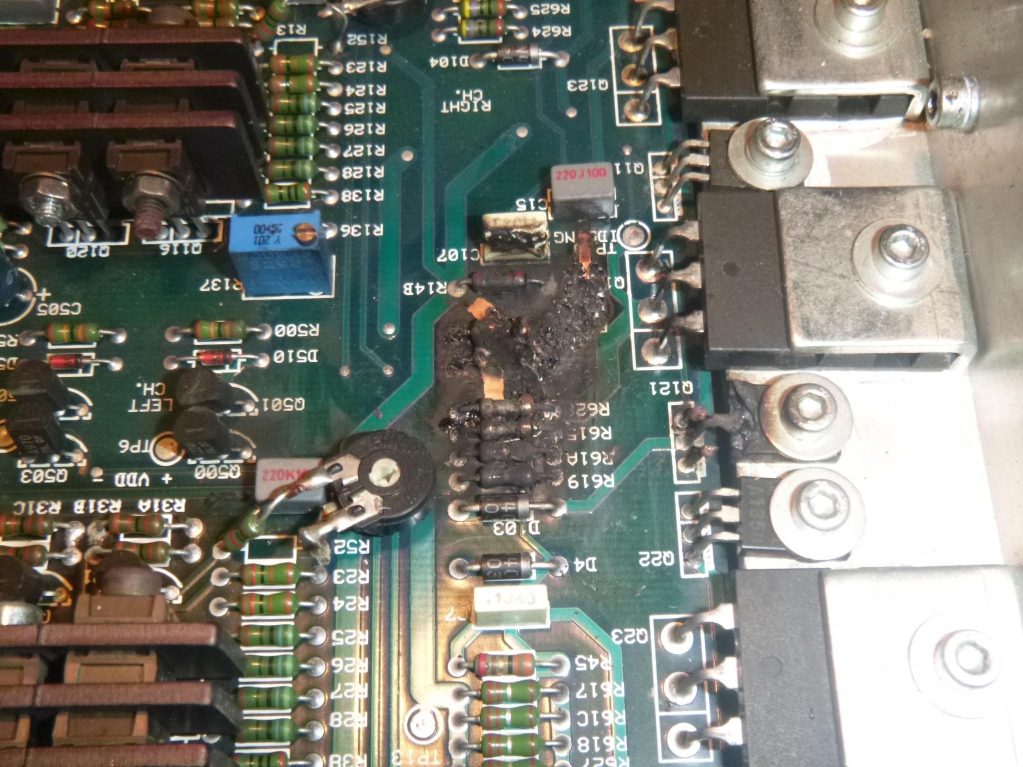

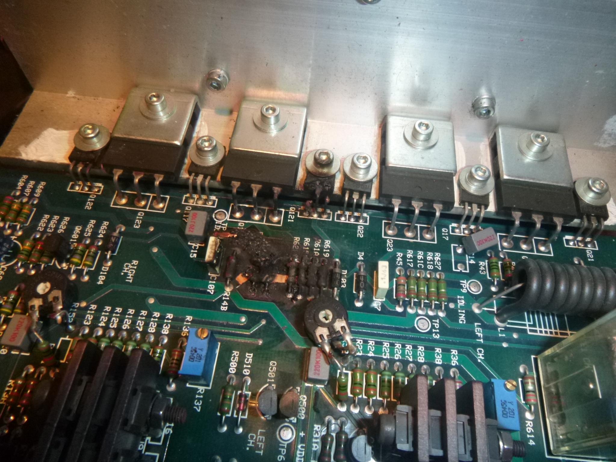

I'm servicing an ECI-4 that was shipped to me for repair from across the US.
Q22, Q21, Q17, Q23, and Q24 are shorted and have leads melted. Those I can replace, but there are a couple of resistors that are burnt beyond recognition and I need to find out the values thereof.
I wrote to Electrocompaniet with a Norwegian translation, requesting schematic, but in over a week have not heard back.
Has anyone had any breakthroughs?
