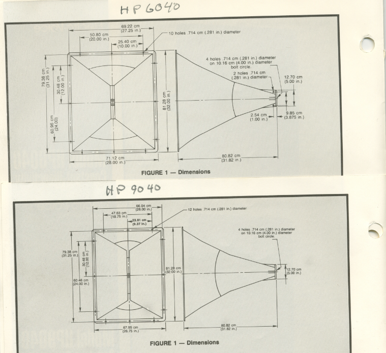

this is a rather simple issue- I am trying to find out some specific measurements for these EV CD mantaray-style horns.
Could anyone owning or having access to one of these accurately measure the width and height of the slim vertical mouth-entry slit as seen from the front?
I know both are different.
Thanks so much! 🙂

You can get the data sheet online. There dimension on it. Or are you looking for more specific numbers?
well yeah, I am looking for rather specific numbers like I stated above. the datasheet is meant for installers and has mostly unclear dimensions except for the numbers that matter when installing these units. I can't believe there is no actual owner of these horns on here- It'd be greatly appreciated, thanks so much!

The diffraction slot is around an inch wide on both horns, the vertical arc measurement is fairly accurate and can be scaled from the drawings.
If you are planning to duplicate the horns, the dimensions you ask for are just a start, there are nifty little vanes in the transition area from round throat to the rectangular radial diffraction slot.

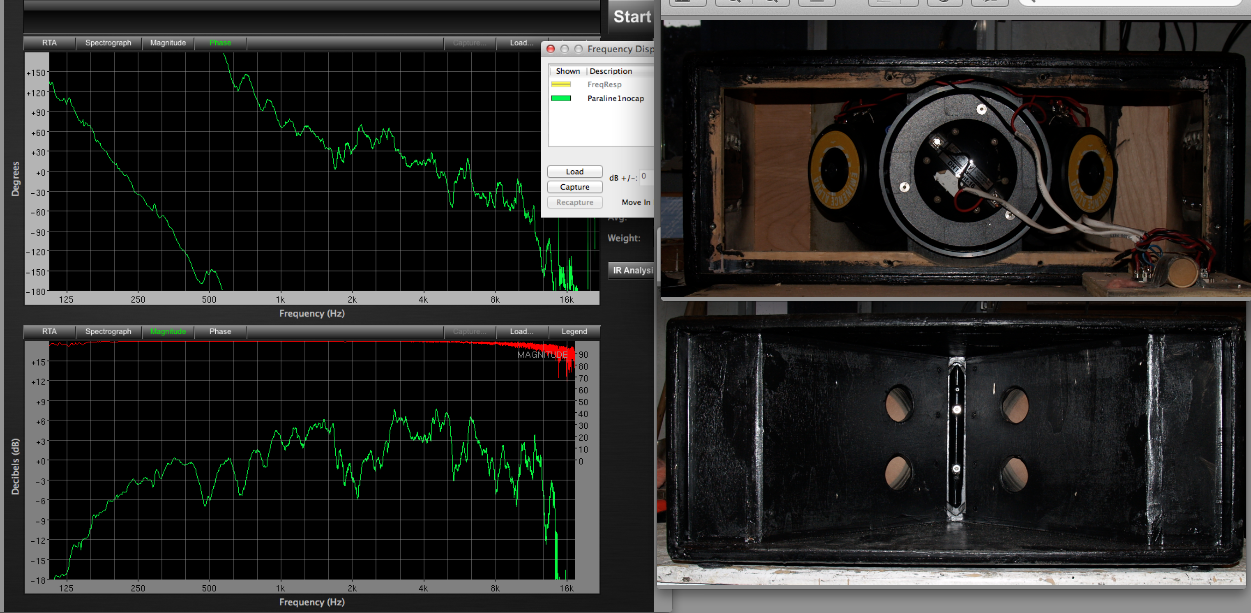

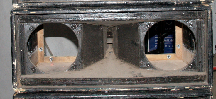

My current PA involved trashing the diffraction horns I previously had built which were similar in concept to the EV HP horns.
I had become dissatisfied with the vertical interaction (comb filter cancellation) between the horns, and an off axis "suckout" in the crossover region caused by the center to center distance between the HF and mid cones.
I have made many conical HF horns, they are fairly easy to make, have defined pattern control, and very little diffraction.
Fairing the throat like Hughe's Quadratic throat does make a difference, but requires a lot of hand filing.
Throat driven conical horns don't load all that well down to 500 Hz though, which is why I recommend the Synergy concept.
From an assembly and time standpoint, you can make a Synergy almost as fast as a conical HF horn only.
My current PA uses Paraline conical horns, but they are far more complicated to build, and not as smooth as a standard conical horn.
Better for line array use though, and they do load down well below 500 Hz with the DH1AMT. The chart is of the HF driver only, with the 8" speakers the cabinet crosses over to the lows at 100Hz.
Using the same components in the same (exterior) box, the difference between the old design and the Paraline was rather amazing, for the first time I could get the PA to sound as good as headphones, consistent over the 90 degree coverage pattern.
