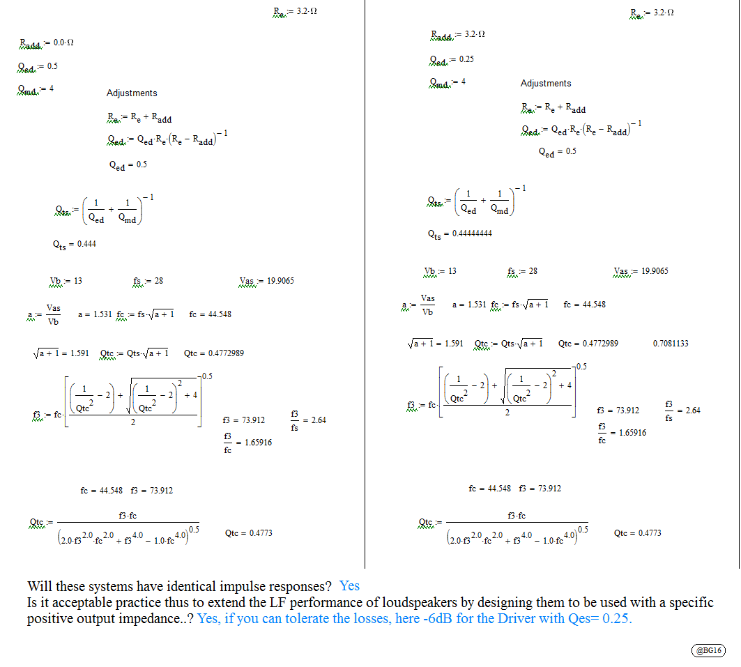

Thank you, Ron. Let me refine my question. Suppose I have a driver with a Qms of 4.0, a Qes of 0.5, an fs of 28 Hz, and a Vas of 20 liters. It will have a Butterworth frequency response with an f-3 of 46.5 Hz in a box of 13 liters.
Now suppose I have another driver, with the same parameters as above save it has a Qes of 0.25. By inserting a certain series resistance, or by using an amplifier with the corresponding output impedance, one can double this Qes and make it 0.5—equal to that of the first driver. With this setup, and in the same 13-liter box, the second driver will have the same Butterworth FR with an f-3 of 46.5 Hz.
Will these systems have identical impulse responses? Is it acceptable practice thus to extend the LF performance of loudspeakers by designing them to be used with a specific positive output impedance, regardless of the mid- and high-frequency effects due to the increasing Z, that is?

Same frequency response = same impulse response.
There is no gotcha from increased output impedance, other than reduced sensitivity.

Thank you, Ron and bjorno, for your answers. If the impulse and frequency responses mutually determine each other, what about the transient response?
Is the sensitivity loss caused by the higher compliance of the acoustic suspension, and if so, is this loss uniform across the whole frequency range or only in the region of piston-like operation, i.e. below the break-up frequency?

Define "transient response". In the sense of how it is affected by T/S parameters, the only thing that matters is the area below ~200Hz.
Yeah. A rather vague term to characterize how closely the sound pressure produced by the loudspeaker tracks the incoming electrical signal.
Sensitivity loss is created by the loss of signal in series resistor
