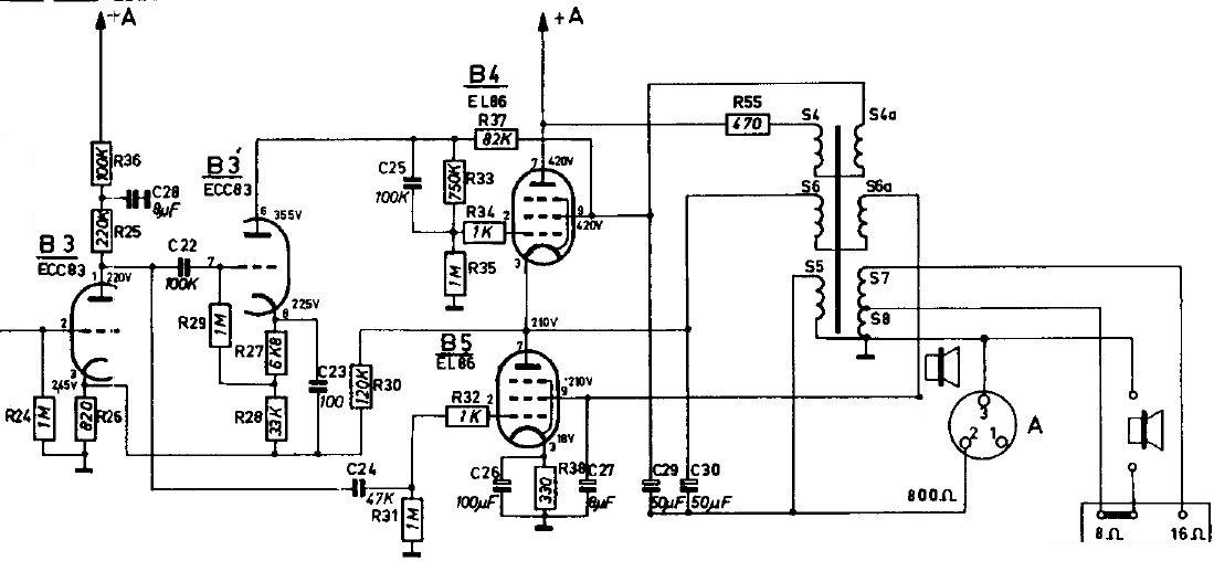

> a philips amp with 4 EL86's and a speaker - 800ohms
Put the speaker drivers in "stylish" cabinets with a grille-cloth of your wife's fancy. Or put slip-covers on them when not in use.
That is a rare amp. One of the very few OTL (Output Transformer-Less) commercial amps ever sold. Futterman fans go to a lot of trouble to do what Philips did. It works only because of the hi-Z speakers; but many of them failed due to the very thin wire needed to wind them.

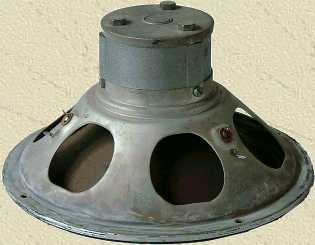

They are also probably some of the best $1 speakers ever made. The 1950s were full of junk, but also some very good stuff that didn't "look exotic".

I could give you all sorts of pseudo-technical baloney, but the plain fact of the matter is that with an 800 Ohm impedance, even bell wire is massively thick. I doubt very much that you could do anything with the loudspeaker wire to make an audible difference. Grille material, now that's another matter entirely...
use a opt
Some of the vintage 800 ohm amps of Philips also had a outputtransformer on board. I saw one a few days ago on Ëbay.
Go transformer hunting I would say
Re: use a opt
Some had OPTs (when used with EL84) but the EL86s (a pr used in an SRPP-like configuration) used a choke.

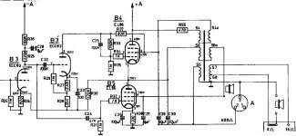

that is right
It is a very special dutch choke
http://frank.pocnet.net/instruments/Philips/AG9015/AG9015.pdf
I have one of those Philips EL86 amps and the speakers that go with it - very remarkable perrformance - so open & transparent, especially on vocals.
I'm amazed it works at all with low-Z loudspeakers.
The Philips 800 Ohm 9710M (the ones in my speakers) have an unusually wide response too. Discarding them is just plain nuts! One of the BEST aspects of mine is the beautiful 2-tone stained wooden cabinet, and its white grille. Prettier than almost any other speaker around.

yes this speakers and amps philips are beautifull
I construct some amps for guitar oriented whitout output transformer, direct output, and this for hifi or guitar are big's amps.
An the speakers only beautifuls and more, big response, big tone, hight full band, ...
I not have leters for descriptin this and sorprese my first time i construct this.
Have some persons more info or know the data of this bobine for the mode 8-16 ohms in the scheme of philips, characteristics of bobines, ¿Mh, ohms, etc?
The how connect standar speakers 4,8,16 ohm, whithout transformer of audio, at one OTL is very complex, can write one book only of this. The formule of philips whit bobine or inductance i think is one plus an acertate, but i not be how this affectate at de signal/ histeresis+etc, i see in the scheme one inductance whitout ferro/ histeresis, and other whit this for the 8/16 ohm output.
Some people here know this circuit or scheme of long or full?

The Hammond 119DA impedence matching transformer (12W) has a 600 ohm primary and 4/8 ohm secondary. It is often used to connect Philips high impedence amplifiers to modern speakers. I guess that a 6 ohm speaker connected to the 4 ohm secondary will be just fine.
If this is an OTL amp, and you are Forced to get rid of the 800 Ohm speaker,
you can easily change from an OTL to a transformer output.
Get a low impedance Push Pull output transformer that matches to 8 Ohms for the new speaker that pleases the lady.
800 Ohms is a little low for medium watt push pull transformers, but there is a trick.
Take a 3200 plate to plate transformer, and use one end of the primary to the center tap (half of the primary). Now, it is operating as a 800 Ohm primary (Z is proportional to N squared).

In this scheme the transformer of 800 ohms can see more how inductances or choke tansform of two poles, not?
Can this are inductances?, Values?,
Or references de one product similar?
Uffff if this are inductances of 800 to 8 and 16 oms, ...is good
I read in theory of acoplate by inductances in some OTL , but have today poor and short info of this.
Some more info?
