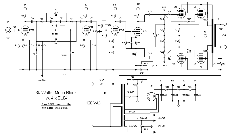

Thanks guys...I can live with 22 watts, 25 was just a design goal!! On the other hadn I found the attached schematic for 4x EL84 driving into 35 watts at 0.5% THD.
The valves are V1,V2 = ECC83, V3,V4,V5,V6 = EL84, V7 = GZ34 power supply 300VAC on the secondary, the only thing not on the parts list is the output transformer. However, as this is very clsoe to the other designs, how much trouble could I get into using the Bevois Vally spec for a output xformer??
Looks like back to Morgan Jones for another read...
I would cut out everything before P3, the tone controls, but thats just me.

4 x EL84 PSU, and Output XT, did I get this right??
Hi all, working up the PSU design for a 4xEL84 PP...
Based on the attached schematic (and PSUD2) the current design as a GZ34 half wave with 300VAC, which if I am right, is producing about 370 for B1.
If I want to replace this with solid state full rectificaiton, then by PSUD2, I would need about 275VAC from the power xformer.
Did I get this right??
Also, no spec on the output transformer on this schematic. Any suggestions on the specs of what I should be looking for to drive 8R??
