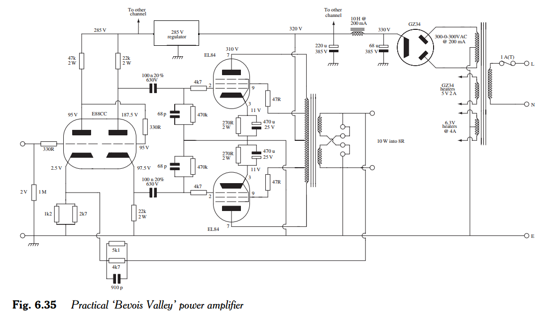

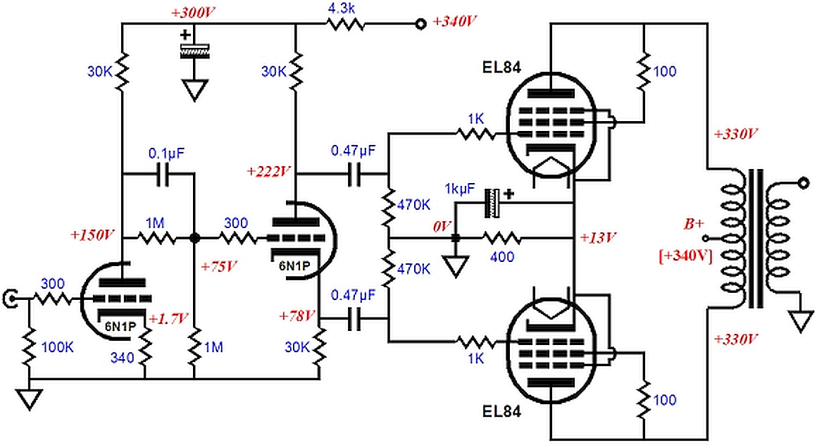

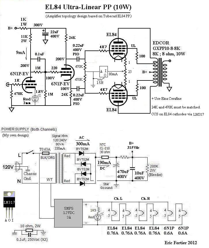

Thanks Chris,
I have had my mind on building the John Broskie 6BQ6 amp below for some time, considering your points I will plan on a "xBQ5" PP amp instead of jumping into a PSET. But I do have several 6, 8 and 10 volt NOS tubes in my stash for 6BQ5, so I'd like to devise a way to use that 25 watt dropping resistor trick and AC over-voltage to allow all-of-the-same-voltage to simply be plugged in and arrive at the correct heater voltage.
Here is the original Broskie triode strapped article and a DIY'er modification of the same article for ultralinear and CCS: This will be point to point so I can do my own mods easily. The third schematic is a similar circuit by Morgan Jones using a regulated supply for the input tube, which is something I'd like to add probably after it's all working on the same unregulated B+ and I know what voltages are there.
