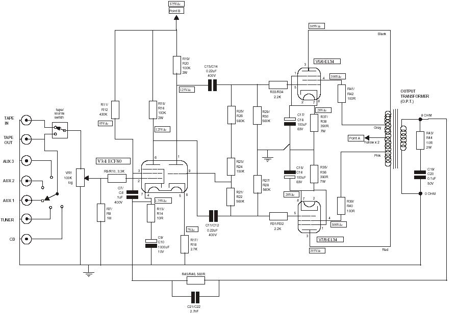

I hate that sort of phase splitter, but the circuit will probably work OK. If you up the B+ to 420-450V, use a 6600 ohm p-p output transformer, and adjust the cathode resistor values on the output tube, you should be able to get 40 watts easily.

FWIW, I think SY made a good point about that phase splitter. The splitter topologies that are currently viewed with favor are the "concertina" and the differential.

I have an old Scott 272 " Dynaural laboratory amplifier". It's schematic looks the same as yours. This was the amplifier that got me back into building tube amps. I wanted to experiment, but did not want to mess up this rare amp, so I cloned it. The clone sounded almost as good as the original (cheaper transformers). The first thing that I changed was the phase splitter because the one shown is very hard to balance over the entire audio range.

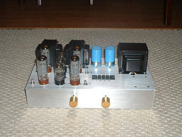

I just purchased this integrated .It is using a marantz 8b circuit and fisher 400 transformers.The guy that built it did a very fine job.
The rca's on top are for biasing.The amp has 4 inputs on the back with iec.
Wired for 20 wts triode and sounds great!
SY said:Roger, nice score!
I also purchased some Siemens EL 34 tubes that will be in today.The Svetlana's that came with the amp already sound good.The amp also came with some nice tung-sol 6sn7 gtb tubes.
I have been listening to digital amps for awhile--it is a nice change to come back to tubes.
