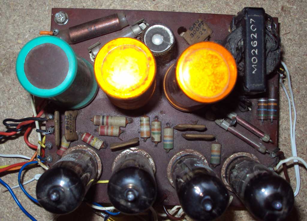

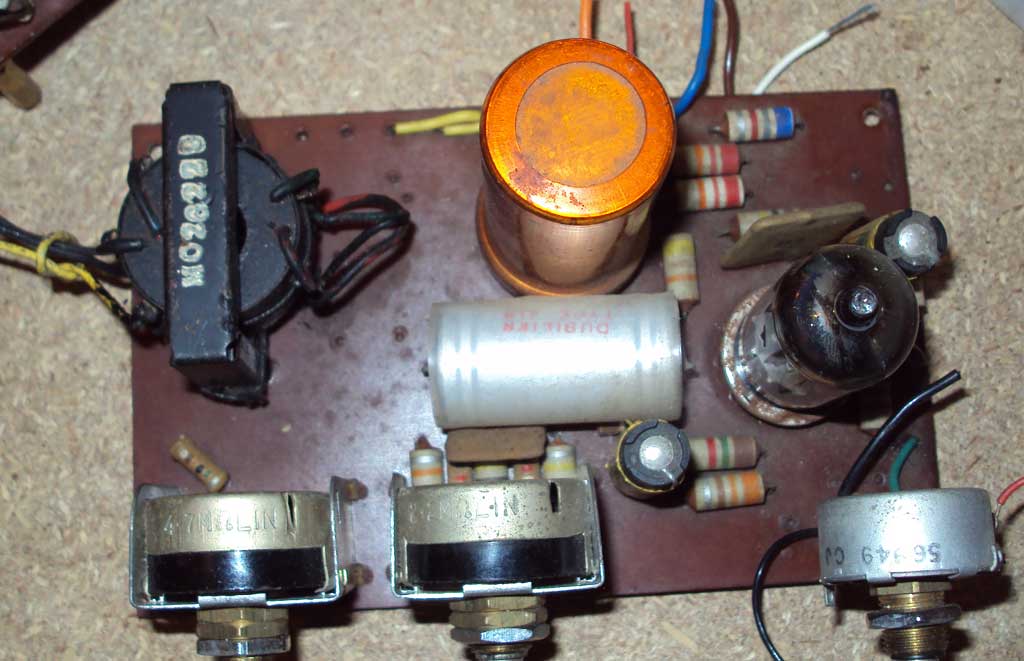

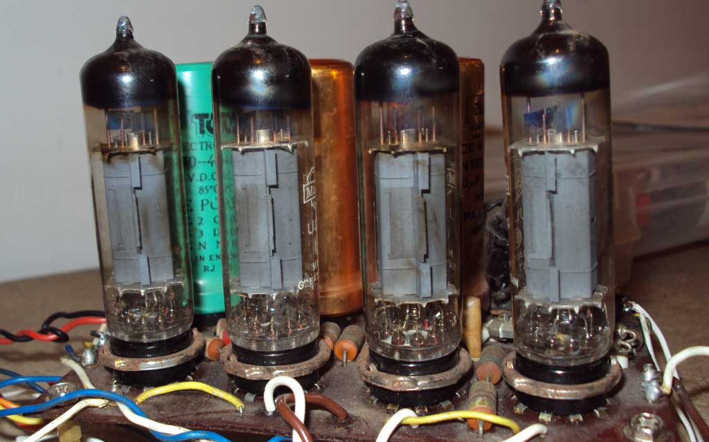

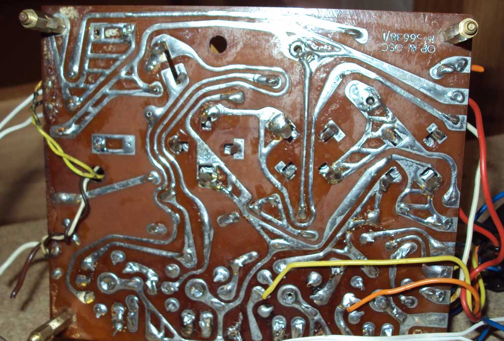

Just one error I need to correct. It is UL84 tubes and not EL84 as per the heading. I also manage to carefully cleaned the caps and reveal the capacitance.It is 60uF 300V(2 of them) and 40uF 350V (one of them) Finally pics. Unfortunately I do not have any schematics of the amp, but it looks like a very straight forward circuit.
Let me know if you need more angles.

Wow, those are some crazy photos.......reminds me of the 60's......check "preserve aspect ratio" when resizing your pics...
The cap in question sounds like it is a power supply cap, and based on the age of the amp, it's probably not a bad idea to replace all of the electrolytic caps. You can add capacitance in the PS to reduce ripple and provide stiffness, but if you have a tube rectifier you'll need to be careful not to bust it's specs for the first cap value. Back in the day large value high voltage caps were rarer then hen's teeth. It may be worthwhile (and a good education) to draw a schematic of the PS.

If is UL84 then it is almost certain to be an AC/DC live chassis circuit. These are dangerous, and cannot be used safely except for their original purpose in their original case. Even then they will not meet modern safety standards. I strongly suggest you proceed with caution. You cannot use such a circuit as a general purpose amplifier.
Sorry about the size.This is my first photo post on this forum.
You guys inspired me now to draw a schematic from this amp and re-build it with new parts, except for the tubes of course.I've got basic knowledge of Eagle layout editor and will be using this as a tool to reconstruct the schematic.It sounds like I have to us a different alternative to re-construct the amp as the current design is a bit on the dangerous side.(safety first!) My general feeling based on my reading of various manuals and posts is to use a wiring layout as opposed to a pc board to get good sound quality and a safer design.

UL84 tend to be much rarer than EL84, but also less demanded so the price is not so high. Actually, I can't remember whether the UL84 is like the EL84 or the PL84/EL86.
