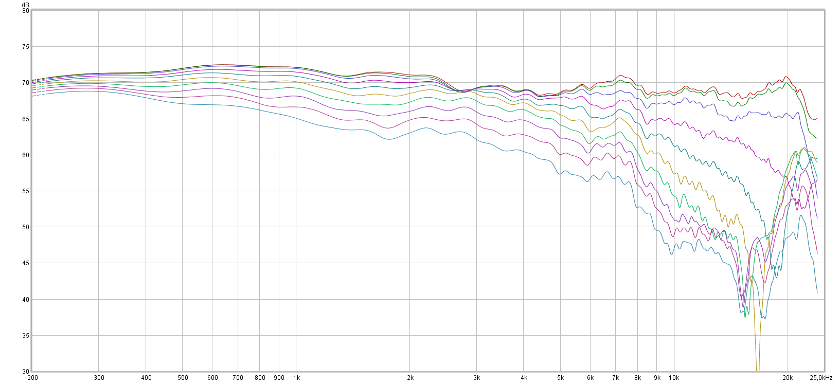

I wouldn’t place my bets on such an expensive speaker without decent polar measurements. All the same, you can observe that the 7741 might have a DI discontinuity at 5kHz. Which should not surprise one, Troels seems to have picked the HF crossover just below 5kHz and even a 4” mid starts to beam eventually.
So what I see is yet another (expensive!) exercise that might perform well on a lot of aspects, but not on the one we find to be important nowadays. Room interaction. Did you look any further for other designs?
Ekta Grande XT25, 0-90deg, common mic position measurement with mic distance 1m, at the height between tweeter and the mid. This is measurement of my pair which was my very first diy project.

Worlds apart. What is it with this obsession for expensive parts while real important stuff is neglected? And why would one put a speaker designed for a free position (full baffle step correction, broad dispersion) with the back against a wall? Sorry if I step on toes, don’t want to stop people spending on their dreams. But at least have a hunch there is actually a proven approach.

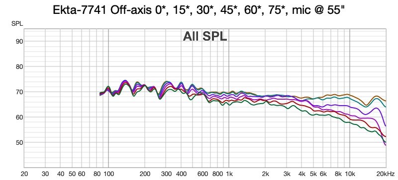

This is an older thread but I thought I would update it with relevant data since archived discussions often get searched by those digging deeper for information.
My measurements show a fairly uniform off-axis performance of the Ekta 7741. The actual mid-range/ tweeter crossover is in the 4kHz region.
