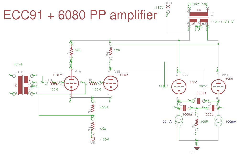

I would second SY's opinion about the use of an input transformer as a better option. I have attached a schematic which shows that it is possible to make a two stage amp without caps in the signal path, to give you pause for alternative approaches.
