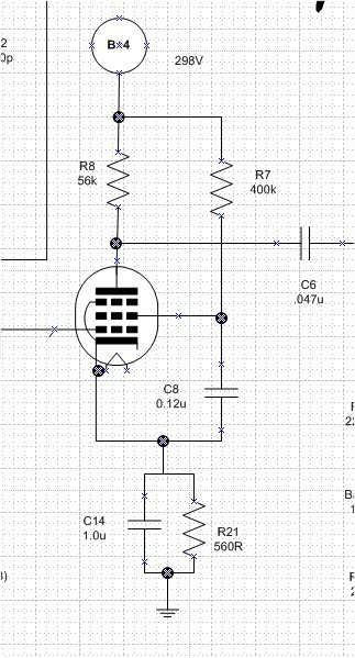

Just stumbled across this old thread . . .
Built an amp using an EF86 in the preamp, and since I had an extra hole in the chassis, and an extra EF80 laying around, I wired up an extra socket in parallel, correcting the appropriate pins, and tried comparing the circuit alternating the tubes -- both sound fine -- just did it for a few seconds, and haven't taken any measurements yet.
I'm attaching the relevant. circuit segment.
Does this look as if it will damage either the tube or any other components?
Joe
In the long run you risk cathode interface problems, as Tubes4e4 said. You are also likely to be getting significantly more noise and distortion than an EF80 is capable of in the correct circuit. EF80 and EF86 are simply very different valves: they are both pentodes, both use B9A base and both have 6.3V heater but apart from that they are very different.
FWIW -- I built parallel tube sockets in my prototyping chassis so I could interchange EF80 and EF86 tubes, and the EF80 sounds great, despite not having adjusted the cathode and grid resistors to more appropriate values. AND, I have it in a TINY high-power combo - - - 2XEL34 in a box smaller than a Fender Champ, and no issues with microphonics so far. It has a bit more gain than the EF86 (u 50 vs. 38, if memory serves) but also seems to have a more complex tone to my ears.
I will probably put a switch in so I can reconfigure a single socket to work with either one.
Joe
