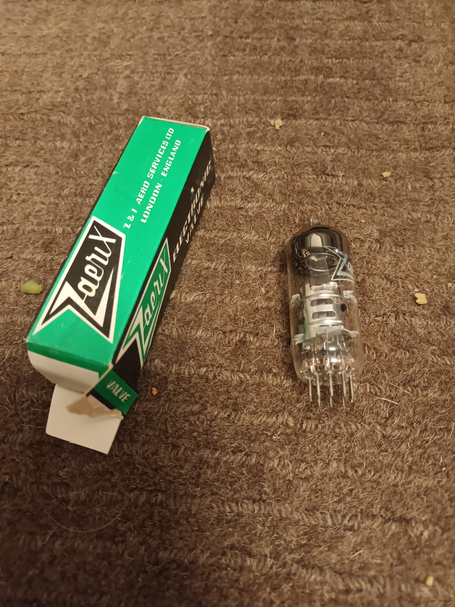

EF80/6BX6 glow on power up
I got these on ebay for an IF strip to replace 6EJ7's which had too much gain and lead to instability. They look nothing like a EF80 internally and don't look ever used. They work perfectly! Thing is when you first power them on you get an incandescent glow from the bottom of the tube which disappears about 2s as the heaters warm up. I've not seen this before is it some sort of heater protection?
https://www.worldradiohistory.com/h...less-IDX/IDX/70s/PW-1972-03-OCR-Page-0090.pdf
pl802 interesting. I assumed the outside was the plate buts its a screen. That's why I get instability if I put my finger near the bottom of the limiter tube where the plate wires are exposed and not the middle where's there a screen. I guess that's normal practise with IF tubes.
