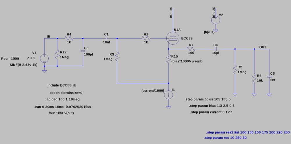

I am struggling a little with this schematic, something is wrong with the schematic (or the model) below and I cant figure out what.

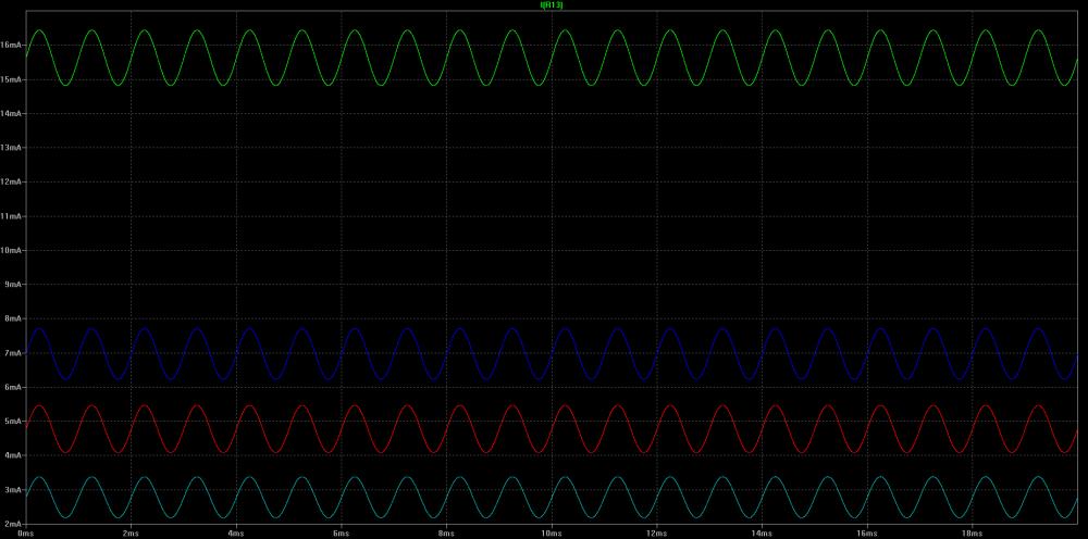

When I increase the R10 using the res variable, as R10 increases, the quotient current starts dropping, not a little but a lot. With values of R10 = 10R - 15ma; 250R - 7ma; 470R - 4.8ma, 1k - 2.7ma. Of course due to this, the distortion numbers also go worse as R10 rises. Vgk rises correctly though as R10 rises.

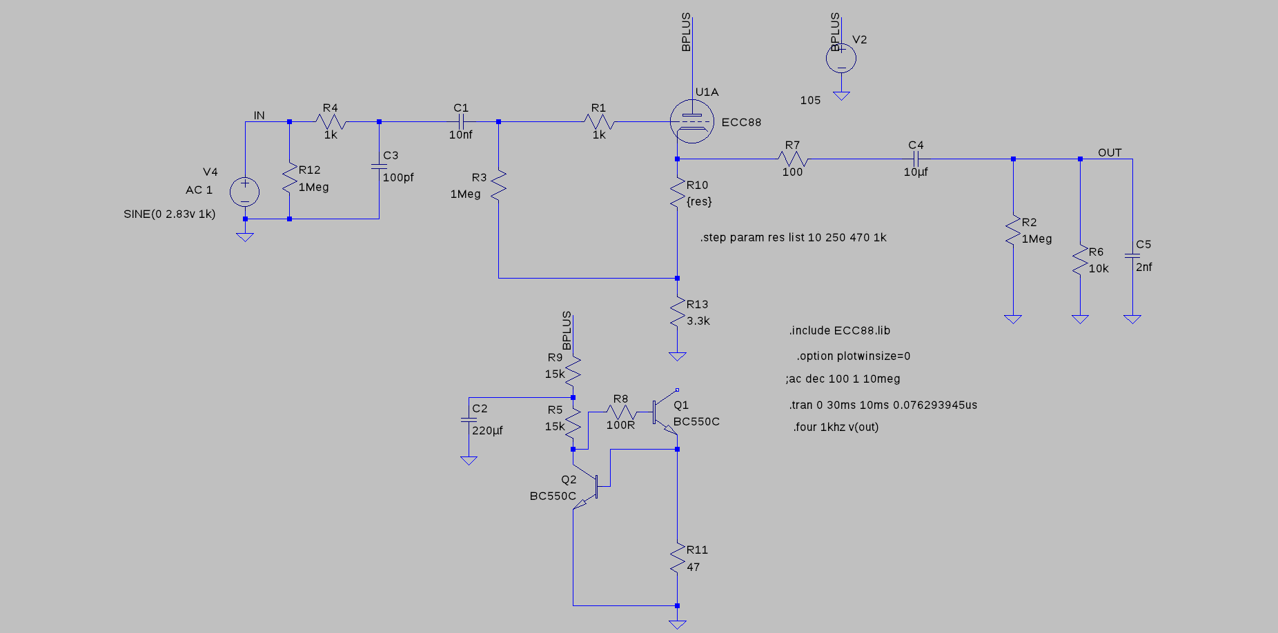

The current calculations also don't look correct, with 3.3k and 105v supply, I should get about 31ma, but I get half of that, about 15ma. It looks like R13 is not controlling the current, but R10 is. Reducing R13 drastically doesn't seem to increase the current in proportion, R10 = 470 and R13 = 1k gives about 5ma of current.
The tube model is the ayumi model, I took it from this link (second last post) - http://www.diyaudio.com/forums/tubes-valves/243950-vacuum-tube-spice-models-40.html#post3863379

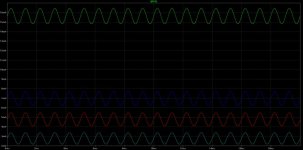

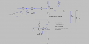

No, you should get about 15mA with zero bias, because the internal beam resistance of the ECC88 is about 3.3k.The current calculations also don't look correct, with 3.3k and 105v supply, I should get about 31ma, but I get half of that, about 15ma.
Correct. That is how it is supposed to be. You need to learn to draw load lines.... For example, with R10 = 470R:It looks like R13 is not controlling the current, but R10 is.
Your HT is 105V so you probably want to aim for about 50V at the cathode. With R13 at 3.3K that gives a cathode current of about 15mA. YOu palt/cathode voltage is about 55V. Looking at the datasheet, 15mA plate current at 55V plate.cathode voltage require a grid voltage of close to zero. If you change R13 to 6.8K the cathode current becomes 7.5mA which requires a grid voltage of about 1V which you should get with R10 set to about 110 ohms.

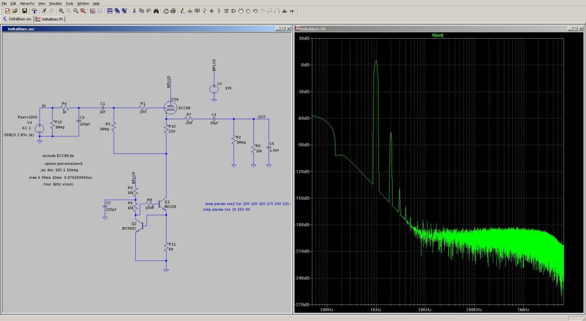

[FONT=Courier New, monospace]Thanks guys, that helped clarify a lot of things. I am yet to get a transformer, so the B+ is not fixed yet. I plan to use a 110v step down transformer with a shunt regulated supply, so I would say that a max B+ of about 130-135v. Though if I get a lot better results with higher voltage, I wont mind going for it.
[/FONT][FONT=Courier New, monospace]I tried to scan a lot of combinations in ltspice to get the best distortion numbers . Whatever values I tried, I get good THD values of ballpark about 0.007-0.01. This is with a ccs (ring of two or current source of ltspice). The 2nd harmonic is about -75db and the third is better than -125db. Is that the best that this tube can do. I get lower distortion values than this if I use a Vgk of about 0.1v, but then the grid current will start flowing at these values (how much grid current?).[/FONT] [FONT=Courier New, monospace]
It also seems to favor high values of Vgk (except for 0.1v) irrespective of the angle of the loadline. i.e. distortion will be getting worse with Vgk of 0.1, 4, 3, 2, 1.5, 1. For some of these low distortion combinations, loadline has a less than 90 degree angle.[/FONT] [FONT=Courier New, monospace]

Spice is not very good at predicting distortion. Rarely if ever does practice agree with simulation in this respect. Spice can easily be 50%b out. Distortion in triodes is directly proportional to output level so the figures you mention need to be qualified by the output level before anyone can say if they are the best that can be done. Distortion in triodes is also very dependent on plate/cathode voltage - bigger voltages give less distortion. Distortion in triodes also depends on input level and bias point and how close you are to grid current so larger Vgk voltages tend to lead to lower distortion.
