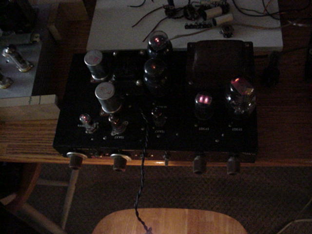

lately all i have been geting off ebay is bogen. just looked over my tubs i have all in need to test it before i rebuild it. if the iron is good i will be surprized😀 its the only thing that looks like it has seen some heat than rusted over
Hi karma,
Don't forget these were PA amps. Many ran 24 / 7 for years. The transformers run warm, but are usually okay.
I've heard worse music amps - some new design.
-Chris

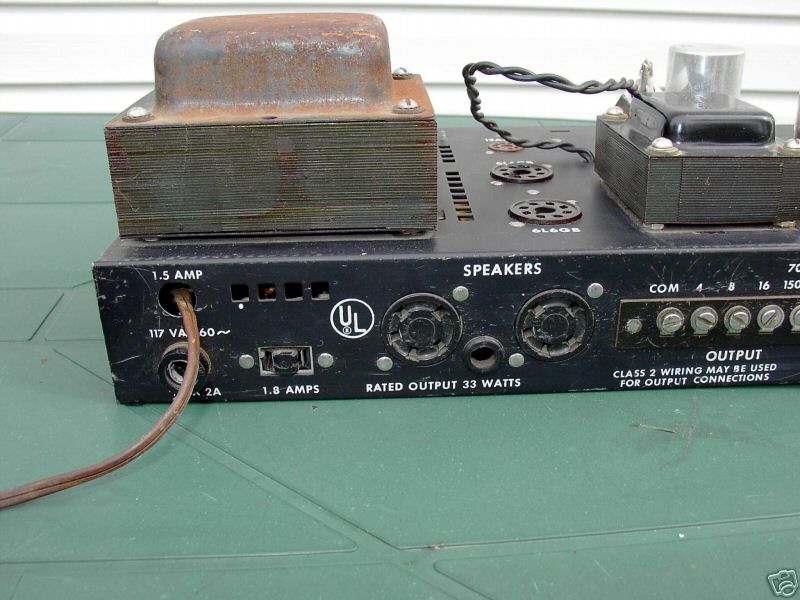

I hope you're treating this amplifier as a learning process because that's a tiny output transformer (big is better)...
ya i have yet to get it. but it is a little small by looking at the pic

sounds good lots of base even with such a small output tranny.

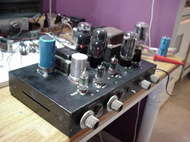

pics

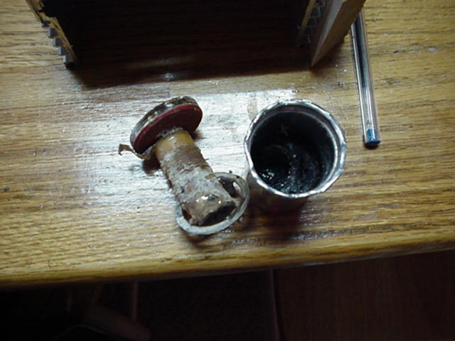

sure thing a problem came up with one of the caps it was shorting out in the inside. made poping sound than blew the fuze.
replace it. its been work for hours now no problems.
weird thing when i took the cap apart to see what it was doing
the parts in side are smaller than the case talk about cheap🙁
