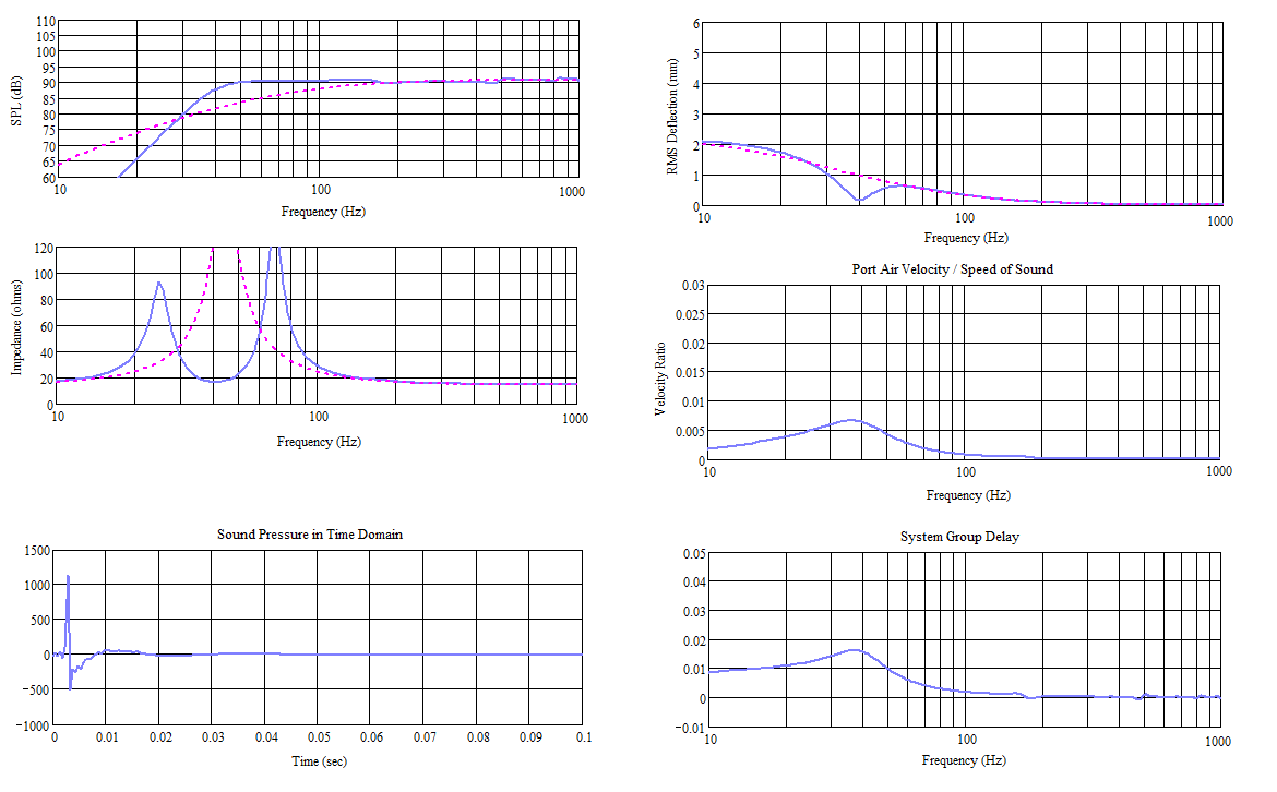

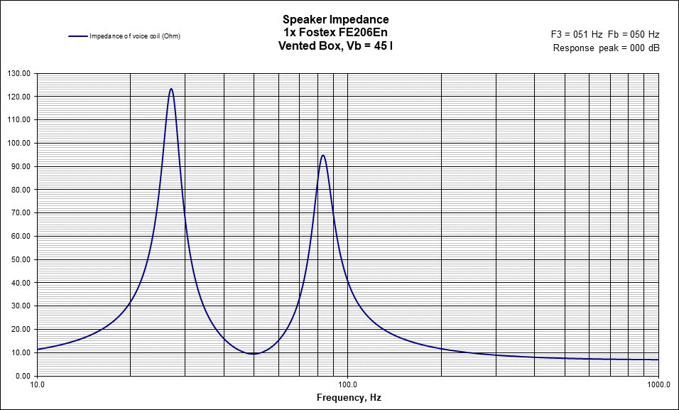

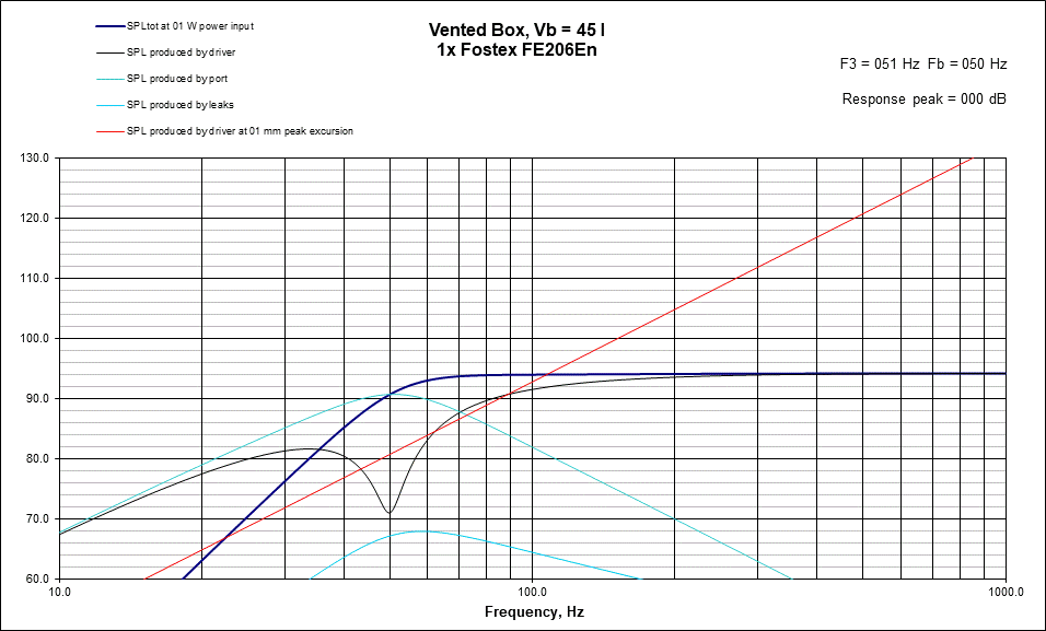

OK, I'll bite as I've a spare minute. Assuming you're running a voltage-source amplifier, you can force it to work; with about 6.8ohm series resistance, max-flat is about 45 litres, Fb of 50Hz, assuming . With a 50mm diameter vent, that's an Lv of about 25mm assuming a cylindrical duct and the box lagged on opposing faces (top, back, one sidewall), 25mm bonded acoustic fibreglass board or a near equivalent (not acoustic foam). You can drop Fb to about 46Hz for a slightly better damped alignment by increasing duct length to 34mm.
For the sake of convenience, you can use the vented box Fostex show on their FE206En (and FE206E) data-sheet; just adjust the vent dimensions and add the damping & series R. Make sure it's a decent power-resistor rated to 50w or parallel, say, 4x 27ohm 10w rated resistors and place in series with the driver, in either the + or - lead; this is AC so it makes no difference. Job-jibbed.

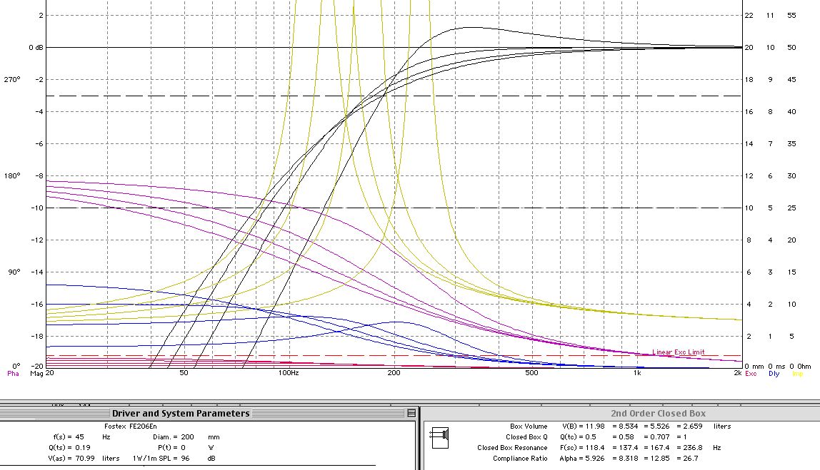

But sealed to a woofr probably makes more sense.
https://frugal-horn.com/downloads/centre/FE206En-sealed.pdf
The vented box does not go much lower ultimately but will have more kick in the upper bass.
Both would XO to the woofers at 110-130 Hz.
