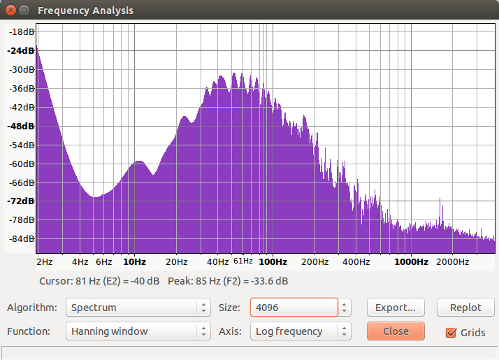

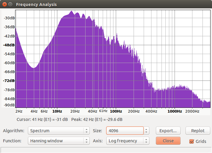

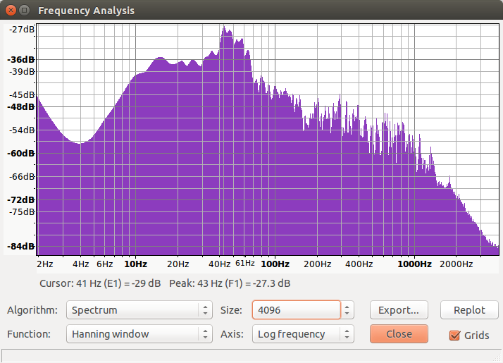

I did find some earthquake sound files on the USGS site. Not Hawaii, but it's something.
Seems most of the rumble is around 40-50Hz. Or like an open E or open A string on a bass.
Of course there is plenty of infrasonic energy, but the main audible parts of the files I got was in the bass E,F,G,A range. Rumble, without many audible harmonics.

We posted at the same time. Them's some pretty interesting graphs. The 2001 quake here was like a every subwoofer on the block turned up to clipping, and around 40 hz, like your graphs show. Pretty impressive and no other noises like falling buildings to interfere. Is that what you got?

I got data form the USGS. It's sampled at 30Hz, which is really too low for my needs, but I'm giving it a try anyway.
"one of these things is not like the other..."
How does one represent 40 to 50 hz signals using a 30 hz sampling rate?
John
Completely different data and file formats. I should have explained it better, sorry. The files I analyzed are in .wav format with a 8k sample rate. They are from some quakes on the mainland. The files I got from the local monitoring station are in a text table form, time and amplitude, 30 times per second. Good to see the shakes, not good to analyze sound.I did find some earthquake sound files on the USGS site. Not Hawaii, but it's something.
