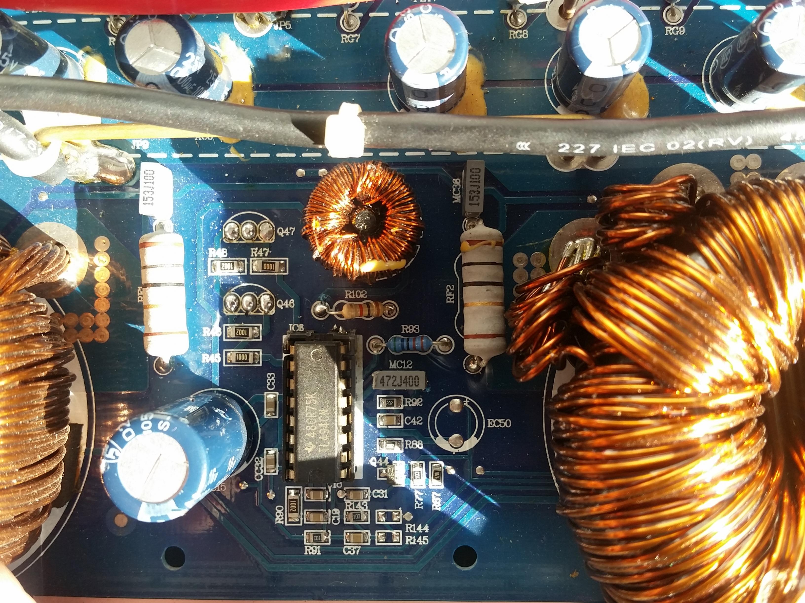

is it possible that these amps have problems with the power supply driver transformer?
amp came in with a dead power supply, found the 494 wasn't oscillating, replaced the 494 and when turned on it killed the remote turn on transistor. replaced the transistor, removed the 2 driver transitors, the 494 oscillates normally.
refit 2 driver transistors and it heats the remote turn on transistor very quickly and 494 does not oscillate.
When i fit the 2 driver transitors the remote turn on transitor gets extremely hot, the 494 was dead when the amp came in. I replaced the 494, the remote turn on transistor and the 2 drivers were both fine, but now when i turn the amp on the remote turn on transistor heats up rapidly, if i remove the 2 driver transistors the remote turn on transistor stays cool and the 494 osscillates as normal
I would suggest pulling the transformer and reestablishing the connections on the 494 side with wires. For the secondary windings, connect the two pads for each winding with a resistor or jumper. This will ensure that the FET gates won't float and cause the PS FETs to conduct. Do you still have excessive heating of the remote transistor?
