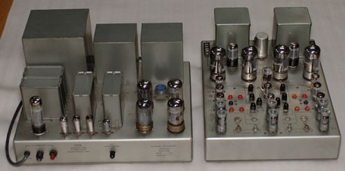

Yes, I am looking for the schematic for the all-tube Dual 100, which is entirely different from the later amplifiers. A photo is included below.
Unfortunately, I believe all the manuals on ebay are for the solid state 100-watt amplifier.

Most Audio Research power amps are considerably more complicated than other manufacturers products. Their Cross-Coupled inverters add a lot of tubes,and their willingness to regulate almost every voltage in the unit really bumps thing up in term of complexity. This is one of their earliest models, with all-tube regulation for each channel,and that adds a LOT of extra tubes. And heat!

I should have said above that at least the power supply is very different from later models.
I would love to know what all those tubes are doing.
I think that the 6CA7/EL34 and related smaller tubes regulate the screen voltage of the output tubes.
In their later models, a 6550 tube does that using Zener diodes, instead of the small regulator
tubes in the Dual 100.

The amplifier section is pretty much the same as the D75. The power supply is all-tube,
including the rectifiers and the screen regulator tubes.
