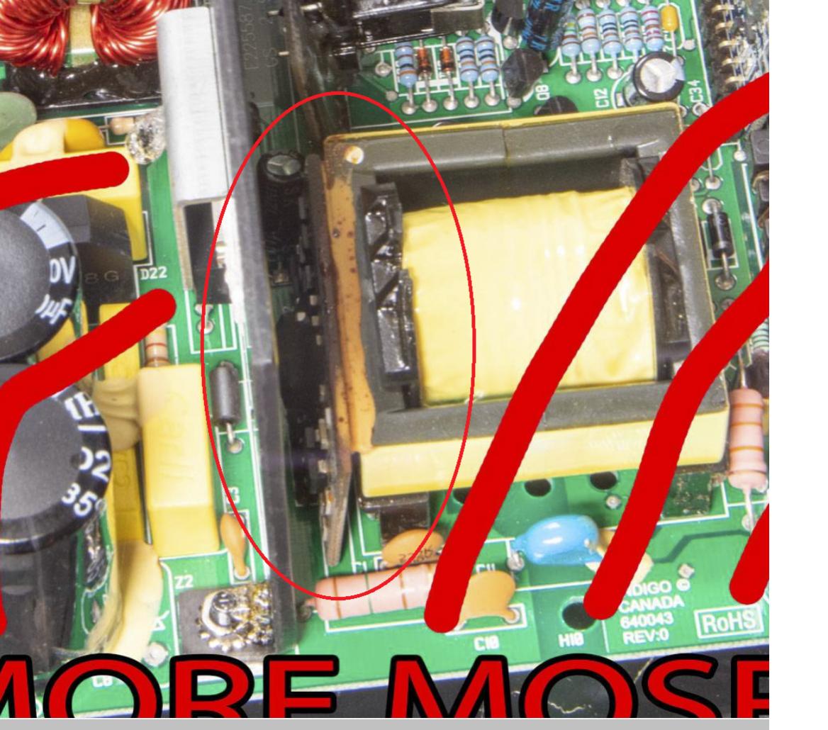

When you say "primary side MOSFET" there appear to be many. Some are on the power side board and some are on the amplifier side. I've checked the 6 on the power side but they aren't working as expected, when checking the source and drain of each MOSFET there's a brief build of current before OL is displayed, powering the gate doesn't seem to have any effect. Should I remove each MOSFET from the board before checking?
I would disconnect the amp board from the power supply board before any further attempts at powering up just in case...
Look at the heatsink to the left of the transformer with one or two MOSFETs bolted on it, those are the primary side MOSFETs. Can be confirmed via checking if it leads to the transformer primary.
Removing them should cut all power to the transformer and secondary. Then you can apply power again and check for blown fuses. If fuse stops blowing, check that MOSFET out of circuit.
I would first pay attention to the crispy fried area circled.
And definitely do this.

Regarding the crispy fried area, I was a bit suspicious, however it appears as though the paste used has started corroding and turning brown. There are a few other areas with this same appearance:

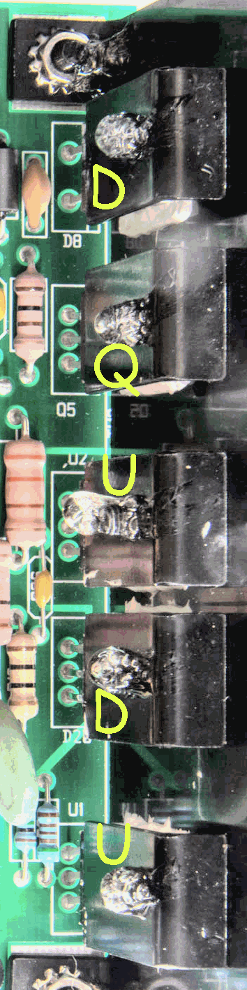

..."primary side MOSFET" there appear to be many. Some are on the power side board and some are on the amplifier side. https://i.imgur.com/5MTOld1.jpg
Some of those "amplifier side" parts look like a "D" not a "Q". Dual-diodes come in the same package.
You mean the one that appears to be slightly bloated? Probably.
Do you mean the top pushing up slightly?
