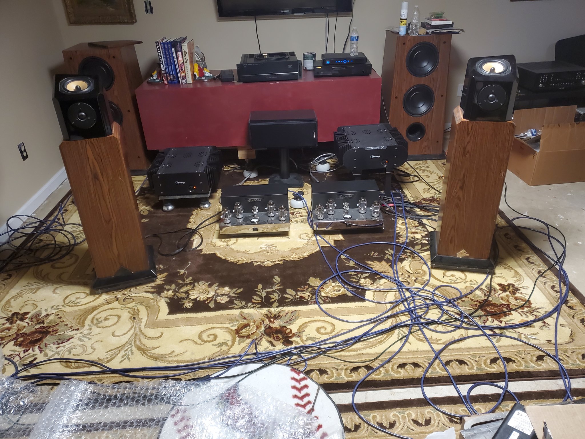

You are looking at a private 4 box system. The 2 Quicksilver V4's are for the satellites and the 2 Sonogy amps are for the red subwoofer and for the 2 rear bass boxes. The system was called the Sforzando-JL1's. The rear boxes weigh 175 lbs and are braced with 1 1/2" of MDF on all 6 sides.
